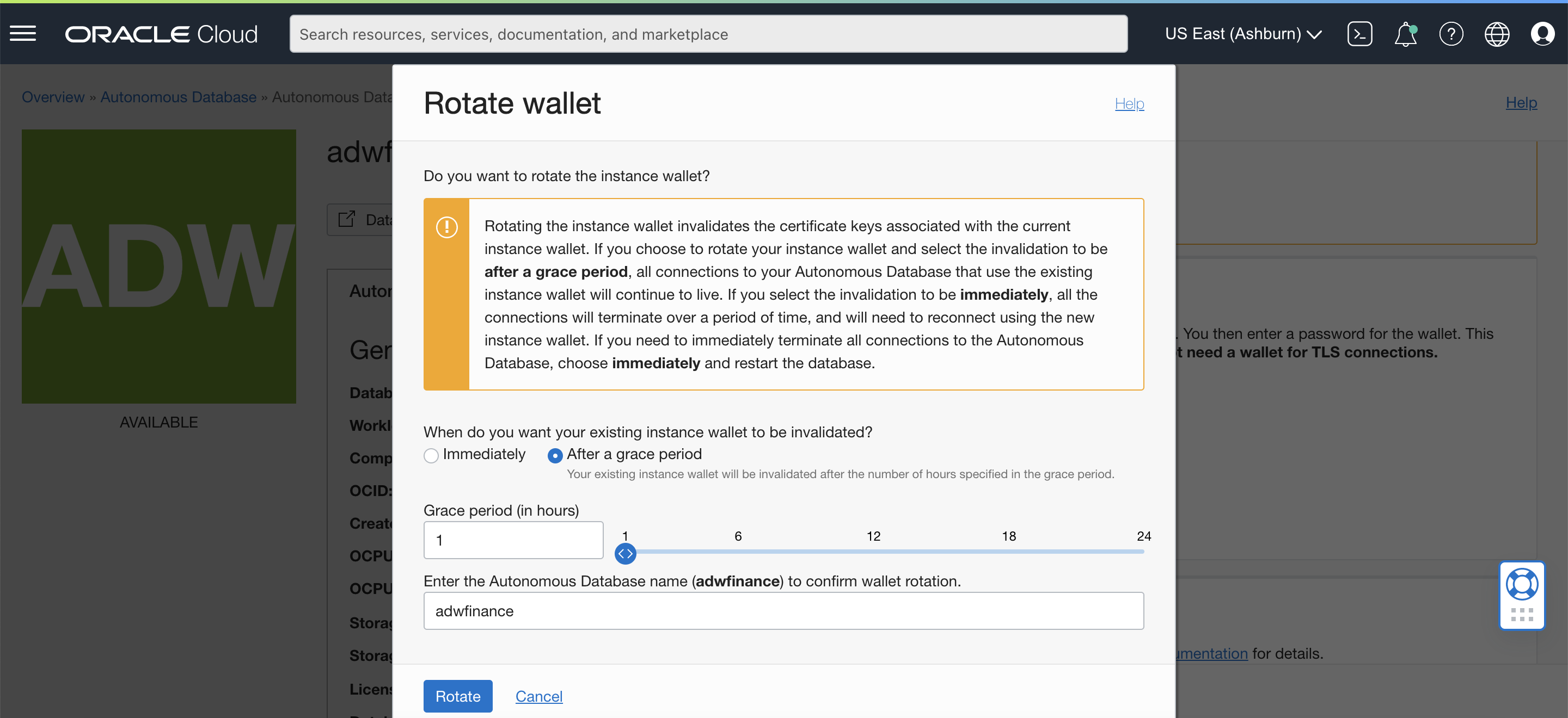

For my ADB instance, adwfinance, I have already downloaded the instance wallet and named it Wallet_adwfinance_old.zip (I added the ‘old’ as a postfix since I’ll be rotating it shortly). To rotate my wallet (which will be named Wallet_adwfinance_new.zip), I go to DB Connection under ADB details page and hit ‘Rotate Wallet’ button, which takes me to the following pop-up:
rotate wallet
As we discussed earlier, there are two options to rotate a wallet. If you want your existing wallet to be invalidated immediately, you choose ‘Immediately’. If you want your existing wallet to be still valid for up to 24 hours after the rotation, you choose ‘After a grace period’ option and specify the grace period. For this demonstration, I have chosen to rotate my wallet with a 1-hour grace period. Then, I downloaded the new wallet.
