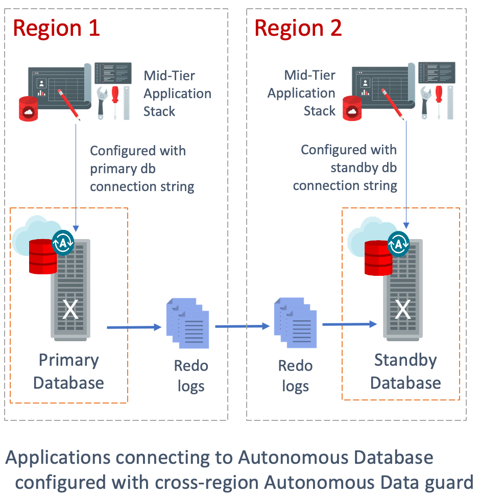

In this cross-region DR setup, just as your primary and standby databases lie in different regions, we recommend that you have a primary and secondary mid-tier running in or near the same regions as your databases. This way, when you intend to failover during a disaster, you will failover your entire stack (database and mid-tier) to the remote region.

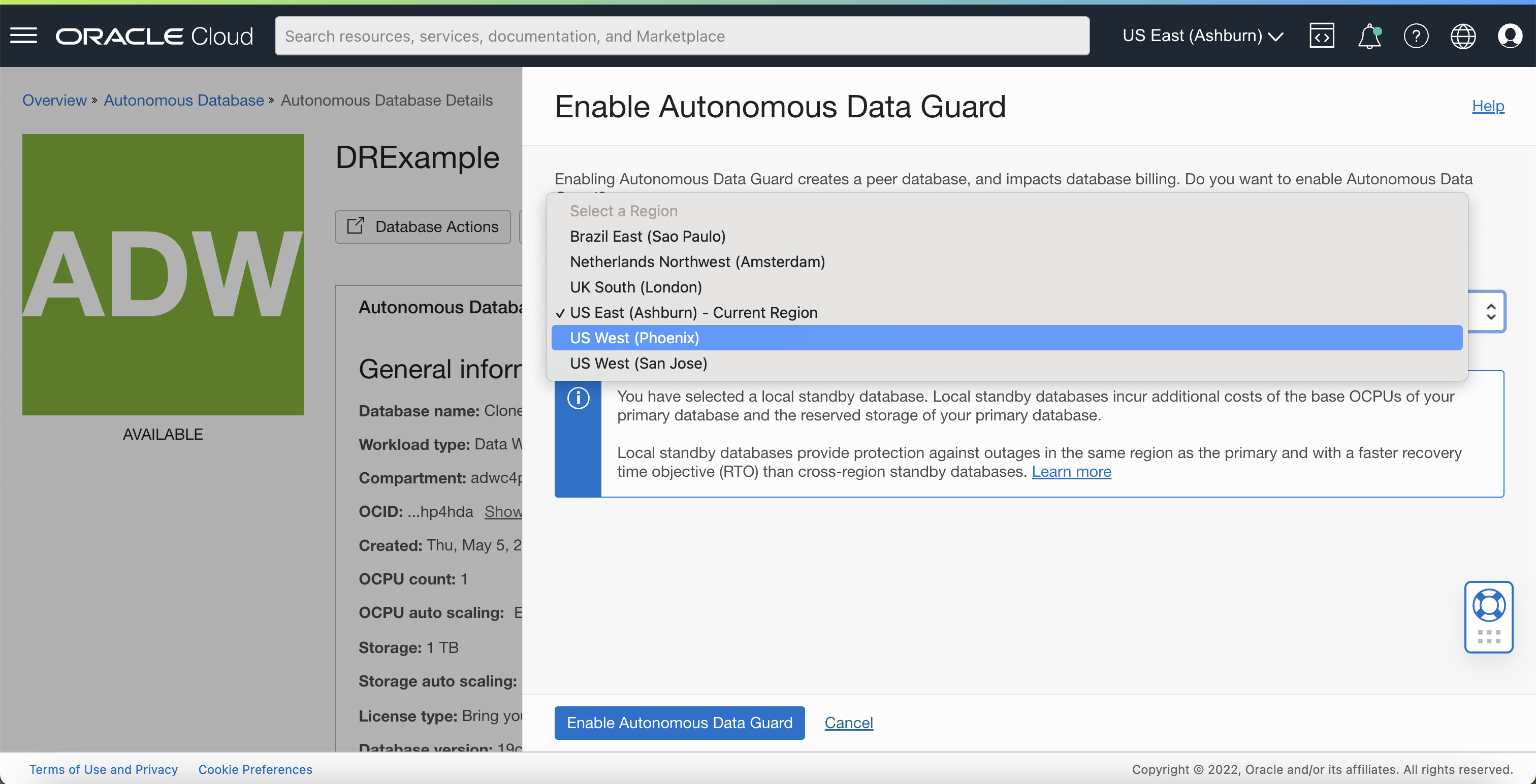

If you haven’t already, go to your database console and click “Enable” within the Autonomous Data Guard section. Select a remote region (ie. not the current region you are in). If your database uses access control lists (ACLs) or private endpoints, configure those here for your ADG Standby database too.
In this example, our Primary database is in the US East (Ashburn) region, and the Standby is in US West (Phoenix) region.
Enable ADG

As mentioned above, a good disaster recovery architecture involves placing your primary and secondary mid-tiers in the same or nearby regions as your primary and standby databases.
Cross-Region DR Mid-Tier Configuration

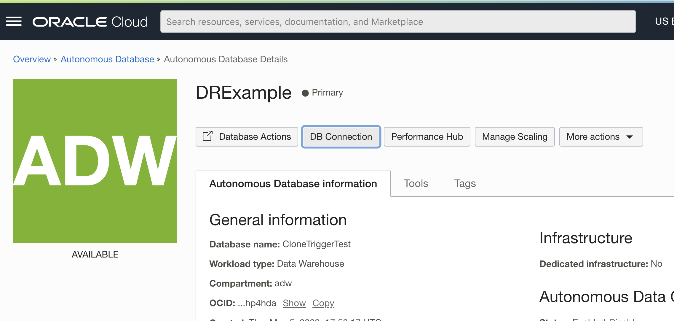

Once you have set up your mid-tier in each region, continuing with our Ashburn – Phoenix example, navigate to your Primary (Ashburn) database and click “DB Connection”.
DB Connection Button on database console

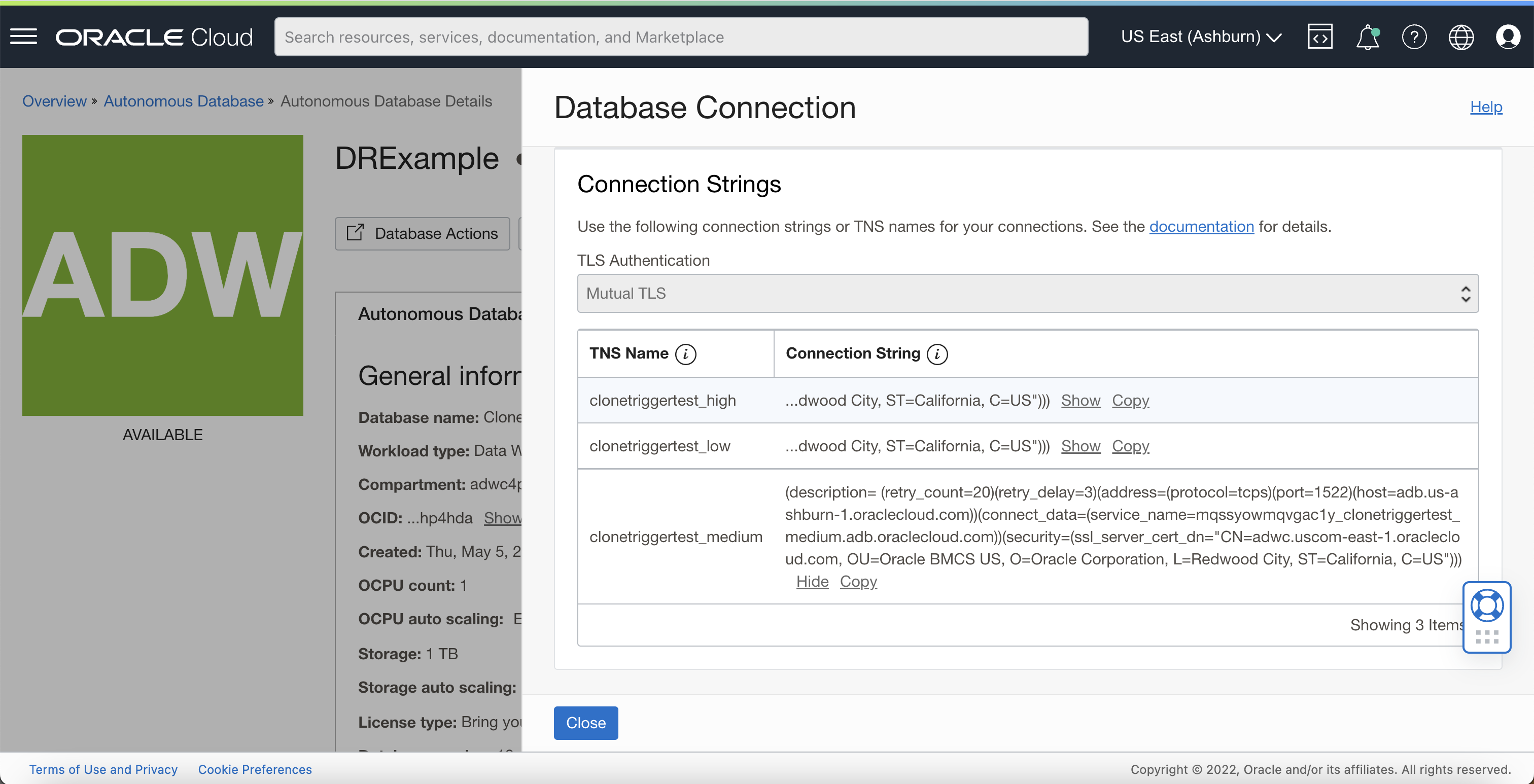

Under DB Connection, you can scroll down to find your connection string to use to connect to the database without a wallet or you may download the wallet to connect to the Primary database. Note that the connection string for the Primary database contains only the Primary database’s hostname. Configure your application lying in the primary region to use this wallet or connection string to connect to the Primary database.
Connection string

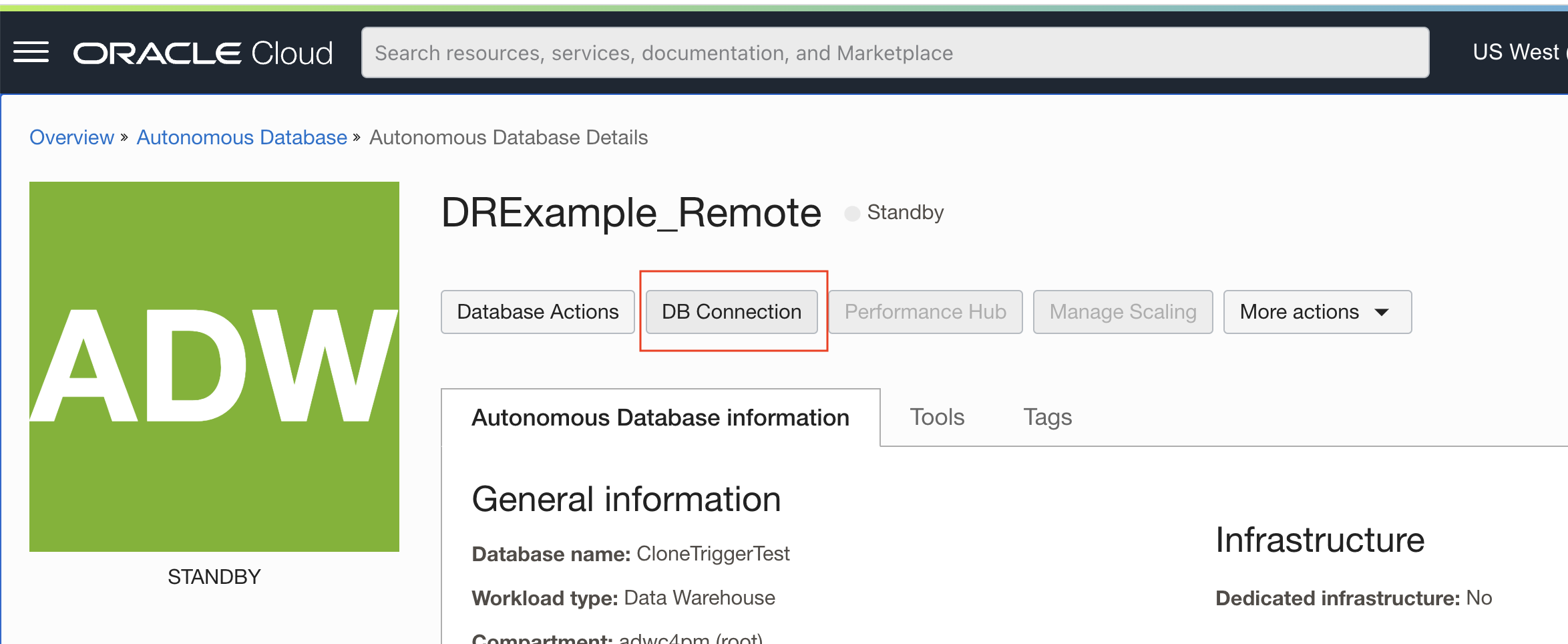

You will now perform a similar step to Step 2 on the remote (ie. secondary) region. Navigate to the remote Standby database and click DB Connection. Once again, scroll down to copy the connection string or download the wallet for your Standby database, which will contain the Standby database’s hostname.
Configure your remote mid-tier application with this Standby’s connection string or wallet.
DB Connection Button on standby database console
