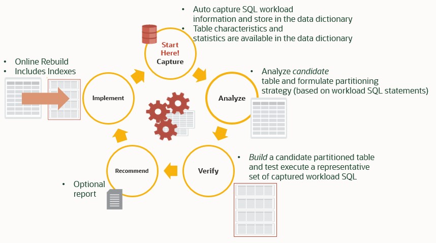

Here’s a summary of the process. Start at the top and follow the flow clockwise. It outlines how Auto Partitioning works and illustrates how the database does all the work for you:
Automatic Partitioning - Workflow
Here’s some more detail:
Capture: A background task captures workload SQL and stores it in the automatic SQL tuning set. You don’t have to worry about understanding your workload in theory. The database collects it automatically for you and tracks what work is done on your system.
Analyze: After we have a workload, what are we supposed to do with it, and what tables shall I look at? Don’t worry. The smarts to analyze candidate tables and to come up with an optimal partitioning scheme are taken care of. That is the database’s job and is performed inside the PL/SQL dbms_auto_partition.recommend_partition_method function. That’s a purely theoretical exercise inside the database using the information about your workload, your largest tables, and your data distribution.
Verify: After the database thinks to know what makes your application faster, it actually wants to know it for sure: Oracle will take a selection of workload queries and test-execute them against a hidden, partitioned copy of your candidate table(s), putting its findings to the test. We take this very seriously since we are dealing with your most precious assets – your tables. Yes, it takes time and resources, but afterward, you will know what performance you can expect from Auto Partitioning. Again, the function dbms_auto_partition.recommend_partition_method takes care of this (you can specify a time limit if you like).
Recommend: After the verification, the database knows precisely what Auto Partitioning will do to your application. Based on its real-world findings, it will recommend applying Auto Partitioning to some of your tables – or not. If you want to see a report, you can use dbms_auto_partition.report_last_activity.
Implement: Assuming that Auto Partitioning identifies optimal partitioning strategies for some of your tables, it’s time to modify your nonpartitioned tables to adopt the identified partitioning strategy. Your tables are partitioned on-line using dbms_auto_partition.apply_recommendation.
