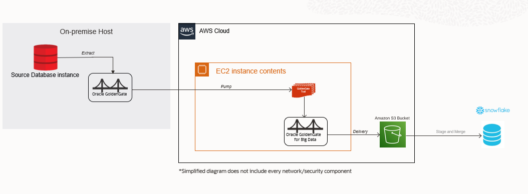

Architecture & Components:
  • GoldenGate 19.1 (Source Database can be any of the GoldenGate supported databases)
  • GoldenGate for Oracle 19.1
  • GoldenGate For Big Data  19.1
  • AWS EC2 Instance
  • AWS S3 Bucket
  • Snowflake Cloud data warehouse
Replication Flow:
Source Database ——–>GoldenGate Extract ——–> GoldenGate Trail ——–> GoldenGate Pump ——–> GoldenGate for Big Data Replicat ——–> Amazon S3 Bucket ——-> Snowflake
GoldenGate for Big Data snowflake Replicat configuration consists of File Writer (with Avro Formatter) -> S3 Event handler -> Command Event handler.

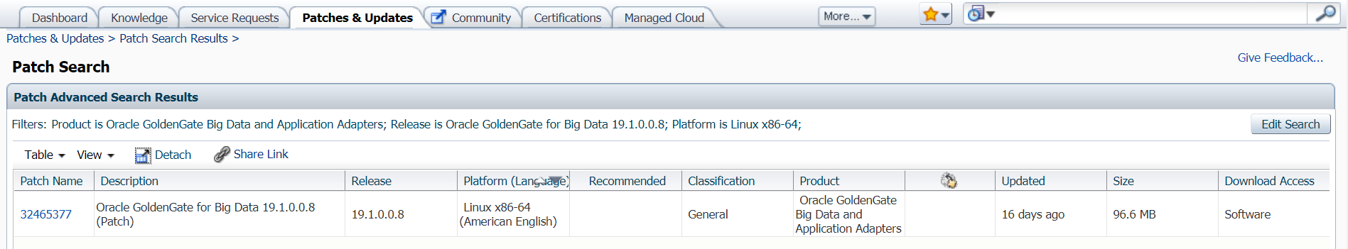

1. Download GoldenGate for Big Data 19.1.0.0.8
You may download the patch from My Oracle Support (MOS), https://support.oracle.com/epmos/faces/PatchHome by searching for patch number 32465377
Note:  Once you install GoldenGate for Big Data 19.1.0.0.8, the installation contains a sub-directory ” ../AdapterExamples/big-data/data-warehouse-utils/snowflake/ ” which contains all the configuration and scripts needed for snowflake replication using stage and merge. For additional details, refer to product documentation:
https://docs.oracle.com/en/middleware/goldengate/big-data/19.1/gadbd/stage-and-merge-data-warehouse-replication.html#GUID-9545DB70-B80F-4041-B7B1-5257A957939C

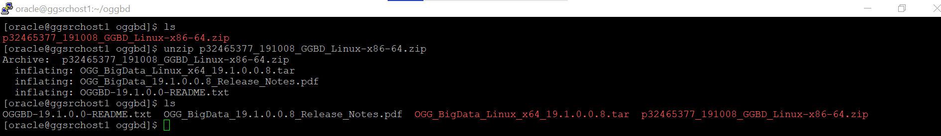

1. Download and transfer the GoldenGate for Big data 19.1 zip file to the AWS EC2 instance.
2. Unzip the downloaded GoldenGate for Big Data zip file:

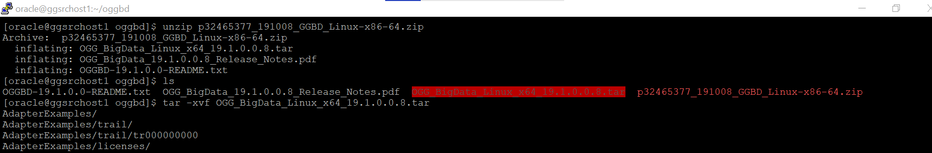

3. Now extract the GoldenGate 19.1.tar file using “tar -xvf” command.

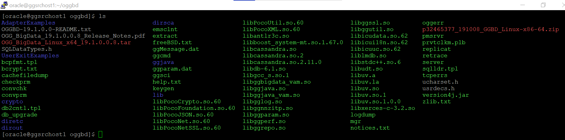

4. After the “tar –xvf” operation finishes, the entire GoldenGate directory structure looks like this:

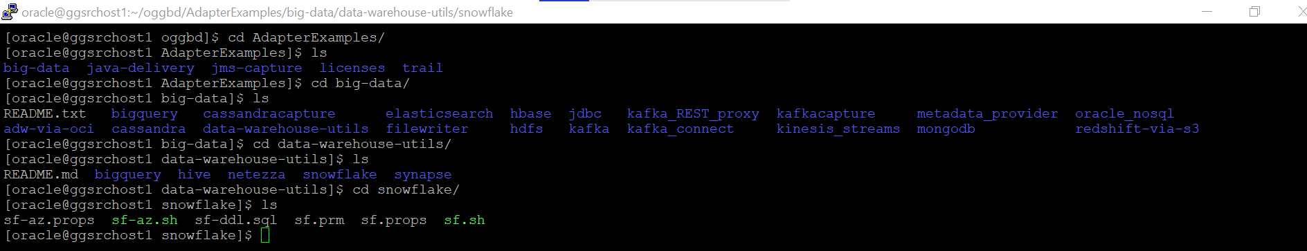

5. You can have a look at the directory structure( files extracted) and then you can traverse to the “AdapterExamples” directory:
6. The sample configuration files for snowflake are not available within AdapterExamples like the other Big Data targets until GoldenGate for Big Data 19.1.0.0.8.
Instead, you can download and copy the GoldenGate-snowflake Replicat artifacts from GoldenGate for Big Data 19.1.0.0.8 to your current environment.
NOTE: The directory AdapterExamples/big-data/data-warehouse-utils/snowflake/ in the Oracle GoldenGate Big Data 19.1.0.0.8 install contains all the configuration files and scripts needed for snowflake replication using stage and merge.

11. Copy these three files (sf.props,  sf.prm and  sf.sh) from AdapterExamples/big-data/data-warehouse-utils/snowflake/ directory to ./dirprm directory within the GoldenGate for Big Data home.
12. In sf.prm file, edit the MAP statement to include the required schema name and table Name.

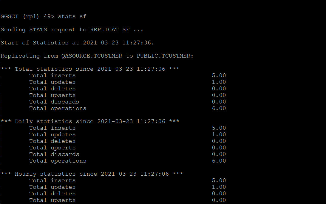

  REPLICAT sf
  TARGETDB LIBFILE libggjava.so SET property=dirprm/sf.props
REPORTCOUNT EVERY 1 MINUTES, RATE
  GROUPTRANSOPS 1000
  MAP “QASOURCE”.”TCUSTMER”, TARGET “PUBLIC”.”TCUSTMER”;
Note: Here TCUSTMER table is used as an example here.

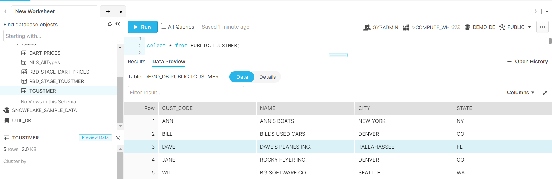

e. #TODO Login into your snowflake account and create the target table on Snowflake manually
CREATE TABLE PUBLIC.TCUSTMER(
cust_code VARCHAR2(4),
name VARCHAR2(30),
city VARCHAR2(20),
state CHAR(2));

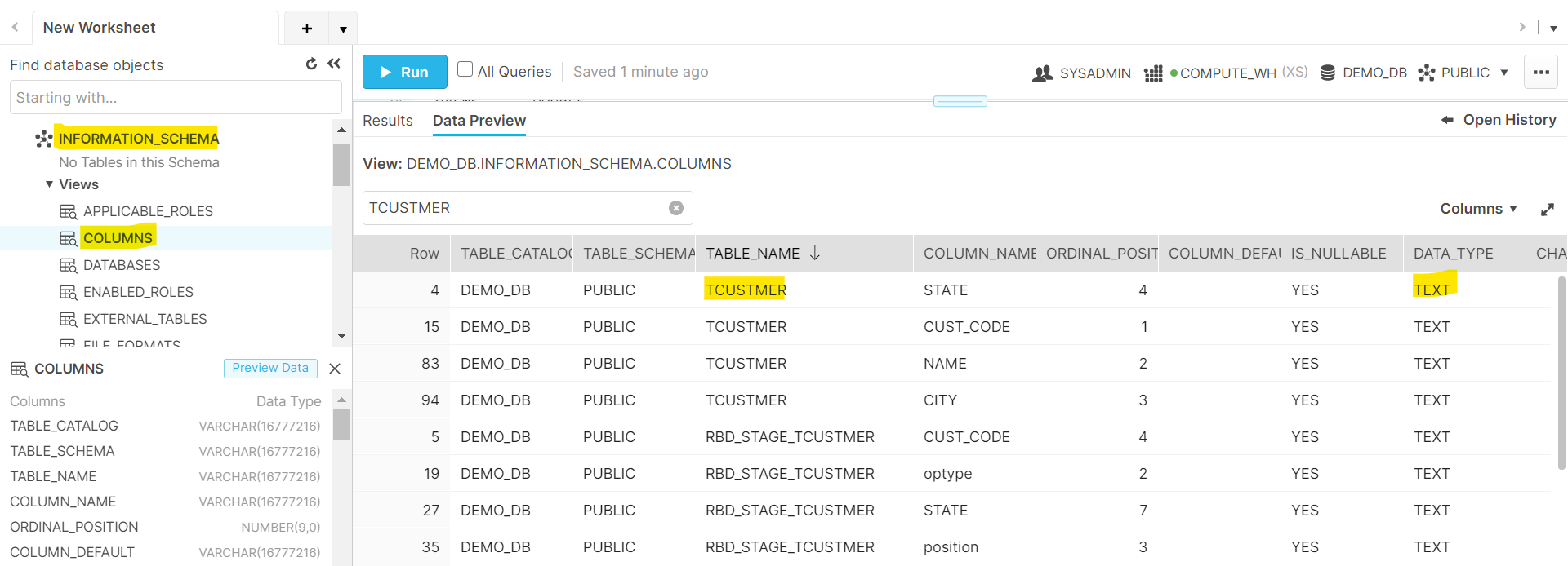

f. #TODO  Edit the create Staging Table SQL in the below section of the script
  • Edit the column data types of the staging table to match the target table created in previous step. Collect the metadata for all the columns by querying the Snowflake information schema.
  • Edit all the column names of the staging table to match the column names in target table.
  • The create external table SQL example here is configured for the example table TCUSTMER defined in sf-ddl.sql file.

19. Execute the stats command to check the stats on the Replicat.
20. As you can see from the stats command output and within the SF.log,
Number of update operations merged into an existing insert operation: [1]
21. Now Check the rows in the target table on snowflake. So , GoldenGate for Big Data replicat has performed the merge operation for that one update operation i.e. merged the record from the staging table into the target table.
