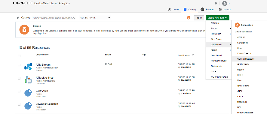

  • Click on the Catalog
  • Click on the Create new Item drop down
  • Select Generic Database from Connections menu
GGSA Catalog

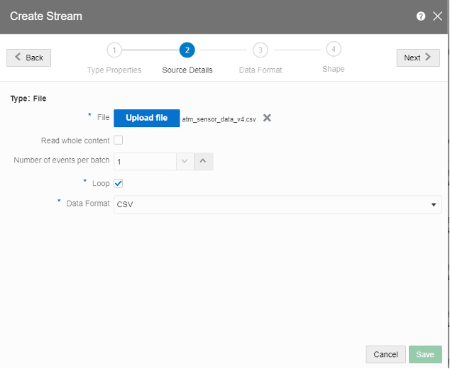

Next we will create a stream. We will run a csv file in loop for this article. The stream can be from a File, Goldengate, JMS or Kafka. We do not need to make a connection for running a file in loop.
  • Select File from Stream menu
  • Create Stream has four sections
    • Enter the name of the stream and select stream type as file in Type properties section
    • In the Source Details section, upload the csv file and select the data format as CSV. It can take CSV and JSON as the formats.

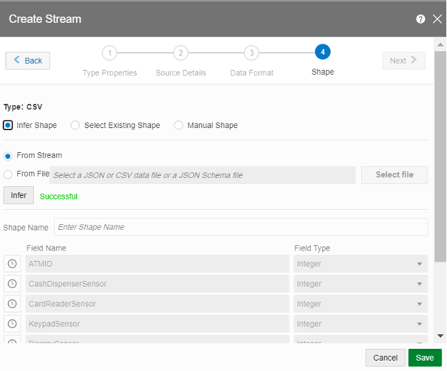

    • Let the Data Format be default and check the box for First Row as Header
    • In the Shape section, click on the Infer Shape and From Stream. It will display the columns in the CSV file.
Create Stream
  • In the Shape section, click on the Infer shape and From Stream. It will display the columns in the CSV file.
Shape Selection

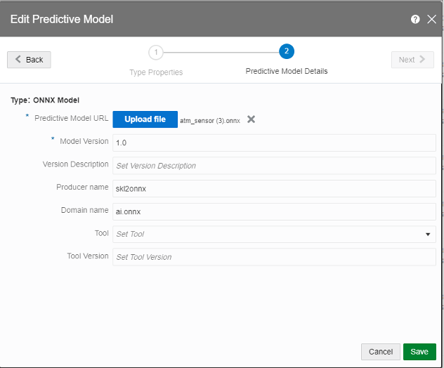

Before creating the pipeline, we need a machine learning model to predict whether any part of the ATM is about to go bad. The predictive model will score the data from each of the sensors installed in the ATM. The model can be created in OCI Data Science services and saved as ONNX format. The model will be uploaded in pipeline later. OSA can accept models in PMML or ONNX format. Save the model in your local drive or any other location to upload it in OSA.
  • To upload the model, Click on the Create new Item drop down
  • Click on the Predictive Model
    • In the Type Properties section, name the Model and select the Predictive Model Type as ONNX
    • In the Predictive Model Details section, upload the ONNX file and enter the version.
ONNX config

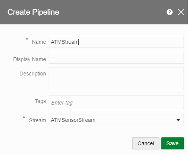

We can now start to develop the pipeline.
  • Click on the Pipeline
  • Name the Pipeline and select the Stream created above.
Create pipeline

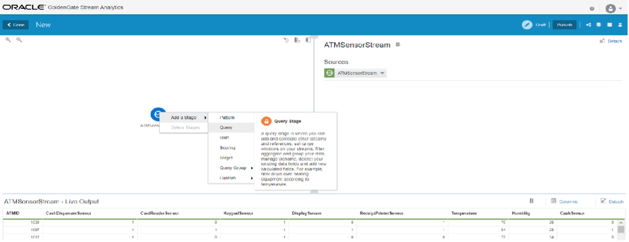

There will be three sections on the console, one where we will create the pipeline, second is where we see the properties for each of the stages in the pipeline and the one at the bottom shows the real time data in tabular form.
Right click on the stream and select Query Stage. We will join this with a reference machine data to get the machine details.
Pipeline

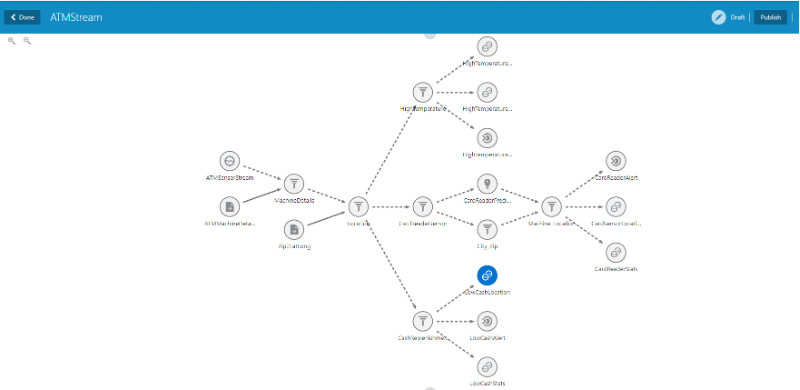

Once we have the machine details and the stream data merged in a stream, we will select a scoring stage and select the predictive model saved in the catalog. Next we will select Query Group and Stream.
Full pipeline

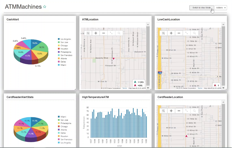

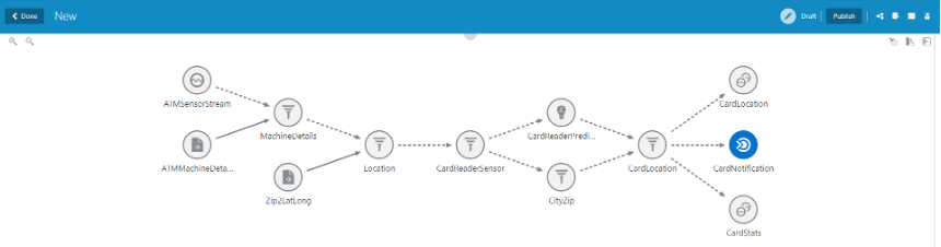

This is to create the visualization. The above diagram shows the full pipeline, it has more than one branch, but for simplicity, we are just going to create one branch for card reader sensor data. You can name the stream and then select the visualization. OSA provides variety of visualizations – pie chart, graphs, area under the curve and many more. We have latitude and longitude for each machine, so we plot it on the map as well besides selecting the pie chart.
One branch pipeline

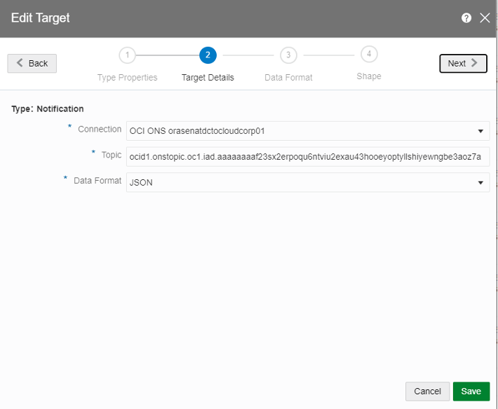

In the above pipeline, we create notification to alert the banker of machine about the malfunction. This can be done by selecting the target on the query stage. In the OCI notification service, we create topic and add the email of the relevant person. In the Target we add the connection (as created above) and the URL of the Topic.
Target
Once the pipeline is created, we want to see different charts in a dashboard. To create a dashboard, click on the Create New Item, select Dashboard. In the dashboard section, select the visualizations created above. The data will not be displayed on the dashboard till the pipeline is published. Publish the dashboard from the console, it will ask for the controller, executors and few more parameters. On selecting the parameters, it will take some time before the data starts showing on the dashboard.  Below is the screen shot of the dashboard showing the stats for Card reader and the temperature on the map and the graphs.
