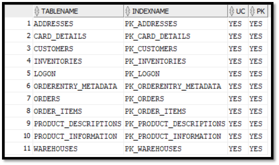

Query 2 : To retrieve Table Constraints for Source PostgreSQL Database
Image 3 : Query 2 Result
-- Query for Target Oracle Database
SELECT

Query 3 : To retrieve Table Constraints for Target Oracle Database
Image 4 : Query 3 Result

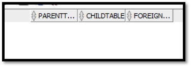

Query 5 : To retrieve Foreign Key Constraints for Target Oracle Database
Image 6 : Query 5 Result
In our case, the sample schema contains no foreign key constraints, which simplifies replication and avoids ordering conflicts.

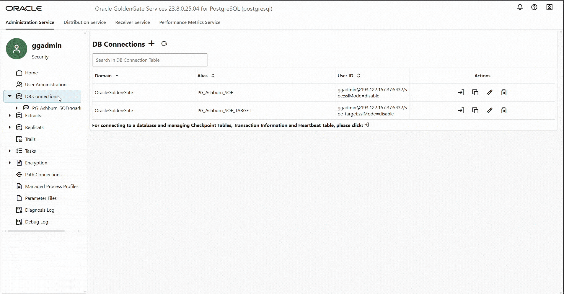

Source Side Instantiation Steps of GoldenGate for PostgreSQL
In this section, we’ll complete the required setup steps on the PostgreSQL source side of the GoldenGate replication pipeline.
Add Trandata
Once the source PostgreSQL connection is established, you must enable table-level supplemental logging. PostgreSQL provides this capability through the REPLICA IDENTITY setting, which controls what information is written to the Write-Ahead Log (WAL) during UPDATE and DELETE operations. GoldenGate relies on this logged data to identify and propagate changes downstream.

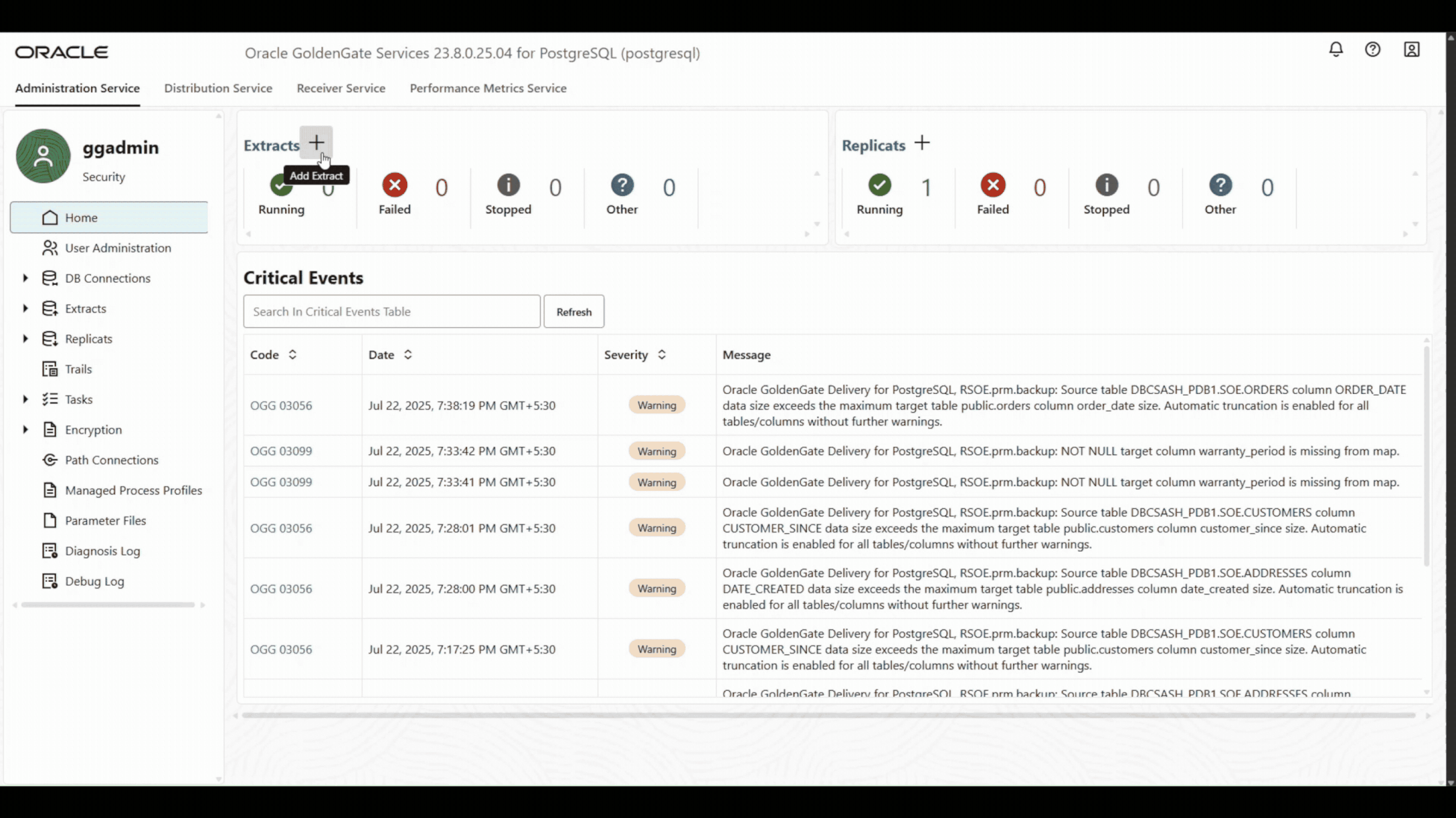

Start Primary CDC Extract.
Once the Initial load Extract is completed , you can now start the CDC Extract with the LSN tracked in Initial Load Extract report file.
Image 10 : Start CDC Extract

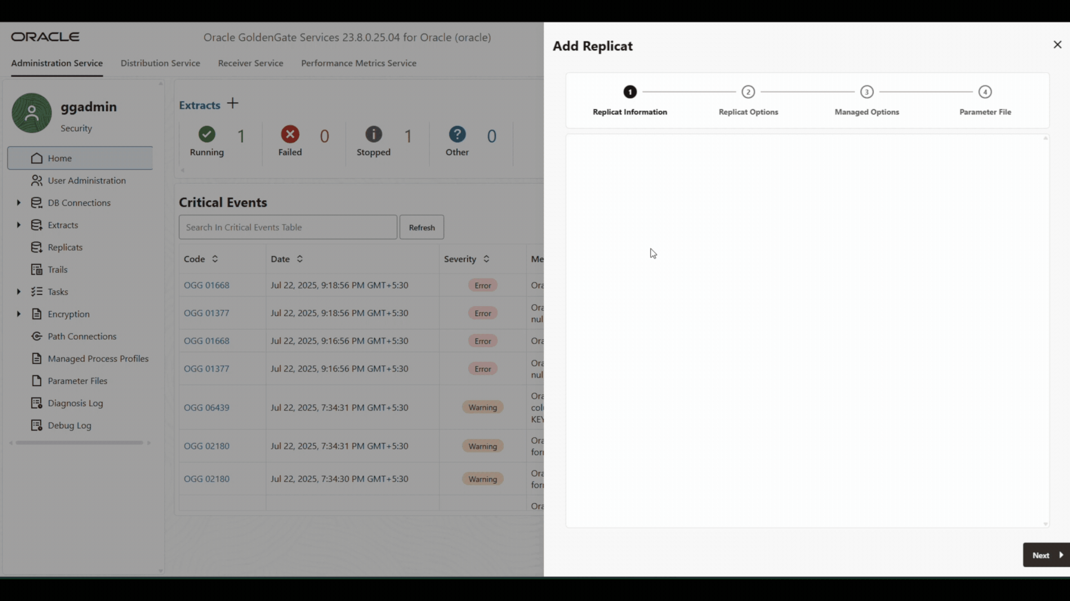

Image 11 : Initial Load Replicat
