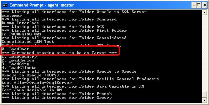

  • To see the output of the procedure, you will need a standalone agent: all the information is printed out to the console. I have no doubt that real developers will want to improve this and write out to something more convenient.

Sample result for the output in the agent console:
