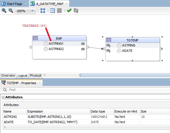

We can define the simple table to table mapping as below and define the expressions on the target table.

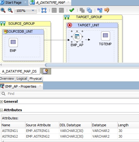

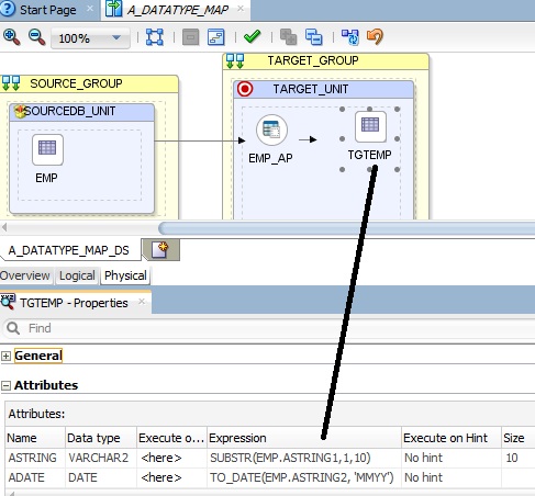

By default the expressions have no hint defined and will execute where the table is executed – in this case on the target system. We can see how the C$ table would be defined by previewing the DDL code in the physical design, we will see the type/DDL in the syntax of the particular technology. Below you can see the source datatype information is propagated – the length is still 30.

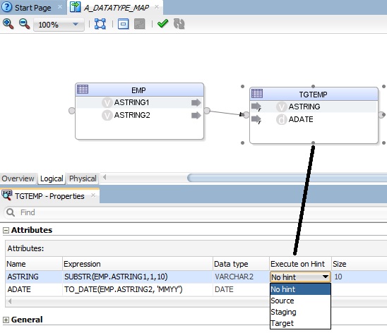

If we look at the target table we can see the expressions defined on it, in the example below I have selected the TGTEMP table and I can see the 2 expressions, I could actually change where the expression is defined for this particular physical design, I will not do that though, I will go back to the logical designer and set the hint there – then all of my potential physical designs leverage it.

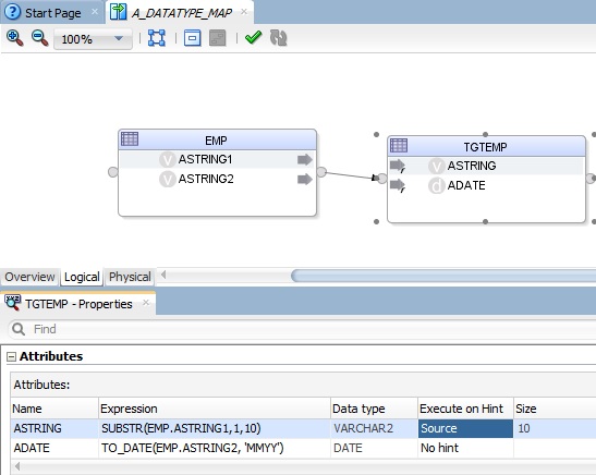

Use the ‘Execute on hint’ property for the attribute, you can see the different options there, just now it has value no hint.
Below I have selected ‘Source’ to indicate I want the SUBSTR expression executed on the source system.

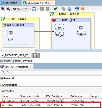

After this change has been made, if you look at the physical design you will see that the datatype information on our AP is now different. Because the data has been prepared on the source then the datatype for our C$ column now takes on the definition of the target (VARCHAR2(10)).

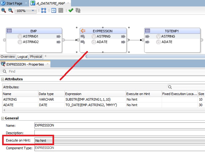

This gives you some idea as to how the hints works for expressions in a datastore. ODI 12c also has an expression component that let’s you define groups of expressions. I generally think this is good for when an expression is reused within a mapping, but I know everyone works differently with tools and I have heard that some people like using this for all complex expressions rather than it being defined within a component such as a target table as they can easily ‘see’ where complex expressions are defined. Each to their own, the good thing is that you can do whatever you like. One benefit with using the expression component is that ODI by default will push that expression component as close to the source as possible and you can easily grab the entire component and push it to the stage, target or wherever.

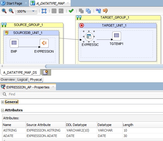

The mapping below defines the expressions on the expression component, again there are no hints defined on the component or individual expressions.
When the physical design for this mapping is inspected we can see the expression component is by default on the source execution unit. This goes for other components too (filter, join etc.). In this case you can see both of the columns in the AP take on the downstream target table’s datatypes (VARCHAR2(10) and DATE).

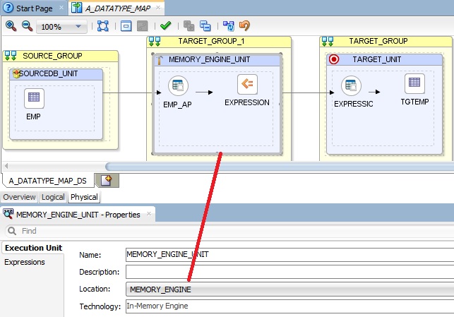

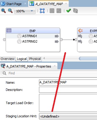

Changing the hint on the logical design for the expression component to stage will place the expression in the downstream execution unit. If I had just switched the hint to be stage for the expression component then in the physical design the expression would go in TARGET_UNIT_1. In 11g, ODI also supported a concept where the stage was different for the target. This is still available in 12c and is configured by defining what you want to execute in the stage by using these hints plus defining what the stage is (so similar to 11g apart from you don’t have to switch tabs and the gestures are more simple). So firstly, define the expression to execute on the stage using that hint. Then on the logical mapping if you click on the canvas background you will see a property named ‘Staging Location Hint’, you can set this to the logical schema location for the staging area if you have one. By default it is not set as the staging area is the same as the target.
Let’s change this to MEMORY_ENGINE just to see what the physical design looks like. We see we now have multiple execution units and the middle one where we executed the expression component is the ‘stage’ executing on the MEMORY_ENGINE location.
