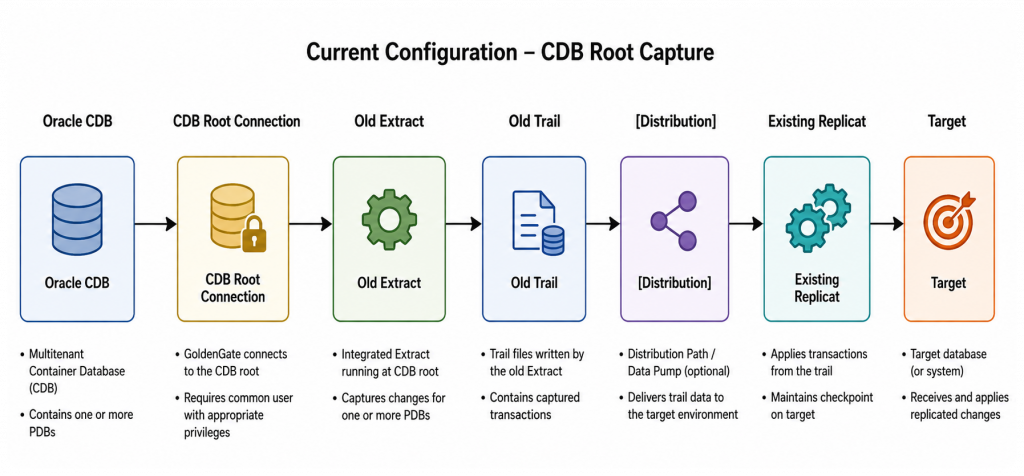

2. Existing and Target Configuration
Before Migration
The existing Extract connects to the CDB root and captures changes for one or more PDBs.
Conceptually:
Object references in the Extract configuration may use SOURCECATALOG or three-part object names.
For example:
TABLE PDB1.HR.EMPLOYEES;
TABLE PDB1.HR.DEPARTMENTS;

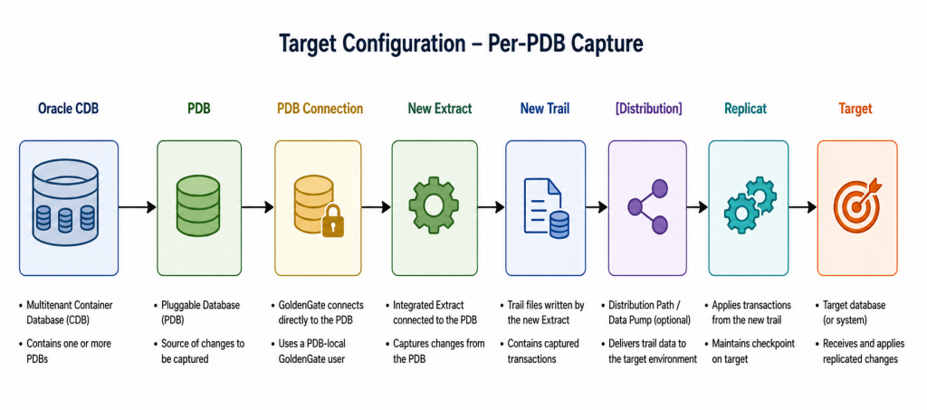

After Migration
The new Extract connects directly to the PDB using a PDB-local GoldenGate user.
Because the Extract is connected directly to the PDB, the PDB name is no longer required in captured object names.
For example:
TABLE HR.EMPLOYEES;
TABLE HR.DEPARTMENTS;

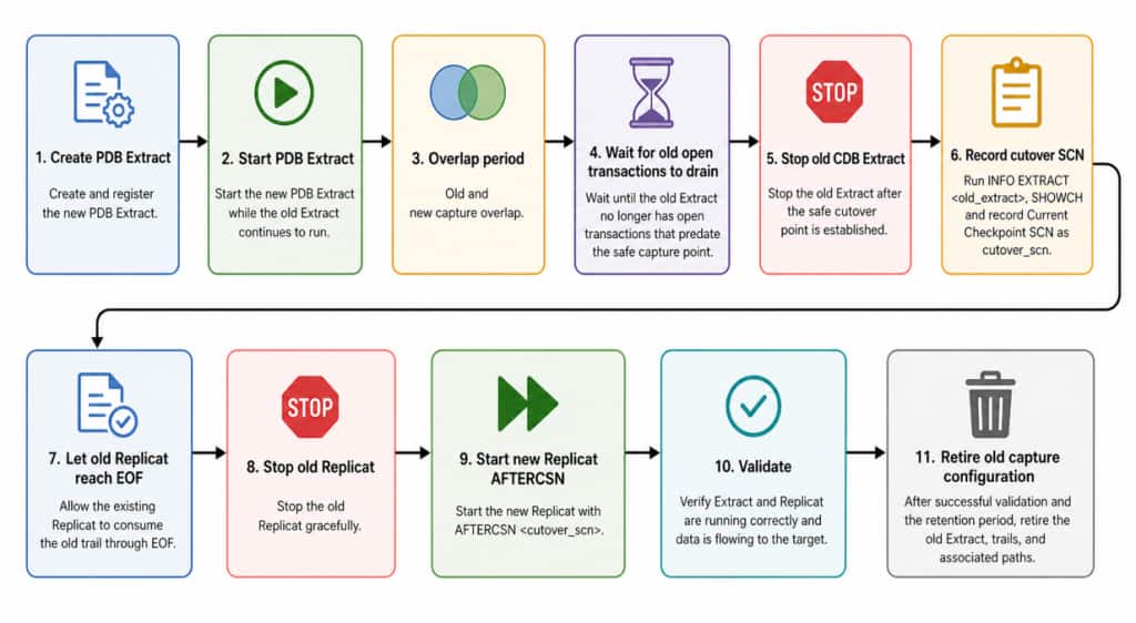

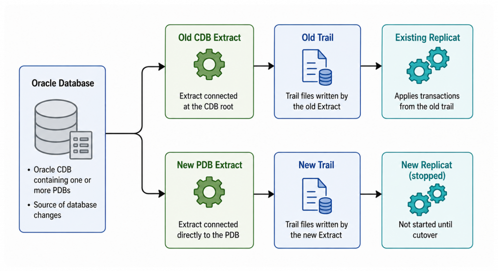

5. Create the Per-PDB Extract
Create a new Extract using the database connection for the PDB and BEGIN NOW as the starting point.
The new Extract must capture the same source objects currently being captured for that PDB by the old Extract.
Configure a new trail for this Extract. Do not reuse the trail written by the existing Extract.
For example:
Old stream:
CDB Extract -> Trail AA -> Replicat
New stream:
PDB Extract -> Trail BB -> New Replicat
Modify the Extract parameters for PDB-local naming.

6. Start the New PDB Extract
Create the new per-PDB Extract with its initial position set to Now (BEGIN NOW). This establishes the beginning of the overlap period while the existing CDB Extract continues capturing transactions.
In the Deployment Console, select Now as the Extract’s begin position. The equivalent Admin Client command is:
ADD EXTRACT <new_pdb_extract>, INTEGRATED TRANLOG, BEGIN NOW
Then start the new Extract:
START EXTRACT <new_pdb_extract>
Verify that the Extract is running, capturing transactions, and writing records to its trail.
Do not stop the existing CDB Extract or its Distribution Path at this stage. Both pipelines must continue operating until the safe cutover point has been established.
At this stage, both Extracts temporarily capture overlapping database activity:
The new trail must be allowed to accumulate captured transactions.
Do not start the new Replicat yet.
This overlap is intentional. It provides a window in which both capture configurations contain the transactions required to establish a safe cutover point.
7. Establish a Safe Cutover Point
The primary concern before cutover is transactions that were already open when the new PDB Extract was registered or started.
The new PDB Extract must be able to capture every transaction that will eventually be handed off to the new replication stream. A transaction that began before the new Extract’s capture point may not be available to the new Extract even if that transaction commits later.
After starting the new PDB Extract, allow the existing CDB Extract and existing Replicat to continue running.
Inspect transactions currently being tracked by the existing Extract:
SEND EXTRACT <old_extract>, SHOWTRANS
Identify transactions that began before the new PDB Extract’s effective capture point.
Wait for those transactions to commit or roll back and for the existing CDB Extract to process them.
Repeat as necessary:
Do not proceed with the final cutover until transactions that cannot safely be handled by the new PDB Extract have completed.
Long-running transactions may extend this waiting period considerably. If an application has unusually long-running transactions, coordinate with the application/database team before migration.

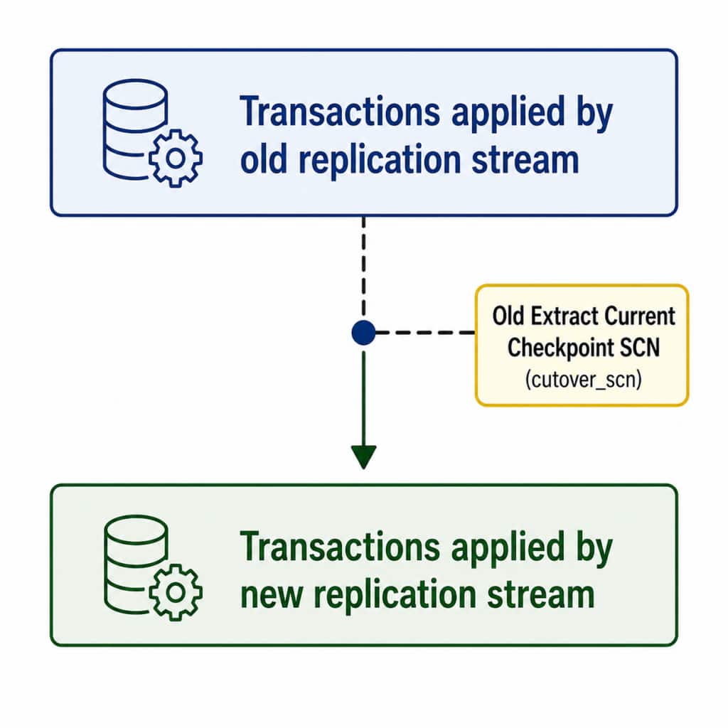

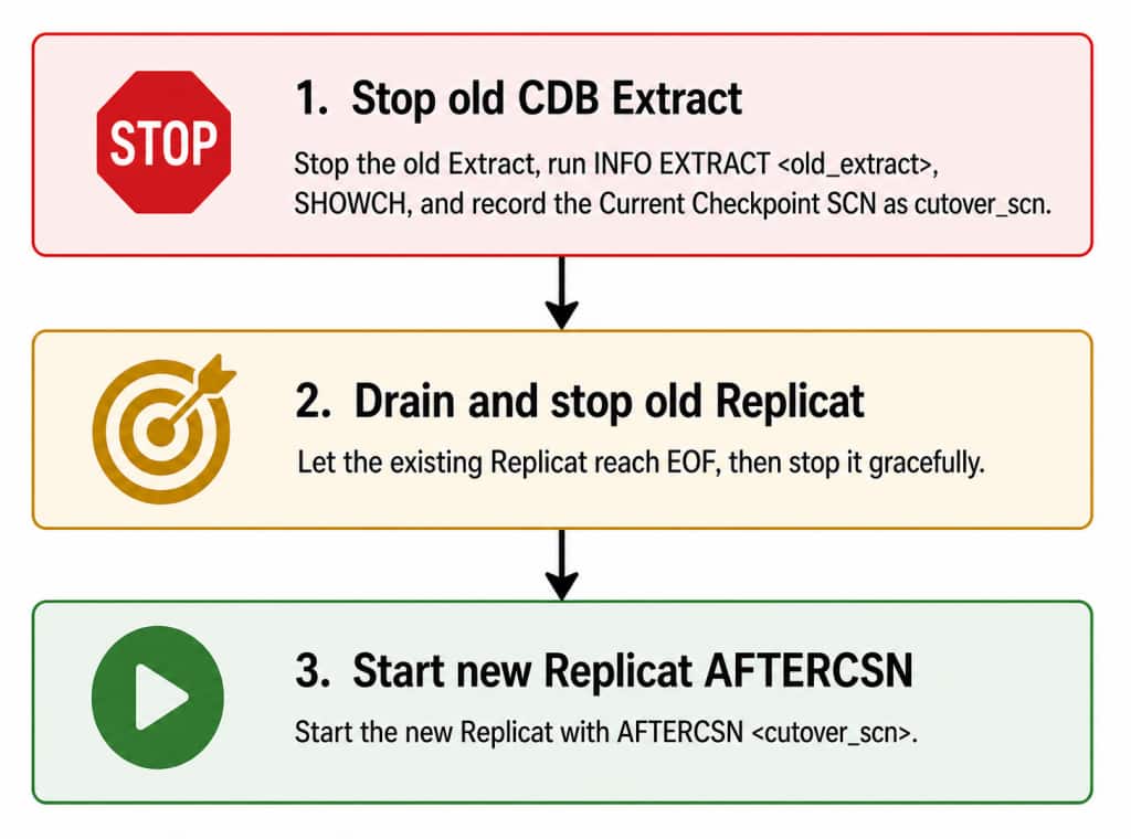

8. Stop the Old CDB Extract and Record the Cutover SCN
After the safe cutover point has been established in Section 7, stop the old CDB Extract. The new PDB Extract is already running and continues to capture the transactions for the new stream.
Stop the old CDB Extract:
STOP EXTRACT <old_extract>, FORCE
Then display the old Extract’s checkpoint information:
INFO EXTRACT <old_extract>, SHOWCH

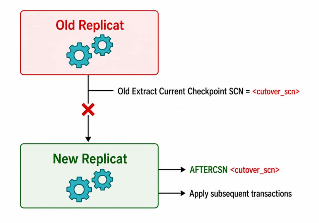

Record the Current Checkpoint SCN from the old Extract as:
cutover_scn = <old_extract_current_checkpoint_scn>
The cutover_scn is the handoff boundary used when the new Replicat is started. It comes from the old Extract’s Current Checkpoint SCN, not from the Replicat checkpoint table.

9. Let the Existing Replicat Reach EOF and Stop Gracefully
After stopping the old Extract and recording cutover_scn, allow the existing Replicat to continue consuming the old trail.
Check its status:
SEND REPLICAT <old_replicat>, STATUS
Wait until the Replicat reaches end of file (EOF). Recheck the status as needed and do not stop the Replicat before it reaches EOF.
After the Replicat reaches EOF, stop it gracefully:
STOP REPLICAT <old_replicat>
Verify that it is stopped:
INFO REPLICAT <old_replicat>
If the Replicat does not stop gracefully, use the documented Replicat synchronization procedure before positioning the replacement Replicat.
No Replicat checkpoint-table query is required to obtain cutover_scn; that value was recorded from the old Extract’s Current Checkpoint SCN in Section 8.
This checkpoint establishes the transaction boundary between the old and new replication streams:
10. Start the New Replicat with AFTERCSN
Start the new Replicat using cutover_scn, the Current Checkpoint SCN recorded from the old Extract in Section 8 (17240996):
START REPLICAT <new_replicat>, AFTERCSN <cutover_scn>
AFTERCSN positions the new Replicat to continue with transactions after the specified SCN, preventing transactions through the handoff boundary from being reapplied.
The new Replicat now consumes the new PDB Extract trail and takes over the replication stream:
After startup, verify that the new Replicat is running, its checkpoint is advancing, and new source transactions are reaching the target.

- Build New Stream
- Create new PDB Extract.
- Register Extract against PDB.
- Change three-part object names to two-part names.
- Remove unnecessary SOURCECATALOG.
- Configure new trail.
- Configure Distribution/Receiver path if required.
- Create new Replicat against new trail.
- Leave new Replicat stopped.
Migration
- Start new PDB Extract.
- Verify new trail is receiving data.
- Monitor old Extract open transactions.
- Wait for transactions predating the safe capture boundary to complete.
- Stop old CDB Extract after the safe cutover point is established.
- Run INFO EXTRACT <old_extract>, SHOWCH.
- Record the old Extract’s Current Checkpoint SCN as cutover_scn.
- Let the existing Replicat reach EOF.
- Stop old Replicat gracefully.
- Start new Replicat with AFTERCSN <cutover_scn>.
- Verify Replicat is applying transactions.

16. Important Operational Principle
The migration should be treated as a controlled handoff between two replication streams, not as an in-place modification of an Extract.
The safe sequence is:
This overlap-and-handoff approach minimizes replication interruption. The handoff boundary is the Current Checkpoint SCN recorded from the old CDB Extract, and the new Replicat is positioned after that boundary with AFTERCSN <cutover_scn>.
