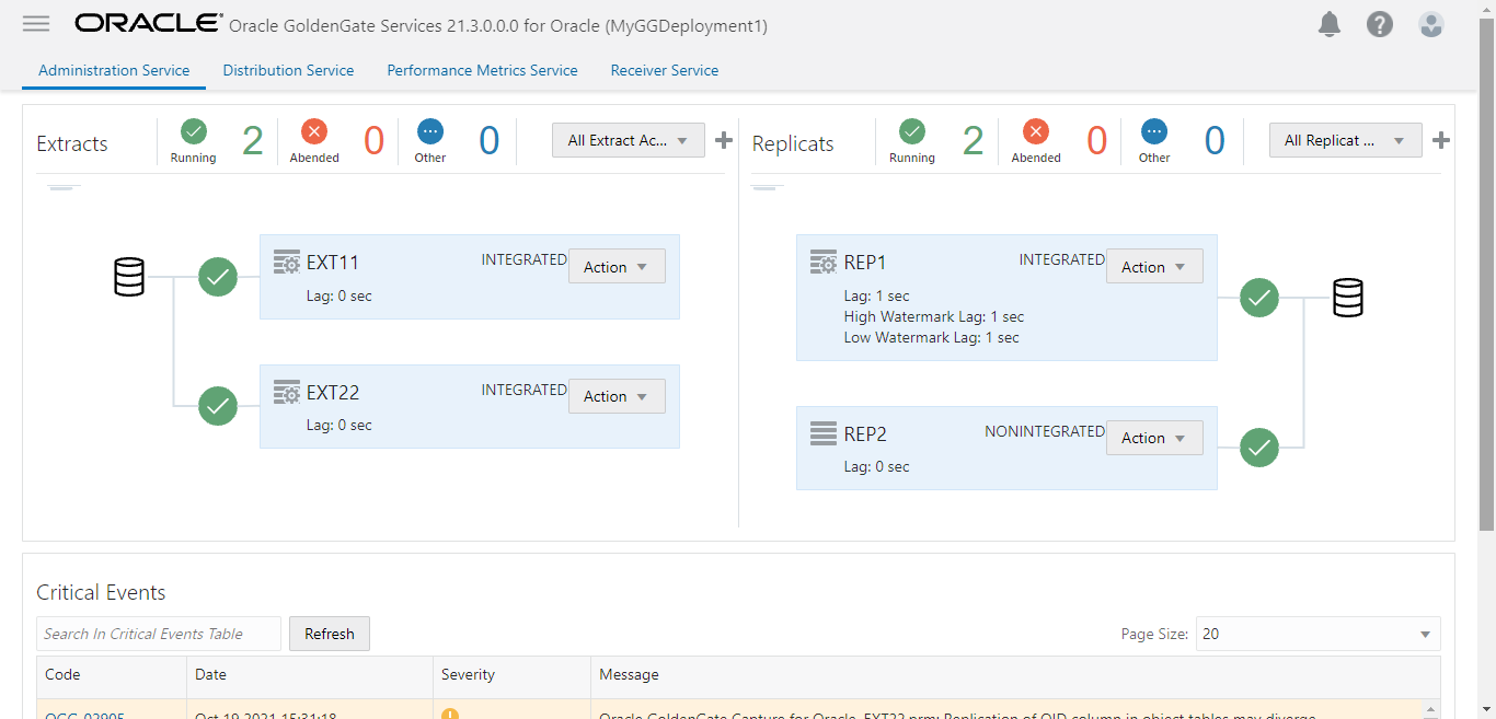

Save the code in a YAML (yml) file and run the playbook:
[opc@developerinstance2021 Ansible-Playbooks]$ ansible-playbook OCI_GG_CREATE_EXTRACT.yml
[WARNING]: provided hosts list is empty, only localhost is available. Note that the implicit localhost does not match ‘all’
PLAY [localhost] ***********************************************************************************************************
TASK [Gathering Facts] *****************************************************************************************************
ok: [localhost]
TASK [CREATE EXTRACT] ******************************************************************************************************
TASK [DEBUG / GOT INFO] ****************************************************************************************************
ok: [localhost] => {
“msg”: {
“$schema”: “api:standardResponse”,
“links”: [
“href”: “https://h656s4zodc2q.deployment.goldengate.eu-frankfurt-1.oci.oraclecloud.com/services/v2/extracts/EXT3“,
“mediaType”: “application/json”,
“rel”: “canonical”
“rel”: “self”
“messages”: [
“$schema”: “ogg:message”,
“code”: “OGG-12142”,
“issued”: “2021-09-14T08:39:52Z”,
“severity”: “WARNING”,
“title”: “The json property ‘/source/tranlogs’ has been deprecated. Expected value is: ‘/source’.”,
“type”: “http://www.w3.org/Protocols/rfc2616/rfc2616-sec10.html#sec10.4.1“
“code”: “OGG-08100”,
“issued”: “2021-09-14T08:39:53Z”,
“severity”: “INFO”,
“title”: “Integrated Extract added.”,
“type”: “http://docs.oracle.com/goldengate/c2130/gg-winux/GMESG/oggus.htm#OGG-08100“
“code”: “OGG-10183”,
“severity”: “INFO”,
“title”: “Parameter file EXT3.prm passed validity check.”,
“type”: “http://docs.oracle.com/goldengate/c2130/gg-winux/GMESG/oggus.htm#OGG-10183“
“severity”: “INFO”,
“title”: “EXTTRAIL added.”,
PLAY RECAP *****************************************************************************************************************
localhost : ok=3 changed=0 unreachable=0 failed=0 skipped=0 rescued=0 ignored=1

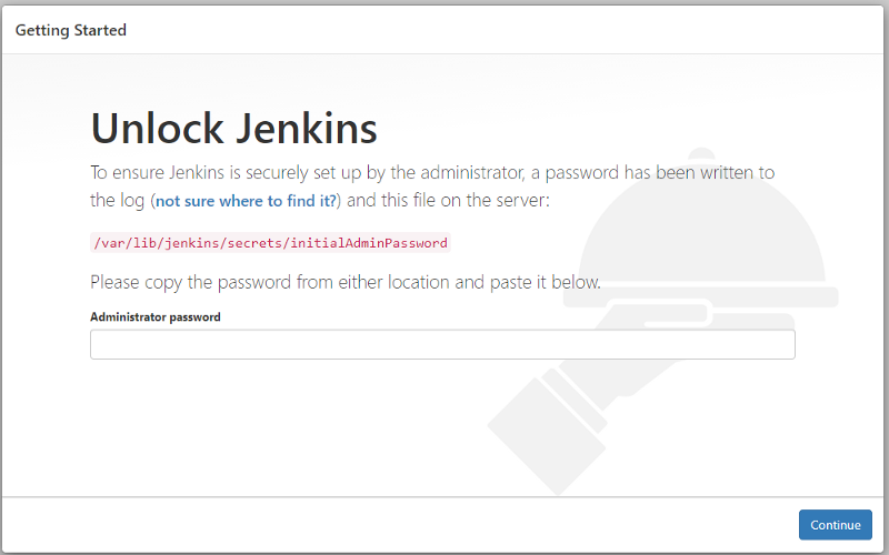

Try to access Jenkins — <ip / host>/8080
You should see this message:
Copy the password:
sudo cat /var/lib/jenkins/secrets/initialAdminPassword

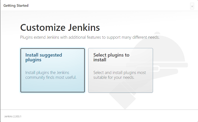

Choose “Install Suggested Plugins”:

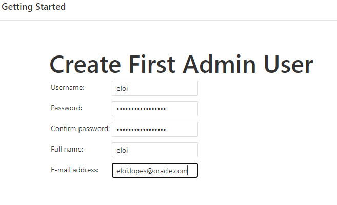

Create the Admin user and then Save and Finish:

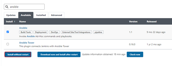

Let’s start by installing the plugin.
Installing Ansible Plugin
Go to Manage Jenkins and then Manage Plugins. Click on Available and search for Ansible:
Select the first option and “Install without restart”.

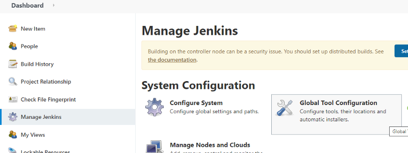

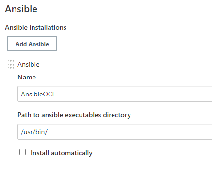

Now we need to configure the Ansible plugin. Go to Manage Jenkins and then Global Tool Configuration:
Scroll down and click Add Ansible. You can find the Ansible path using the command “which ansible” from the command on your Linux instance. Click Save.

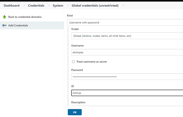

Configuring GitHub on Jenkins (Optional — only for private repositories)

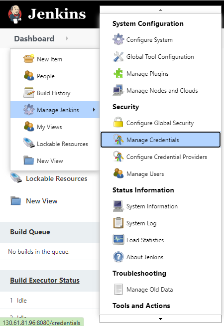

Click on Dashboard and then Manage Credentials:
And then System:
Click on “Global credentials (unrestricted)”, and on the left side, you should see “Add Credentials”. Click on it.
Please fill out the fields with your GitHub credentials (username and token):

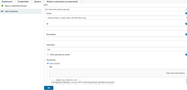

Creating credentials for Ansible
Click again on “Add credentials” and then choose “SSH Username with Private Key”. For Private Key, select Enter directly and paste your SSH private key from your Ansible instance:

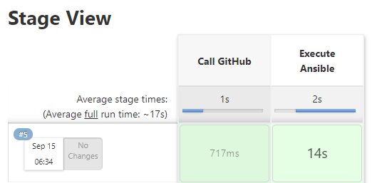

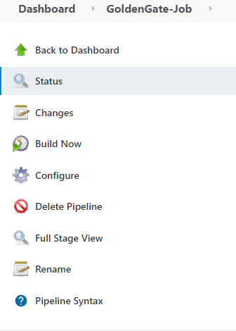

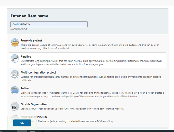

Creating Jenkins Pipeline
Click on New Item, give a name to your pipeline, choose Pipeline and click OK:
pipeline{
agent any
stages{
stage(‘Call GitHub’){
steps{
git branch: ‘Ansible’, credentialsId: ‘github’, url: ‘https://github.com/eloilopes/GoldenGateExamples’
stage(‘Execute Ansible’){
steps{
ansiblePlaybook credentialsId: ‘<the credential ID for Ansible>’, disableHostKeyChecking: true, installation: ‘<The name of Anisble installation we defined in the plugin>AnsibleOCI’, playbook: ‘OCI_GG_RESET_DEVELOPMENT.yml’

Now, click on “Build now” to deploy your pipeline.
If everything goes well, you should see this:
Now check your OCI GoldenGate Deployment. You should see that all processes have been created.
