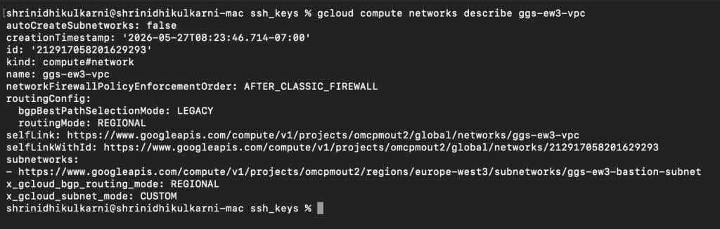

Step 1: Create or validate the Google Cloud VPC
Create a VPC network in the Google Cloud project that hosts Oracle AI Database@Google Cloud resources. Use an IPv4-only VPC design because Oracle AI Database@Google Cloud supports IPv4 connections.
For complete VPC setup instructions, follow the Google Cloud documentation for creating and managing VPC networks. The Google Cloud documentation covers auto mode and custom mode VPC networks, subnet behavior, console and CLI options, and the requirement that each new VPC network name must be unique within the same project.
This walkthrough uses the Google Cloud CLI for provisioning examples. At the time of writing, the Oracle AI Database@Google Cloud documentation for creating GoldenGate deployments, connections, and connection assignments documents the GoldenGate provisioning flow through gcloud CLI commands and REST API examples. We use gcloud throughout this blog for consistency, repeatability, and easy automation. Before running the commands in this blog, install and initialize the Google Cloud CLI.

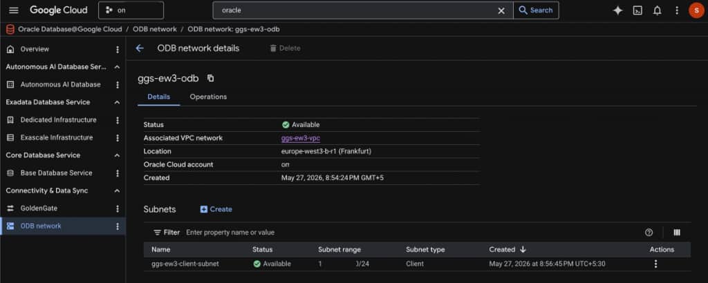

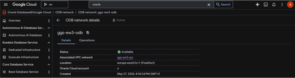

Step 2: Create the ODB Network
Create the ODB Network in the project associated with the Oracle AI Database@Google Cloud Marketplace order. The ODB network must be created in the same region and zone where the Oracle AI Database@Google Cloud resources will be provisioned. You can create the ODB Network by using the Google Cloud console, the Google Cloud CLI, or the REST API. This blog uses the gcloud CLI example for repeatability, but the official Google Cloud documentation provides console steps, the equivalent gcloud oracle-database odb-networks create command, and a REST API curl example.
gcloud oracle-database odb-networks create ODB_NETWORK_ID \
--project=PROJECT_ID \
--location=REGION \
--network=projects/PROJECT_ID/global/networks/VPC_NETWORK
Replace:
PROJECT_ID        = Google Cloud project ID
REGION            = Google Cloud region
ODB_NETWORK_ID    = ODB Network ID
VPC_NETWORK       = Google Cloud VPC network name
Step 3: Create the Client ODB Subnet
Create a Client ODB Subnet with a non-overlapping CIDR range. The accepted subnet purposes are client_subnet and backup_subnet; Autonomous AI Database and GoldenGate deployment requires a Client ODB Subnet.
gcloud oracle-database odb-networks odb-subnets create ODB_SUBNET_ID \
  --location=REGION \
  --odb-network=ODB_NETWORK_ID \
  --cidr-range=CIDR_RANGE \
  --purpose=client_subnet

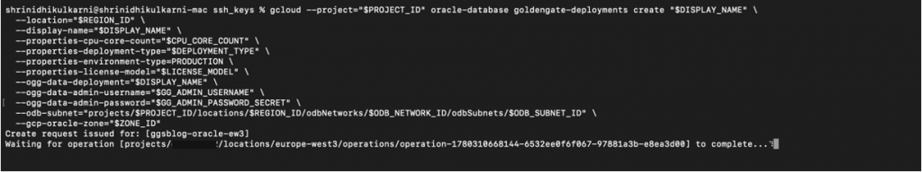

Use the following command pattern to create a GoldenGate deployment:
gcloud oracle-database goldengate-deployments create DEPLOYMENT_ID \
--location=REGION \
--display-name="DEPLOYMENT_NAME" \
--gcp-oracle-zone=GCP_ORACLE_ZONE \
--odb-subnet=projects/ODB_NETWORK_PROJECT_ID/locations/ODB_NETWORK_REGION/odbNetworks/ODB_NETWORK_ID/odbSubnets/ODB_SUBNET_ID \
--properties-license-model=LICENSE_MODEL \
--properties-environment-type=ENVIRONMENT_TYPE \
--properties-is-auto-scaling-enabled \
--properties-deployment-type=DEPLOYMENT_TYPE \
--properties-cpu-core-count=CPU_CORE_COUNT \
--ogg-data-deployment=OGG_DEPLOYMENT_NAME \
--ogg-data-admin-username=OGG_ADMIN_USERNAME \
--ogg-data-admin-password-secret-version=OGG_ADMIN_PASSWORD
Replace
DEPLOYMENT_ID = Unique GoldenGate deployment resource ID
DEPLOYMENT_NAME = Display name shown in Google Cloud
GCP_ORACLE_ZONE = Google Cloud Oracle zone
ODB_NETWORK_PROJECT_ID = Project containing the ODB Network
ODB_NETWORK_REGION = Region containing the ODB Network
ODB_SUBNET_ID = Client ODB Subnet ID
LICENSE_MODEL = bring-your-own-license or license-included
ENVIRONMENT_TYPE = DEVELOPMENT_OR_TESTING or PRODUCTION
DEPLOYMENT_TYPE = Deployment technology, such as DATABASE_ORACLE or BIGDATA
CPU_CORE_COUNT = Number of OCPUs, from 1 to 24
OGG_DEPLOYMENT_NAME = GoldenGate instance deployment name
OGG_ADMIN_USERNAME = GoldenGate administrator username
OGG_ADMIN_PASSWORD = GoldenGate administrator user password

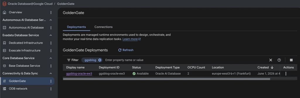

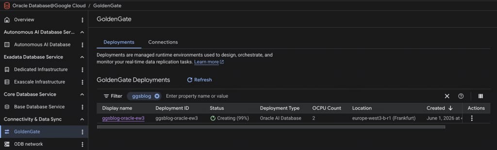

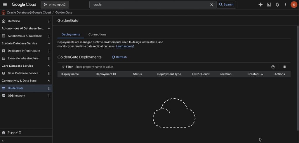

Step 6: Verify the GoldenGate deployment
After the deployment is created, verify that it is listed and available before creating connections or assigning connections.
List GoldenGate deployments:
gcloud oracle-database goldengate-deployments list \
  --location=REGION
Describe a specific deployment:
gcloud oracle-database goldengate-deployments describe DEPLOYMENT_ID \
  --location=REGION

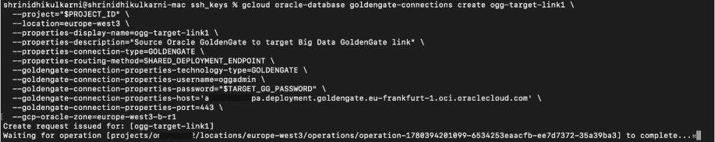

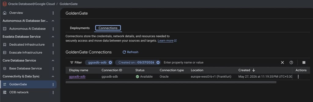

Step 8: Create GoldenGate connections for Source and Target
Use the connection command pattern below required for creating connection for both source and target. The final properties depend on the connection type you choose.
gcloud oracle-database goldengate-connections create CONNECTION_ID \
--location=REGION \
--properties-display-name="CONNECTION_NAME" \
--properties-description="DESCRIPTION" \
--properties-connection-type=CONNECTION_TYPE \
--properties-routing-method=ROUTING_METHOD \
CONNECTION_SPECIFIC_PROPERTIES
Replace:
CONNECTION_ID                 = Unique GoldenGate connection resource ID
CONNECTION_NAME               = Display name shown in Google Cloud
DESCRIPTION                   = Short description of the connection purpose
CONNECTION_TYPE               = ORACLE, GOLDENGATE, GOOGLE_BIGQUERY, MYSQL, POSTGRESQL, and so on
ROUTING_METHOD                = SHARED_DEPLOYMENT_ENDPOINT or DEDICATED_ENDPOINT
CONNECTION_SPECIFIC_PROPERTIES = Properties required by the selected connection type

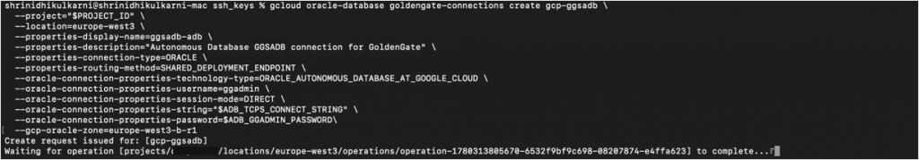

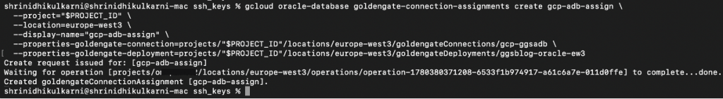

Here is an example for creating a GoldenGate connection for Oracle Autonomous AI Database@Google Cloud,
gcloud oracle-database goldengate-connections create gcp-ggsadb \
  --project="$PROJECT_ID" \
  --location=europe-west3 \
  --properties-display-name=ggsadb-adb \
  --properties-description="Autonomous Database GGSADB connection for GoldenGate" \
  --properties-connection-type=ORACLE \
  --properties-routing-method=SHARED_DEPLOYMENT_ENDPOINT \
  --oracle-connection-properties-technology-type=ORACLE_AUTONOMOUS_DATABASE_AT_GOOGLE_CLOUD \
  --oracle-connection-properties-username=ggadmin \
  --oracle-connection-properties-session-mode=DIRECT \
  --oracle-connection-properties-string="$ADB_TCPS_CONNECT_STRING" \
  --oracle-connection-properties-wallet-file="${PATH_ADB_WALLET_FILE}" \
  --oracle-connection-properties-password=$ADB_GGADMIN_PASSWORD \
  --gcp-oracle-zone=europe-west3-b-r1
For selecting the Autonomous AI database@Google Cloud, the CLI equivalent property is:
--oracle-connection-properties-gcp-database-id=projects/<PROJECT_ID>/locations/<REGION>/autonomousDatabases/<ADB_NAME>
Optional: Create a GoldenGate connection
Optional step: Create a GOLDENGATE connection only when your topology needs one GoldenGate deployment to connect to another GoldenGate deployment. A common example is a source Oracle AI Database GoldenGate deployment sending trail files to a target Big Data GoldenGate deployment by using a Distribution Path. This is the topology used later in Part 2 for Autonomous AI Database to BigQuery replication.
gcloud oracle-database goldengate-connections create ogg-target-link1 \
  --properties-display-name=ogg-target-link1 \
  --properties-description="Source Oracle GoldenGate to target Big Data GoldenGate link" \
  --properties-connection-type=GOLDENGATE \
  --goldengate-connection-properties-technology-type=GOLDENGATE \
  --goldengate-connection-properties-username=oggadmin \
  --goldengate-connection-properties-password="$TARGET_GG_PASSWORD" \
  --goldengate-connection-properties-host='<deployment_fqdn>' \
  --goldengate-connection-properties-port=443 \
  --gcp-oracle-zone=REGION
Step 9: Assign connections to deployments
After a connection becomes available, assign it to the GoldenGate deployment that needs to use it. A deployment can have multiple assigned connections, and a connection can be assigned to multiple deployments.
gcloud oracle-database goldengate-connection-assignments create ASSIGNMENT_ID \
  --location=REGION \
  --display-name="ASSIGNMENT_NAME" \
  --properties-goldengate-connection=projects/PROJECT_ID/locations/REGION/goldengateConnections/CONNECTION_ID \
  --properties-goldengate-deployment=projects/PROJECT_ID/locations/REGION/goldengateDeployments/DEPLOYMENT_ID

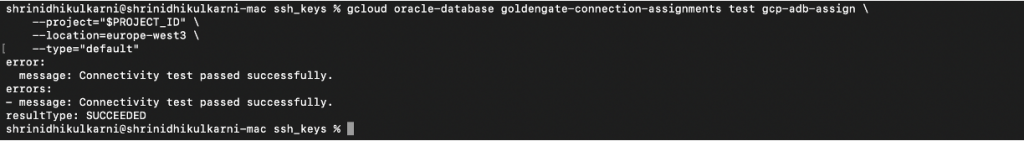

Step 10: Test and verify connection assignments
After creating each connection assignment, test it before configuring Extracts, Replicats, Distribution Paths, or data transforms.
gcloud oracle-database goldengate-connection-assignments test ASSIGNMENT_ID \
  --location=REGION \
  --type="TYPE"
At this point, the GoldenGate foundation is ready. We have provisioned the deployment runtime, selected supported deployment and connection types, assigned connections to deployments, and verified connectivity. We have not yet configured Extracts, Replicats, Distribution Paths, or data transforms. Those workload-specific steps belong in follow-on implementation guides. In Part 2, we will use this foundation to configure change data capture from Oracle Autonomous AI Database on Oracle AI Database@Google Cloud to Google BigQuery.
Final verification from the Google Cloud console
After creating the GoldenGate deployments, connections, and connection assignments, verify the resources from the Google Cloud console before configuring Extracts, Replicats, Distribution Paths, or Transforms.
In the Google Cloud console, open the project used for Oracle Database@Google Cloud, then navigate to Oracle AI Database@Google Cloud > GoldenGate.
