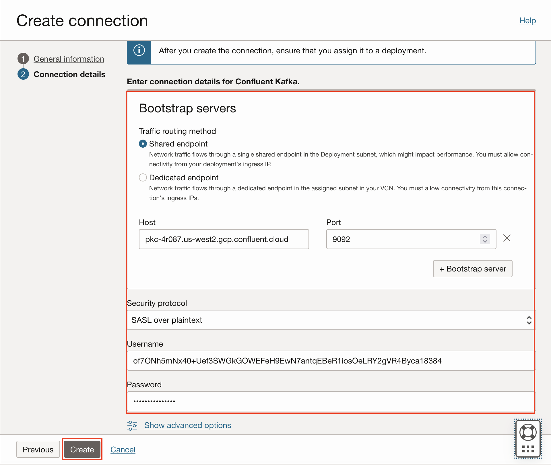

Create OCI GoldenGate Connections:
We need to create a Confluent Cloud connection. For the detailed steps, you can refer to OCI GoldenGate Documentation
Shared endpoint traffic routing method will route the traffic from through the same subnet as the deployment subnet.
As the host, use the bootstrap server and port as 9092. You don’t need to add any private ip. When customer assigned subnet is selected, OCI GoldenGate will perform DNS lookups in the private subnet selected. For Security protocol, select SASL over Plaintext. Use api key/ secret as username/ password.

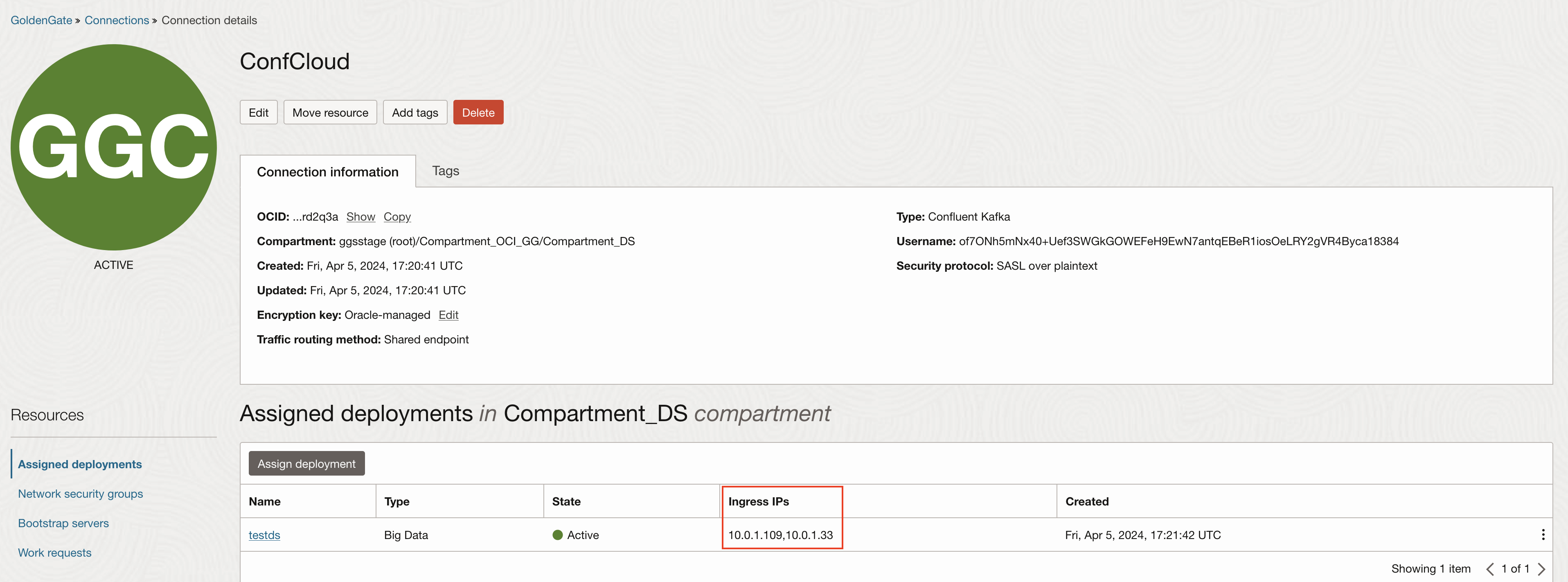

After connection created and assigned to deployment, it will get ingress IPs. Please make sure that they’re whitelisted in your deployment’s subnet security list.
