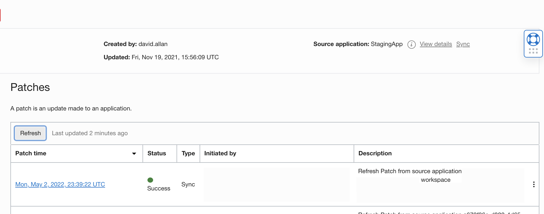

So how do we synchronize? We’ve finished another phase of our development and we want to synchronize what we have done in QA or testing workspace? Let’s see…
Promote / Synchronize Application
Here we can use the Sync option the application panel…
DI Sync application - promote
How do we do this via the SDKs? Let’s look at one example this time, using the OCI CLI. We do this by creating an application patch with the patch type of REFRESH;
  • oci –profile <oci_profile_user> data-integration application create-patch –workspace-id <Target_Workspace_OCID> –application-key <Application_key> —patch-type REFRESH  –name <Patch_Name> –identifier <Patch_Identifier> –object-keys []
For example, in my example, I was promoting a release version 1.1 from development to test, I named the patch and used the patch-type of REFRESH as;
  • oci data-integration application create-patch –workspace-id ocid1.tbd –application-key key.tbd –patch-type REFRESH –name RELEASE1.1 –identifier RELEASE1.1 –object-keys []
With that, we can create an application and also refresh and synchronize it when we are happy with the contents.

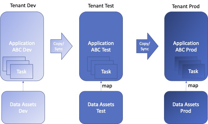

References within an Application
Applications have tasks and the tasks reference other object types such as data assets or other tasks. From an application you can list the references (CLI is here) for an application, references include data assets, connections (data assets and connections are referenced from many task types) and tasks themselves (tasks are referenced from task schedules and pipelines eg a REST task could be used in a pipeline).
When an application is copied you can reconfigure/update the references to objects in your workspace (see CLI here) – the references will obviously be different dependent on dev / test / production ie your development database will more than likely be different from your production one.

It’s possible to have dozens of tasks and they all reference data asset X above. Reconfiguring the reference for data asset X once will mean all uses of that data asset from the dozens of tasks will reference the new reference making it simple to move from dev to test to production.

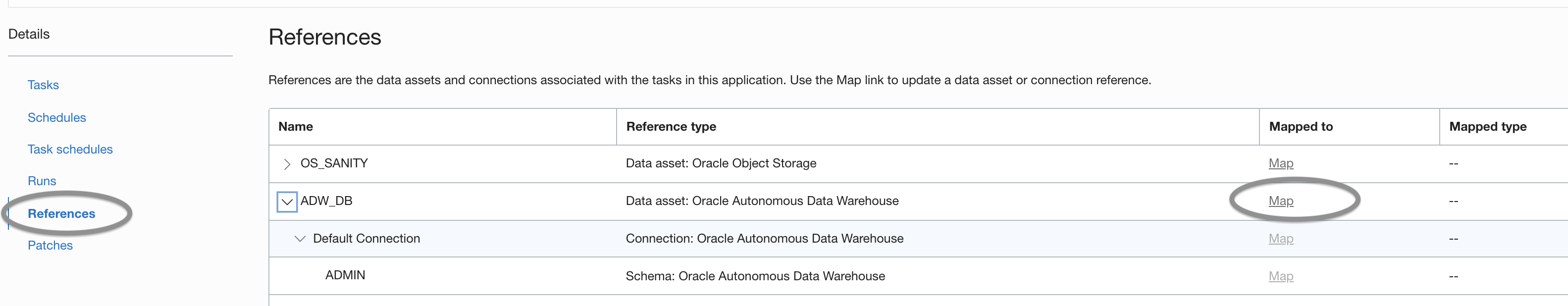

How to update references in an Application – Update Reference
The update reference API in Reference is used to update data asset/connection/task references from an application – the child references can also be defined (such as connection within a data asset). For example below you can see from within my application there are references to different data asset types;
Application references
The ‘Map’ action in the OCI Console is the update reference API. So, for example from the OCI CLI you can do;
oci data-integration reference update –workspace-id <workspace_ocid> –application-key <application_key> –reference-key <rference_key> –child-references ‘[{“targetObject”: null,”key”: “child_key”}]’ –target-object ‘{“key”: “data_asset_key”,”modelType”: “data_asset_type”}’
