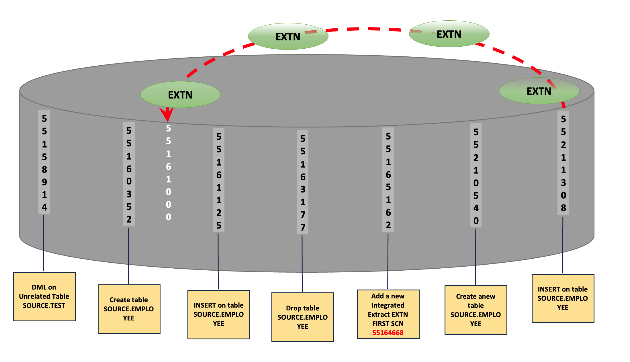

Since we had DDL changes on the interested table and the Extract processed the redo corresponding to , the older table version. It will either ignore the error or abend, which is based on the parameter setting.

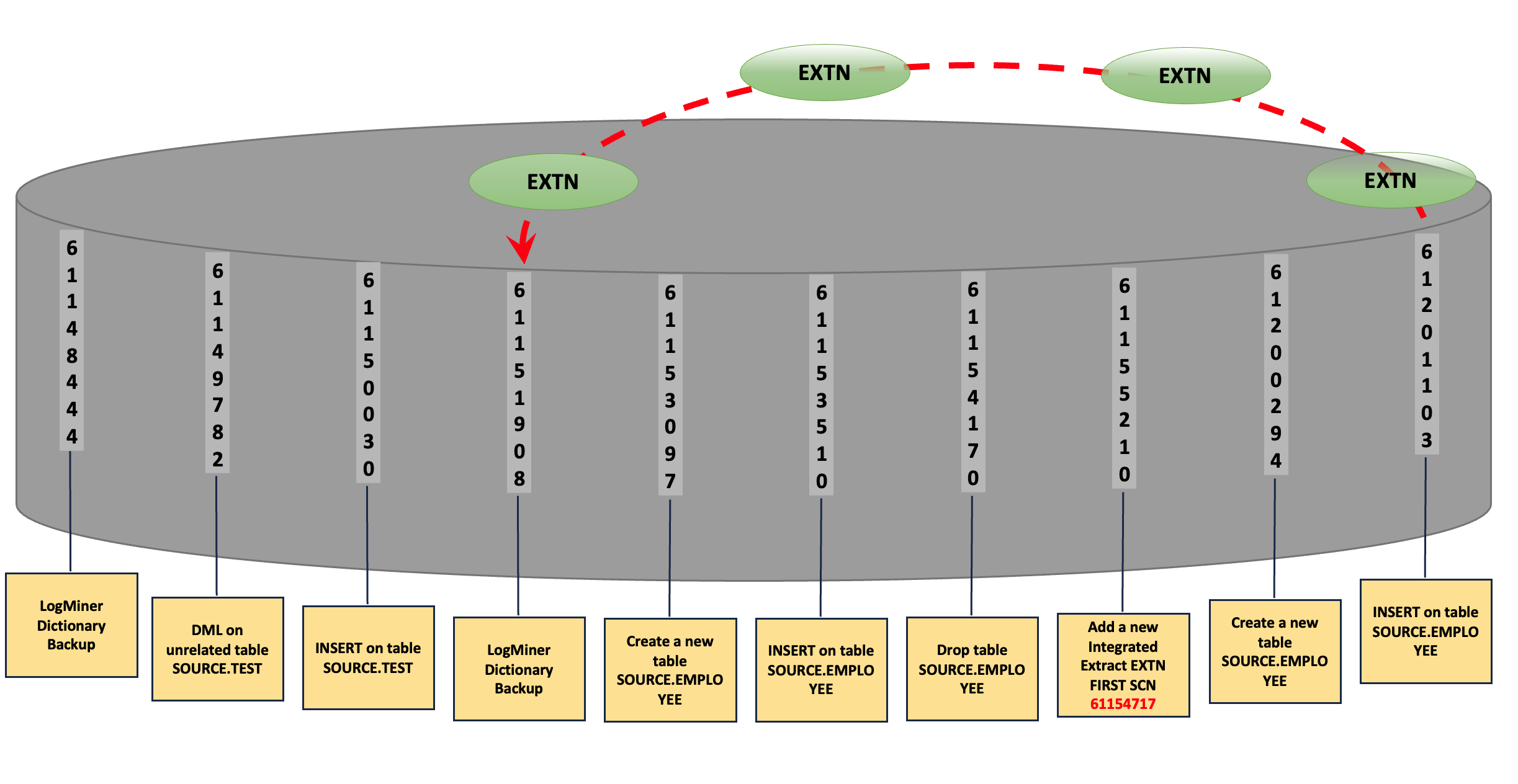

There are three use cases or scenarios which are explained one by one in detail.
  1. Alter the existing Integrated Extract to the SCN below the FIRST_SCN.
  2. Alter the existing Integrated Extract to the SCN below the FIRST_SCN with LogMiner Data Dictionary backups in place.
  3. Create and register an Integrated Extract with LogMiner Data Dictionary SCN which is below the FIRST_SCN.
Alter Integrated Extract to the SCN below the FIRST_SCN
The scenario is as below,
Step
Time (SCN)
SCN# in SCENARIO
OPERATIONS PERFORMED
1
SCN 1
55158914
Perform DML on an unrelated table SOURCE.TEST (table which is not in replication)
2
SCN 2
55160352
Create a table SOURCE.EMPLOYEE
3
SCN 3
55161125
Perform INSERT operations on table SOURCE.EMPLOYEE
4
SCN 4
55163177
Drop the table SOURCE.EMPLOYEE
5
SCN 5
55165162
Add a new Integrated Extract EXTN
6
SCN 6
55210540
Create a new (modified) table SOURCE.EMPLOYEE
7
SCN 7
55211308
8
FIRST SCN
55164668
Alter the Integrated Extract below the FIRST_SCN 55164668, which is SCN 55161000
Alter_SCN-Scenario1

Now, let us assume that for some reason the Integrated Extract has abended and we need to reposition to the SCN which is below the FIRST_SCN.
OGG> INFO ALL
Program      Status      Group      Type         Lag at Chkpt      Time Since Chkpt
ADMINSRVR    RUNNING
DISTSRVR     RUNNING
PMSRVR       RUNNING
RECVSRVR     RUNNING
EXTRACT      RUNNING     EXTN       INTEGRATED   00:00:00           00:00:48
FIRST_SCN of the Integrated Extract “EXTN” is 55164668
We want to alter it to the SCN 55161000 which is below the FIRST_SCN 55164668
8. Alter the Integrated Extract below the FIRST_SCN 55164668, which is SCN 55161000
OGG> ALTER EXTRACT extn SCN 55161000
2023-04-07T09:39:58Z WARNING OGG-02411 Altering Extract to an SCN less than the current First SCN.
Current First SCN is 55,164,668. Altered Start SCN is 55,161,000.
2023-04-07T09:39:58Z INFO OGG-08100 Extract altered.
You can see a WARNING message above which says the Integrated Extract has been altered to an SCN which is below the FIRST SCN.
Started the Integrated Extract process.

From the below INFO DETAIL output, we can see the FIRST SCN has been changed or altered to SCN 55161000
OGG> info EXTRACT extn DETAIL
Extract EXTN Last Started 2023-04-07 09:40 Status RUNNING
Checkpoint Lag 00:00:00 (updated 00:00:07 ago)
Process ID 1732529
Log Read Checkpoint Oracle Integrated Redo Logs
2023-04-07 09:41:10
SCN 0.55215871 (55215871)
Encryption Profile LocalWallet

Integrated Extract outbound server first scn: 0.55161000 (55161000)
Integrated Extract outbound server filtering start scn: 0.55161000 (55161000)

Alter Integrated Extract to the SCN below the FIRST_SCN with LogMiner Data Dictionary backups
Step
SCN
SCN# in SCENARIO
1
SCN 1
61148444
Already LogMiner Dictionary Backup is taken
2
SCN 2
61149782
Perform DML on an unrelated table (table which is not in replication) – Truncated the Table SOURCE.TEST
3
SCN 3
61150030
Performed INSERT operations on table SOURCE.TEST
4
SCN 4
61151908
LogMiner Dictionary backup is taken
5
SCN 5
61153097
Created a new table SOURCE.EMPLOYEE
6
SCN 6
61153510
7
SCN 7
61154170
8
SCN 8
61155210
Added a new Integrated Extract “EXTN”. FIRST SCN is 61154717
9
SCN 9
61200294
Create a new table SOURCE.EMPLOYEE
10
SCN 10
61201103
11
FIRST SCN
61154717
Alter the Integrated Extract to is SCN 61151908 which is below the FIRST_SCN 61154717
SCN 61151908 consists of LogMiner Dictionary Backup.
Alter_SCN-Scenario2
OGG> INFO ALL
ADMINSRVR    RUNNING
DISTSRVR     RUNNING
PMSRVR       RUNNING
RECVSRVR     RUNNING
EXTRACT      ABENDED     EXTN       INTEGRATED   00:00:00           00:00:48
FIRST_SCN of the Integrated Extract “EXTN” is 61154717
We want to alter it to the SCN 61151908 which is below the FIRST_SCN 61154717
11. Alter the Integrated Extract to SCN 61151908 which is below the FIRST_SCN 61154717
OGG> ALTER EXTRACT extn SCN 61151908
2023-04-26T11:02:58Z WARNING OGG-02411 Altering Extract to an SCN less than the current First SCN.
Current First SCN is 61,154,717. Altered Start SCN is 61,151,908.
2023-04-26T11:02:58Z INFO OGG-08100 Extract altered.
From the below INFO DETAIL output, we could see the FIRST_SCN has been changed or altered to SCN 61151908

Integrated Extract outbound server first scn: 0.61151908 (61151908)
Integrated Extract outbound server filtering start scn: 0.61151908 (61151908)

Eventhough if you have LogMiner Dictionary backups and position the Integrated Extract to LogMiner Dictionary Backup SCN 61151908, it will not capture the old transactions.
But this is possible, if you create a new Integrated Extract process and register it to that LogMiner Dictionary Backup.
Let us try that now.
Unregistering the existing Integrated Extract process and re-creating it and registering it to the LogMiner Dictionary Backup SCN 61151908
