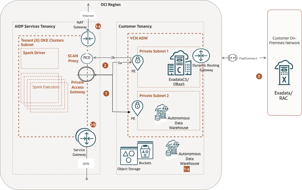

Figure 1 – Schematic Diagram of AIDP service connectivity with Oracle RDBMS use cases
We selected a few use cases below to analyze how network settings and additional configurations enable secure access through private subnets, according to Figure 1 above:
  1. Connecting to ADB in a private subnet
    • 1-a. Connecting to ADB with a Network Access Control List specified
    • 2-a. Connecting with the remaining OCI Services
  2. Connecting to a SCAN (Single Client Access Name) Oracle DB (Exadata/DBaaS)
  3. Connection to on-prem Oracle/DB (Exadata/RAC)

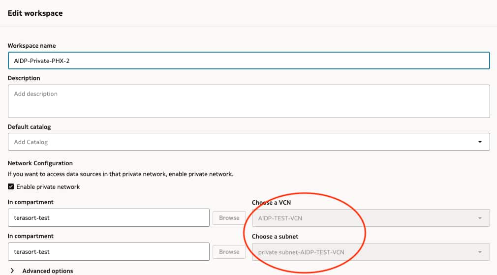

Note: In OCI Data Flow, private access is explicitly configured via a Data Flow Private Endpoint (PE), which uses a dedicated, explicitly defined DNS name associated with the Private Access Gateway. This DNS resolution is tightly coupled to the PE configuration, requiring users to ensure that database endpoints (e.g., SCAN addresses for RAC) are resolvable through this explicitly defined private DNS mapping. As a result, connectivity depends on deliberate DNS setup aligned with the PE construct.
1 – Connecting to an ADB instance configured in the customer’s private subnet
This is perhaps the most common use case. The diagram shows communication between the AIDP Compute Cluster and the ADB instance, routed through a Private Access Gateway that connects to the Customer Private Endpoint. The Private Endpoint is created when the Workspace is configured as private, and the VCN and Subnet are assigned to it. Figure 2 demonstrates the settings in the test Workspace used to verify the functionality.
Note: At present, Oracle AI Data Platform (AIDP) requires a publicly accessible Default Workspace endpoint to interoperate seamlessly with core platform services such as the Data Catalog, Object Storage, Data Lake, and persistent Volumes. This design ensures reliable service-to-service communication, streamlined authentication, and consistent access to shared metadata and storage layers, which are currently exposed via controlled public endpoints within the Oracle Services Network. While all data-plane interactions can still be secured through private networking constructs, the Workspace maintains a public interface to ensure compatibility and operational continuity across dependent services. Looking forward, Oracle is evolving toward a fully private AIDP Workbench model, in which Workspaces will be attached to customer-managed private subnets. This enhancement will eliminate the need for public exposure entirely, enabling end-to-end private execution environments that better align with stringent enterprise security requirements, while preserving seamless integration with platform services via private endpoints and native VCN routing.
Figure 2 – Defining the Workspace networking.

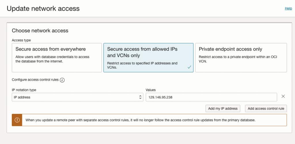

1.a – Connecting with an ADB instance using ACL
Usually, the ADB instance is configured in the Oracle Services Network range; therefore, two potential routing paths can be established: public and private Workspaces.
Public Workspace will connect using the Service NAT Gateway. Although these regional public IPs are advertised, customers can easily identify them by running a notebook, for instance:
!curl -s ifconfig.me
Outbound IP: 144.24.11.156
Similarly, a Private Workspace will connect using a NAT Gateway, but at this time, the customer’s VCN NAT Gateway (**). These IPs are required to configure ADB for the authorized AIDP clusters. Figure 3 illustrates the ADB ACL Configuration below.
** Note: currently, a Private AIDP Workspace does not route to oraclecloud.com public domains, for instance, adb.<region>.oraclecloud.com. Access to these OCI public domains can be granted by raising a support request (SR) on support.oracle.com.
Figure 3 – ADB Network Access Configuration using Access Control List
A common error message occurs if the AIDP Workspace subnet is not part of the authorized IPs that can access the DB, for instance:
TNS:connect request rejected based on current filtering rules

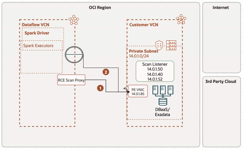

Figure 4 shows an example of a DBaaS Oracle Database system within a private subnet in the customer VCN. The flow of the picture states the sequence used to identify the connectivity:
  1. AIDP Compute cluster initiates a connection to the SCAN Proxy endpoint within the service VCN using the DNS name. AIDP Compute defines a customer DBaaS connection through the SCAN Proxy by selecting a specific port. RCE SCAN proxy forwards the request to the underlying PE VNIC listener in the customer network. It then inspects the SCAN listener response for an IP address of the underlying database cluster instance, creates a Class E NAT IP, and replaces the cluster instance IP with the NAT IP in the SCAN proxy response.
  2. The Private Access Gateway receives the redirect request from the SCAN listener, automatically translates the local listener IP address in the customer’s VCN into a mapped IP address, then returns this information to the Private Workspace components and issues a connection request to one of the local listeners.
Figure 4 – SCAN connection workflow

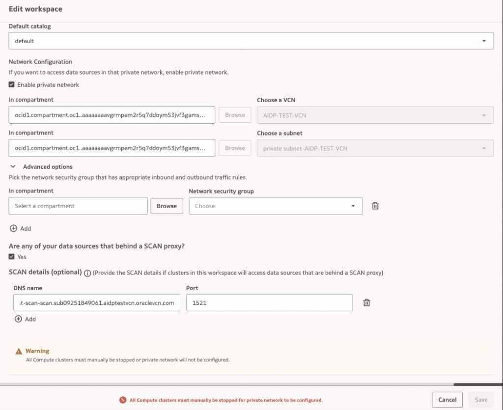

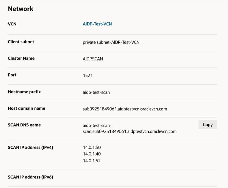

Figure 4a below describes the entries required to configure the AIDP private subnet, including the SCAN of the private DBaaS/Exadata instance.
Figure 4a – DBaaS Network Configuration – SCAN DNS name and SCAN IPs
Figure 5 depicts these entries above in the AIDP private Workspace configuration.
Figure 5 – AIDP Private Workspace SCAN Configuration

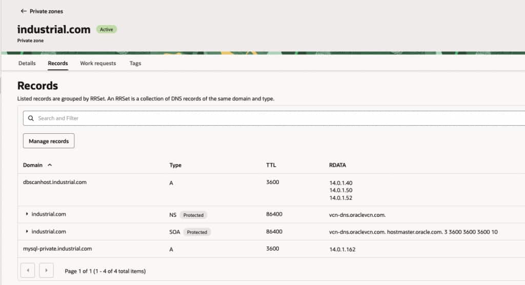

Similarly, as stated in Figure 1, path (3), we can use an OCI VCN subnet to connect to an on-prem engineered DB machine. On this path, create a DNS “A” record for the database system’s SCAN hosts, using their respective IP addresses.  Figure 6 below exemplifies the corporate domain (industrial.com), the SCAN FQDN dbscanhost.industrial.com has the IPs of the SCAN hosts responsible for responding to requests from the compute resources in an AIDP private Workspace attached to this subnet.
Note that connectivity between subnets must be in place before this practical implementation can work. For tips on troubleshooting connectivity, please see the section below.
Figure 6 – DNS Record of the remote SCAN

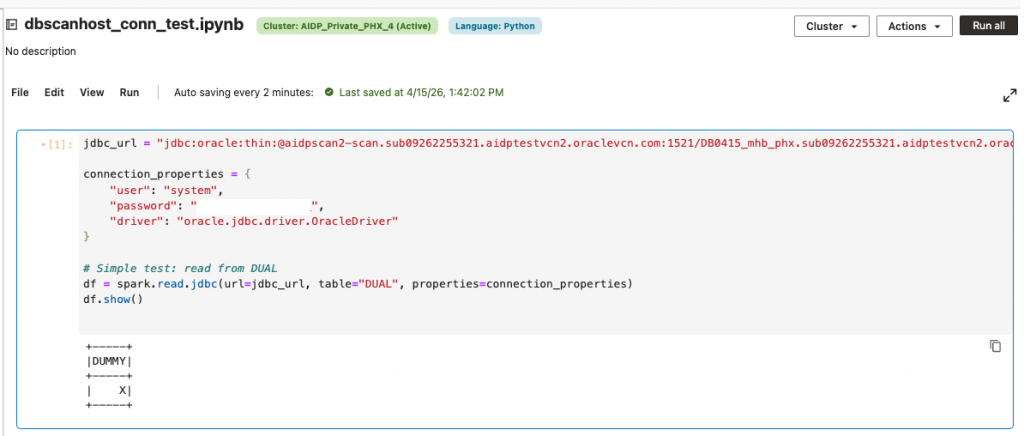

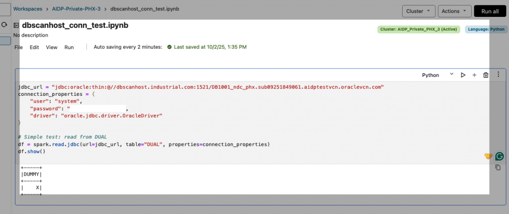

Figure 7 shows a Notebook cell that can be used to validate communication with the SCAN DBs. Note that up to this point, the communication between AIDP and the DB system is using Oracle’s thin client to validate the communication. See the sections below for more details and limitations on thick clients and Wallet use.
Figure 7 – Remote SCAN simple test script

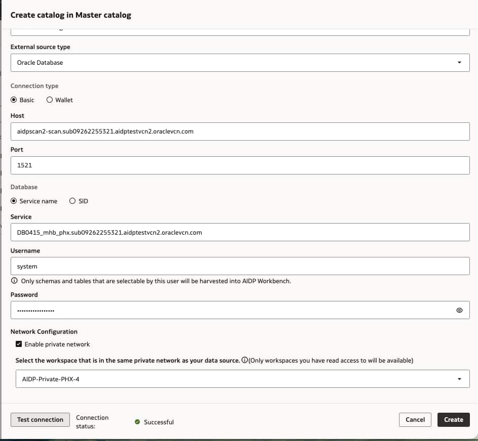

External Catalogs connectivity follows the same principles as the Notebooks above. The Compute clusters inside the private Workspace will similarly establish communication with the Oracle DBs in secure networks. Also similar is the method of communication, using a JDBC thin client to communicate. Useful to mention that the connectivity between the network segments needs to exist before the AIDP Workspace is defined to use them. As a best practice, build your network connectivity diagram and verify communication among the endpoints before launching the Workspace into a private network segment.
Figures 8 and 9 illustrate a critical connection between an External Catalog and a DBaaS instance (this applies to any RAC-based configuration running on the SCAN protocol). AIDP_Private_PHX_4 is an AIDP Workspace attached to a private subnet where the DBaaS database resides. The Host Scan idpscan2-scan.sub09262255321.aidptestvcn2.oraclevcn.com and port, and the DB Service name can be used to validate that connectivity.
Figure 8 & 9 – Asserting External Catalog and Notebook are able to connect to an external DBaaS
Note: Within a Workspace, only Administrator roles can maintain External Catalogs.

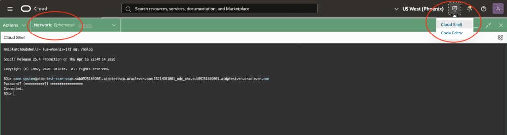

Connectivity tests using Cloud-shell (or an embedded VM in the subnet)
A practical way to validate connectivity to a private Oracle Database from an AIDP private workspace is to use OCI Cloud Shell (highlighted in Figure 10) to attach to the same ephemeral subnet (also highlighted) used by the workspace. By launching Cloud Shell with private network access (or via a delegated subnet configuration), you can effectively place a test environment inside the same VCN context as the AIDP notebook runtime. From there, tools like sql-cl, or simple TCP checks (e.g., nc host port) can confirm whether the database listener is reachable over the private endpoint. This approach helps isolate network issues such as missing security list rules, NSG misconfigurations, or routing problems without modifying the notebook itself. It is particularly useful because AIDP private workspaces often rely on ephemeral subnets and managed networking, making direct troubleshooting difficult; Cloud Shell provides a controlled, reproducible way to verify that the private Oracle Database is accessible under the same network conditions. Figure 10 depicts a process for establishing connectivity to an Oracle DBaaS instance within a private network.
Figures 10 – Using Cloud-shell and SQL-CL to validate the subnet connectivity to the Database
