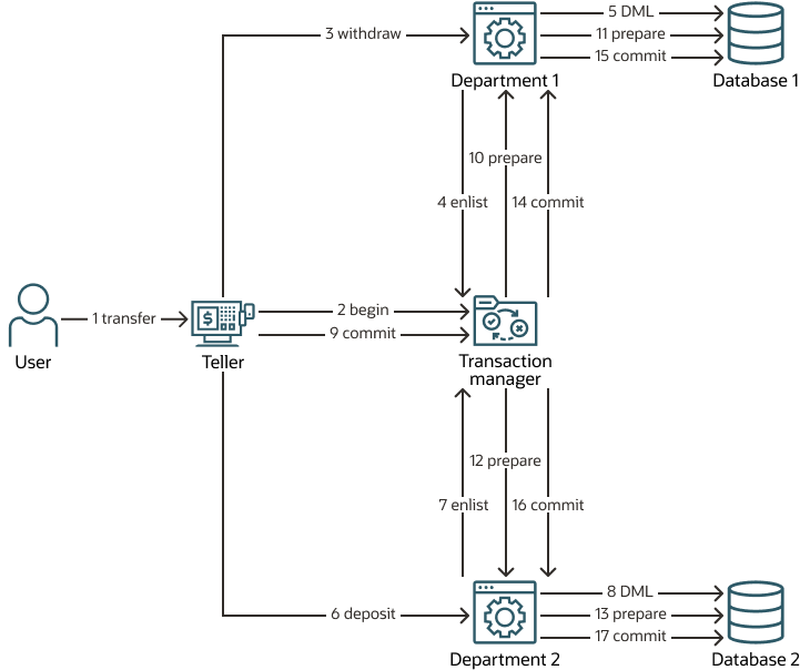

Doing a little reading on the Internet about data consistency and microservices and one is led to believe that distributed transactions are to be avoided. In particular XA distributed transactions are to be avoided due to claimed complexity, performance, and availability issues. However, with XA the complexity is not in the application, but in the transaction manager, which presumably is provided by someone else that takes on that complexity. From the developer’s perspective, XA is probably the easiest transaction pattern to use. All that’s fundamentally required in the application code is to demarcate the boundaries of the transaction, which can simply be done using annotations. Any performance issues due to locking conflicts can largely be dealt with by proper design and avoiding things like hot keys. Here is an updated diagram for the simple Teller application when using XA:
Which looks more complex than the diagram in the first post in this series. However, the complexity is not in the application code, but in the supporting infrastructure. In this case, the MicroTx libraries and transaction manager are used to hide this complexity.
