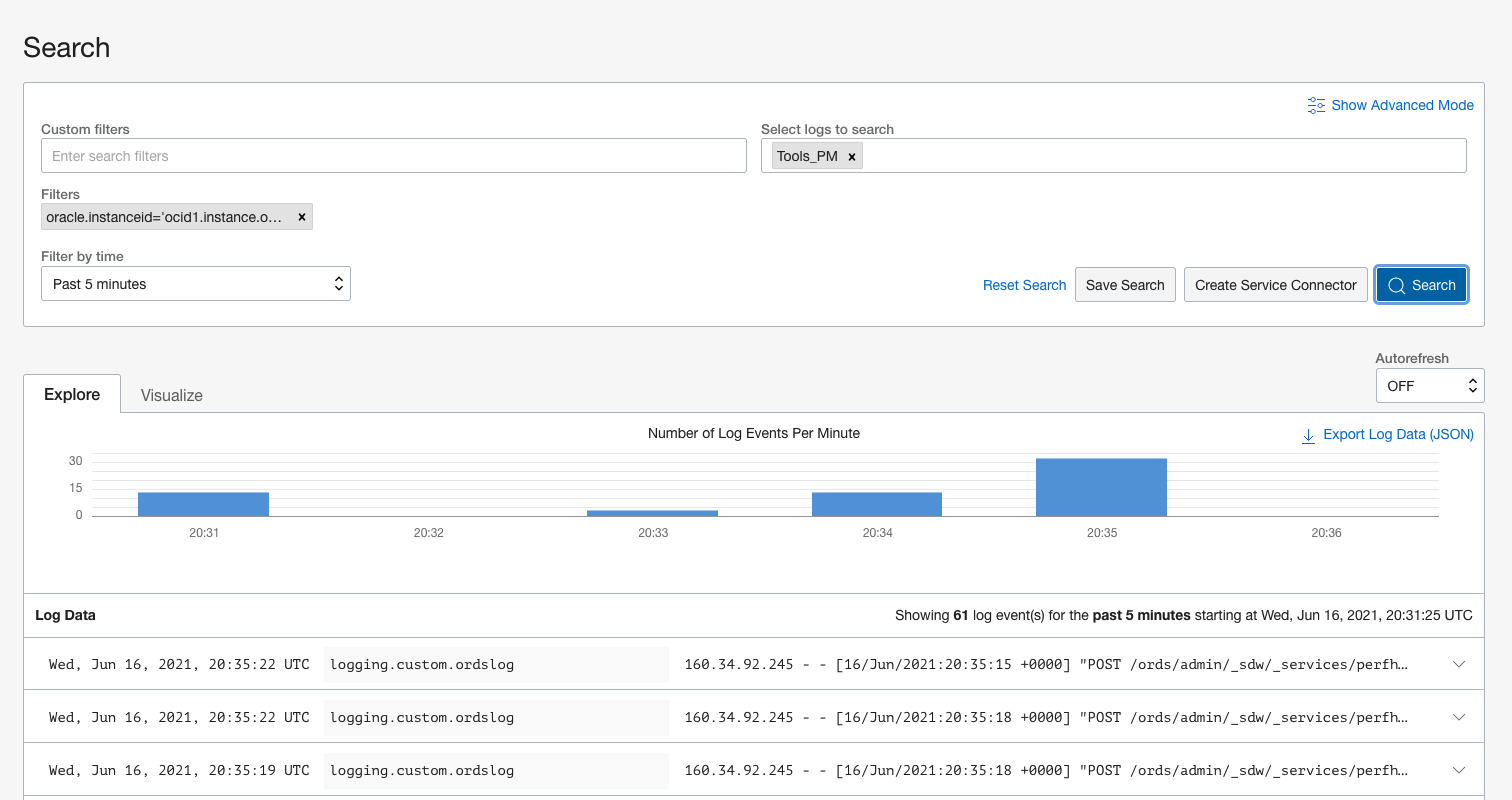

Shortly after the agent is created, you will begin to see logs from the ORDS VM instance appear in this log. The agent is set to tail the log files in the path: /home/opc/ords/conf/ords/standalone/logs/*.log. Your logging path my differ depending on the ORDS logging set up steps.
