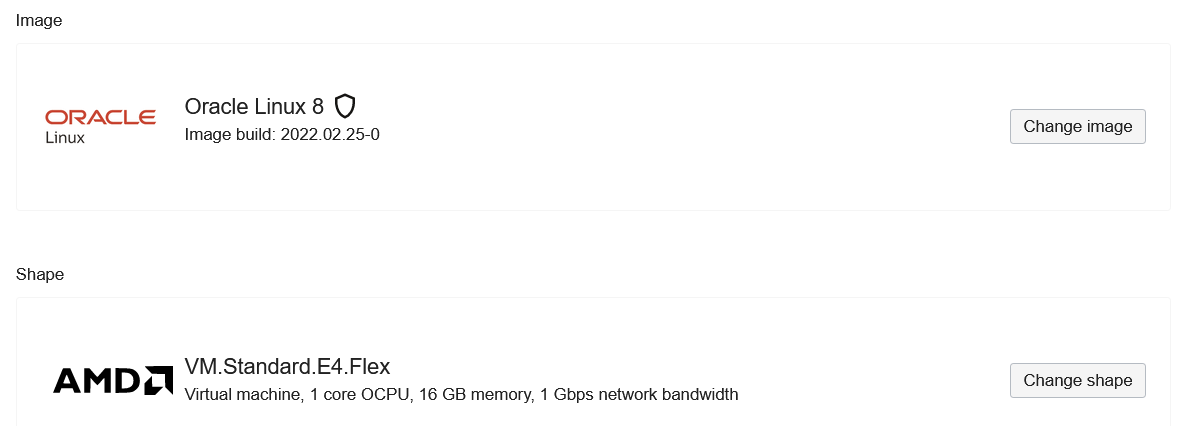

To use the sample, we need somewhere to install the OCI Ansible Collection and its dependencies, OCI SDK for Python and Ansible.  An OCI Oracle Linux 8 compute instance is perfect for this.
Here is the image and shape profile I used for my virtual machine (VM):

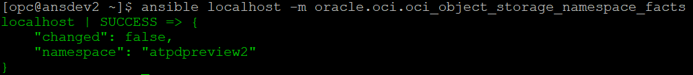

Once you have gone through the steps of generating your API signing key and setting up your configuration file, you can test that everything is working using:
ansible localhost -m oracle.oci.oci_object_storage_namespace_facts
As you can see, Ansible is set up, and our configuration is working correctly!

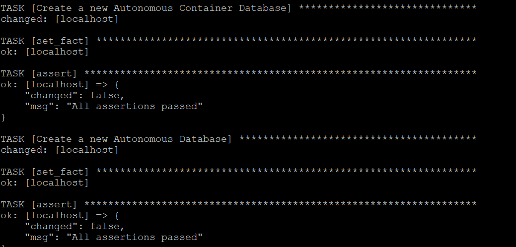

Sample of the partial expected output:
After the script completes, you should see the below recap if everything was successful:
The creation script will take about 60 minutes, and the teardown about 40 minutes to complete.
