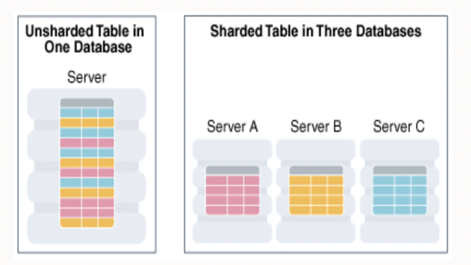

Transportable Binary XML and Oracle Sharding
Sharding is a database architecture technique used to scale databases by partitioning data across multiple independent servers or instances, each holding a portion of the total data (shards). The shards are all coordinated by one instance (coordinator), where all the information is gathered and presented as a single database.
Oracle Sharding - architecture
This architecture is based on a shared-nothing architecture, meaning that each shard knows nothing about the other shards. Each shard could also be used as an independent, single database. Transportable binary XML as self-encapsulated, self-decoding/encoding binary storage on table level allows using a native XMLType with Sharding: it enables sending XML documents over the wire to any other database without limits. Transportable Binary XML is the only supported XMLType storage format in Oracle Sharding environments; specifying other XMLType storage types will throw an error.
