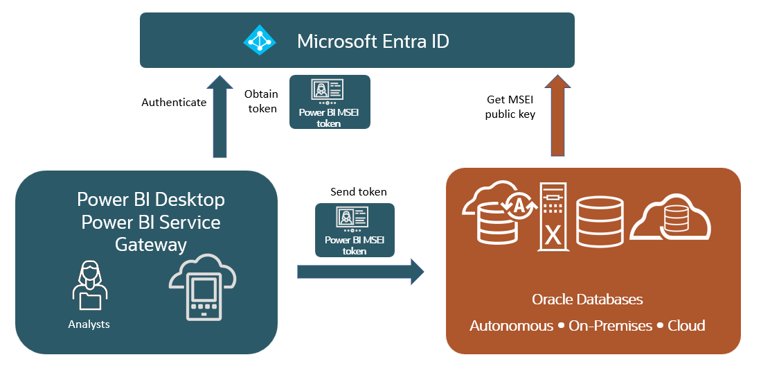

Architecture wire diagram showing a Power BI user authenticating to Power BI desktop or Power BI service. When Power BI connects to the Oracle database, it gets a Power BI Microsoft Entra ID token from Microsoft Entra ID and sends it to the Oracle Database for access. This works for any Oracle Database in the cloud or on-premise.

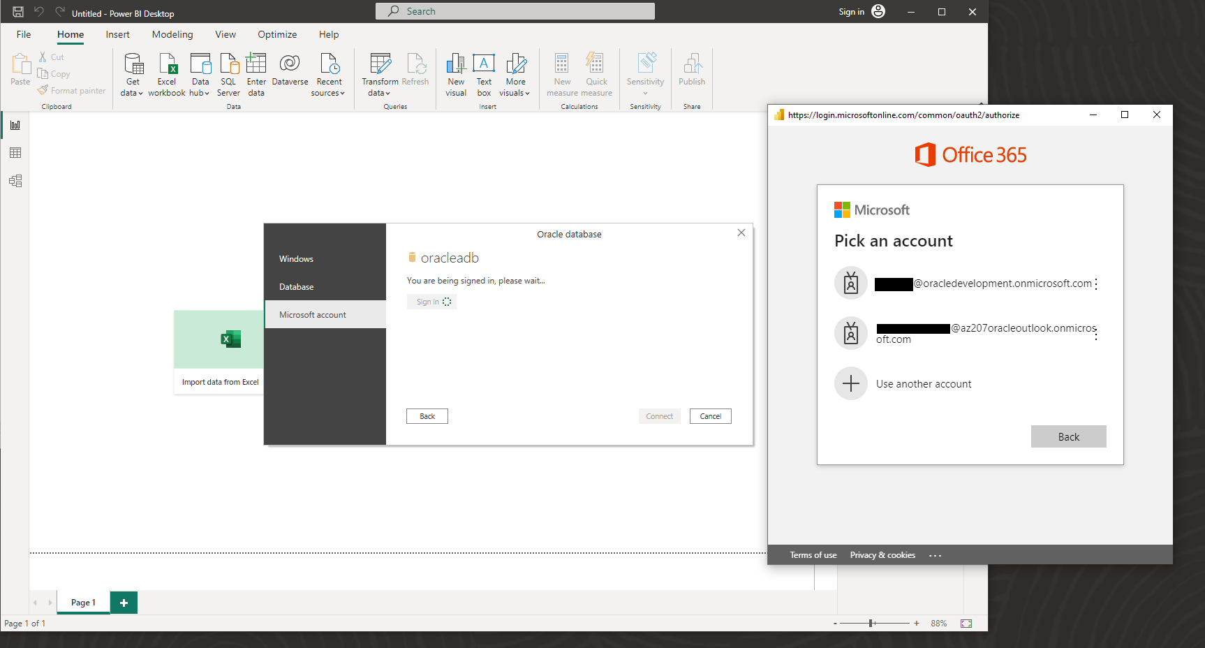

Once done, the user should open Power BI Desktop. They should then select the “Get Data” option from the menu followed by selecting “Oracle Database” as their data source. To use their Azure AD credentials, they choose to connect with “Microsoft Account” and start the sign-in process. Power BI opens a new window that connects to Azure AD and requests the user to enter their account credentials.
Screenshot of Power BI desktop making a connection to an Oracle Database using Microsoft Entra ID Single-Sign-On. The Microsoft Entra ID pick list for accounts pops up for the user to select which user credential they want to use to access the Oracle Database.

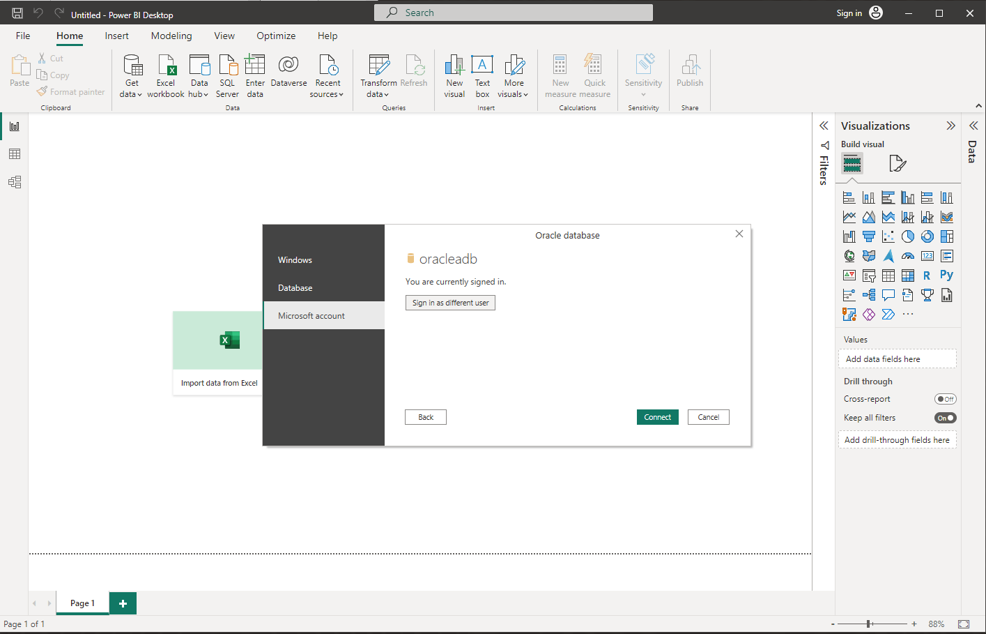

If successful, Power BI Desktop indicates the user is now signed in. Click the “Connect” button to then connect to the Oracle Database.
A follow-on screenshot of the same Power BI desktop with a dialog box showing the text "You are currently signed in".

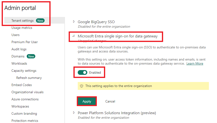

Enable Microsoft Entra Single Sign-on for Data Gateway
By default, MSEI SSO is not enabled for Power BI service tenancies. To enable it, go to the Power BI service Admin Portal from your web browser. Under Tenant Settings, toggle the Microsoft Entra Single Sign-on for Data Gateway option to “Enabled”. Click the “Apply” button.
Typically, users with the tenant administrator Azure role can make this tenancy change.
This is a screenshot of the Azure tenancy admin portal. Tenent settings is selected on the left side menu. On the right, the option for Microsoft Entra single sign-on for data gateway is shown. The button has been toggled to "Enabled" and the "Apply" button has been emphasized.
This privilege allows you to use MSEI SSO with Oracle database and ADB.

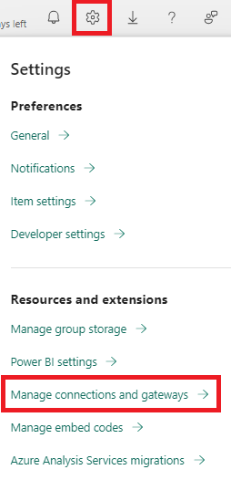

Let’s walk you through how to connect Power BI service with Oracle database. On the Power BI service page, click the Settings icon in the upper right side of the browser page, then click on “Manage Connections and Gateways”
.Screenshot of the Power BI service page. The gear icon for "Settings' is emphasized. The settings menu is shown below and the "Manage connections and gateways" link is emphasized

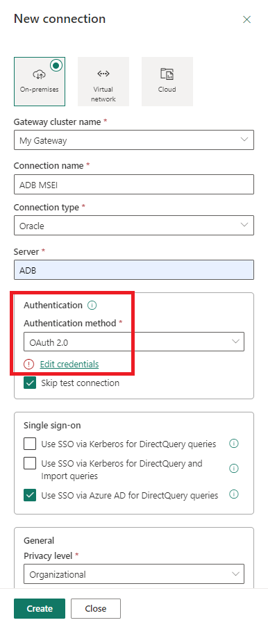

Click “New” on the menu on the upper left part of the web page to start creating the connection. A “New Connection” dialog appears in which you will configure the Oracle connection via the data gateway.
Choose “On-premises” for the connection type. This applies even for cloud databases, such as Oracle Autonomous Database.
For the Gateway Cluster Name drop down, choose the name you gave your on-premises data gateway installation.
For Connection Name, provide a name to easily identify the connection.
For Connection Type, choose “Oracle”.
For Server, enter the net service name in your tnsnames.ora file that matches the database or ADB instance you wish to connect to. You can alternatively provide the entire connect descriptor or an Easy Connect Plus entry.
For Authentication, select OAuth 2.0 for the Authentication Method. Then, click the Edit Credentials link and log in to your MSEI account.
Under “Single Sign-on”, check the box for “Use SSO via Azure AD for DirectQuery queries”.
Finally, click the “Create” button to create the connection in your Power BI service account.
The "New connection" window is shown. On-premises is selected at the top. Gateway cluster name is "My Gateway"
Connection name is "ADB MSEI"
Connection type is "Oracle"
Server is "ADB"
Authentication method is "OAuth 2.0" and is highlighted
Skip test connection checkbox is checked
Use SSO via Azure AD for DirectQuery queries checkbox is checked
Privacy level is set to Organizational.
The Create button is highlighted

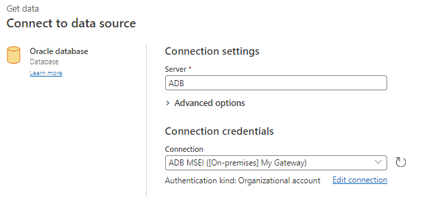

When you create a data flow, you will need to select the Oracle data source connection to use. Navigate to the Connect to Data Source dialog. For Server, enter the same identifier you used when creating the connection in the previous step. In our example, used the net service name entry, “ADB”.
For the Connection drop-down, choose the connection you just created.
The "Get date", "Connect to data source" window is shown.
The icon for Oracle database is at left.
On the right, the Server field is set to "ADB"
And the Connection credential is set to use the connection "ADB MSEI ((On-premises) My Gateway)
Click the Next button.
