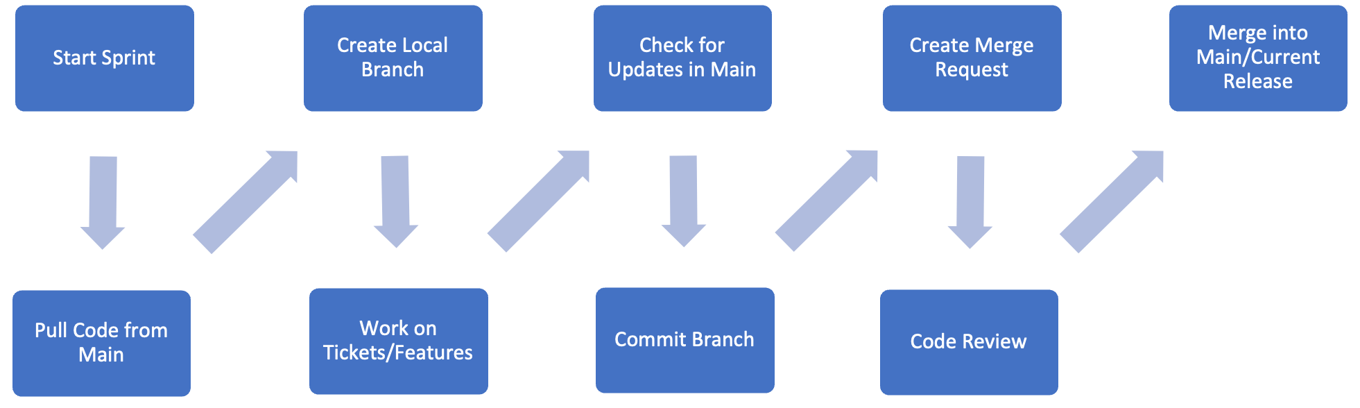

When does Continuous Integration start? When the tasks are handed out, each developer will copy the code from the latest release in a repository and create their own copy or branch. This latest code release is an exact copy of the code that is currently deployed and running in production. Each developer will also be given a personal development database, more on this later. As the developers finish the tasks they were assigned, they commit their code branch to the repository. Before they create a pull request/merge, they check the current main branch of code in the repository for any changes from other developers merging clean code branches. If found, they will pull these changes down and commit their code again. One of these changes might have affected their code in a negative way and the build process that occurs when a pull request/merge happens will catch this. A code review is scheduled and if accepted, the developer can now create the pull request/merge into the main branch. There is also a build process that occurs every time code is merged into main to catch any bugs or issues that may show up or issues that other developers code may have caused. If so, the issues are addressed, a pull request/merge is created, and the automated testing again happens. Once the testing comes back clean, the code can be merged into the main branch.
Summary Points:
  • Start Sprint
  • Pull Code from Main
  • Create Local Branch
  • Work on Tickets/Features
  • Check for Updates in Main
  • Commit Branch
  • Create Merge Request
  • Code Review
  • Merge into Main/Current Release

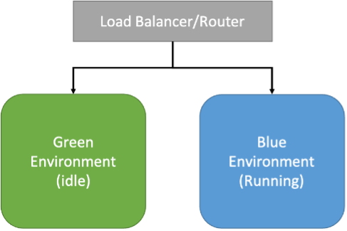

Continuous Integration works very well with stateless files and deployments; static files such as java classes or JavaScript combined with a stateless container deployment; in with the new and out with the old. It very easy to create a new deployment in a docker container with the latest code and replace the old container if working with stateless files.
We see this with blue-green deployment models. In this model, you have your running application container, the blue. The green is your idle newly deployed application container. As some point you switch to the green and all traffic is now using the new version while the blue one is idle. If you need to roll or switch back, you just change back to the idle blue container.
We quickly see these models are not going to work for database deployments. The database has state, transactions are being committed all the time so unless we can afford downtime to copy the entire database, deploy the changes and then resume operations, this poses a challenge. And because of this challenge, DBA’s and database developers are all too often blamed for these deployment bottlenecks. They are often told that databases can never do DevOps let alone CI/CD, it’s too legacy. Where does this leave the DBA and Database Developer? They will be branded with a legacy stigma and seen as a roadblock to CI/CD.

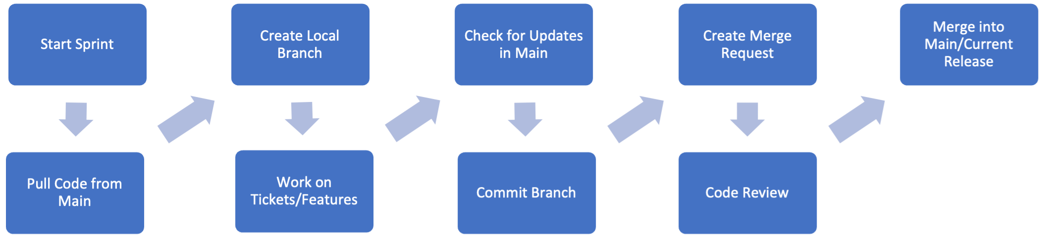

Let’s refer to our process flow and see where we can add database development specific steps:
The sprint starts and we have our database developers pull the latest code from the latest release. Where is this code? What tools can we use to allow developers to have local copies of our database code? We use a Code Repository.

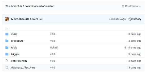

Then we push the new code up to our repository. This push will be slightly different because we are pushing to a branch now. If you issue a git push, you will see something similar to below:
> git push
fatal: The current branch sprint1_brian.spendolini has no upstream branch.
To push the current branch and set the remote as upstream, use
    git push --set-upstream origin sprint1_brian.spendolini
So we need to issues the push with our branch this one time:
If you go into the GitHub web UI, you can see in this repository that a new branch has been created and that only the table file has been updated as expected.
The other files which contain the procedure and trigger code have not been changed. Again, Liquibase is tracking the changes for us, and we can see it in action here.

Now, we can move to our development branch and apply that to this schema. Exit out of SQLcl:
SQL> exit
Change branches (remember your branch will be named different, unless you are a clone of me with the same name..if so email me please):
> git checkout sprint1_brian.spendolini
Switched to branch 'sprint1_brian.spendolini'
Your branch is up to date with 'origin/sprint1_brian.spendolini'.
And log back into the database as this test user:
> sql /nolog
SQL> set cloudconfig /Users/bspendol/Downloads/Wallet_ADB.zip
SQL> conn test@ADB_high
And now, using our development branch, we will apply the changes to this schema:
SQL> lb update -changelog controller.xml
ScriptRunner Executing: table/trees_table.xml::f81a149311b20a5a1dfe95a35108b8728df33b7f::(DEMO)-Generated -- DONE
######## ERROR SUMMARY ##################
Errors encountered:0
######## END ERROR SUMMARY ##################
There are 2 tables that Liquibase uses to track changes, DATABASECHANGELOG and DATABASECHANGELOG_ACTIONS. There is also a view that combines these tables for a more readable format, DATABASECHANGELOG_DETAILS. If we take a look at the DATABASECHANGELOG_DETAILS view, we can see that only an alter table was done and that the table was not dropped and recreated in the SQL column:
SQL
ALTER TABLE "TREES" ADD ("TREE_PICTURE" BLOB)
This would be not only the behavior you would see in say a production instance, but more importantly the behavior you would expect a change management tool to be executing.
