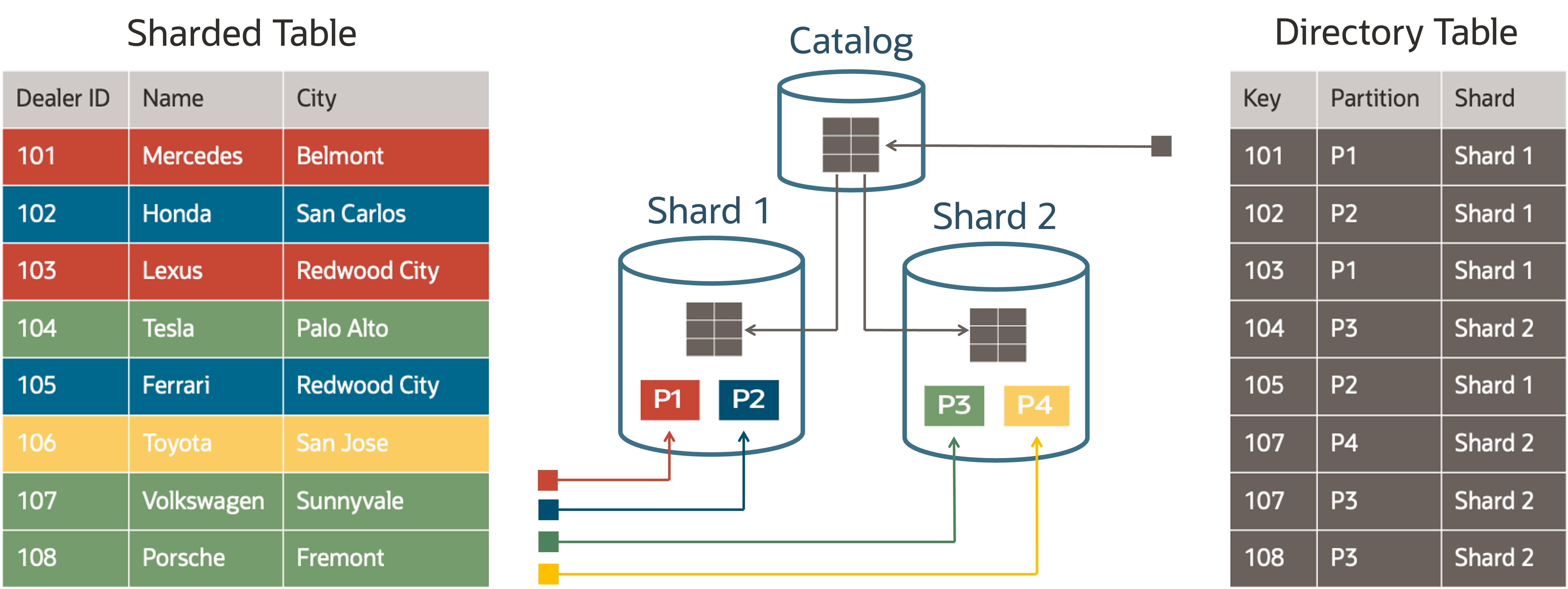

The following figure shows the key components of directory-based data distribution. The directory table is hosted on the catalog, and is duplicated to all of the shards. The sharded tables are distributed across different shards based on the key/partition mappings in the directory table.
Directory-Based Data Distribution
                                                                                  Directory-Based Data Distribution Architecture
Key insert and update operations are performed on the catalog and synchronously duplicated to the shards at commit time.
Client pools fetch the key to chunk/shard mappings from each shard the same way as in other sharding methods. They also subscribe to FAN events that notify them about new key mappings or deletions.

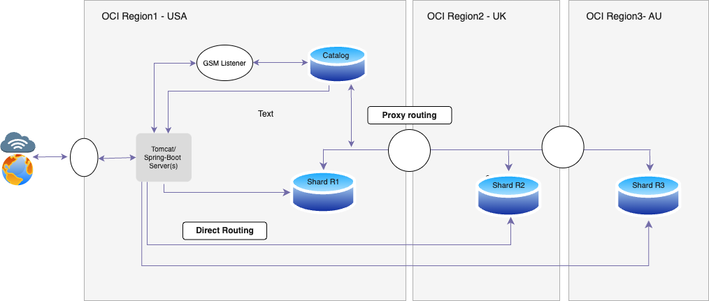

Directory-based data distribution can be implemented to achieve data sovereignty by data localization and avoiding privacy violations. Data is stored in shard databases based on defined sharding keys in the directory table assigned to particular partitions. Cross-shard queries can be performed from the catalog database to retrieve data from all shard databases. Therefore, application super users (who require access to the the entire dataset) can get full control of data (read-write permissions) including for reporting purposes from the catalog database. The application can connect to the catalog database or directly to shards based on the requirements.
App Modernization with OCI + Oracle 23ai Globally Distributed Database + Directory-Based Sharding for Data Sovereignty
How to Implement Directory-Based Data Distribution to Achieve Data-Sovereignty
Let’s learn how you can achieve data sovereignty using multiple sharding keys? With Directory-based data distribution implementations, sharding keys can be defined and managed at run-time.
