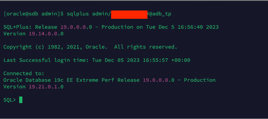

Before creating the Database Link, ensure you have connectivity to your ADB-D, either copying Wallet into your source Oracle Database or using a Walletless connection. Here’s a quick walkthrough (Lab 2: Configure a Development System) to help you with the download and transfer process.
Configuration:
Adjust your tnsadmin and sqlnet.ora settings on your source Oracle Database and make certain you can seamlessly SQLPLUS into the Autonomous Database – Dedicated.

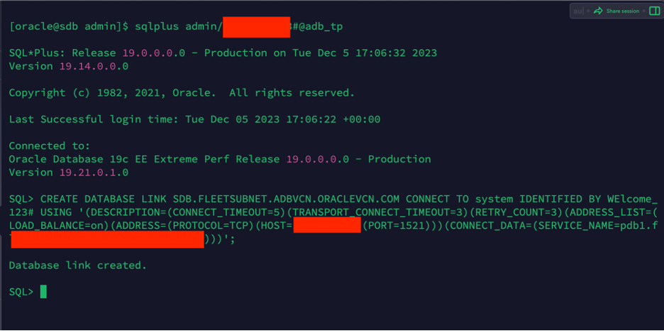

Database Link Creation:
Execute the following command:
CREATE DATABASE LINK <Source_Database_global_unique_name> CONNECT TO system IDENTIFIED BY <SourceDB_password> USING ‘<Connect_string_Source_DB>’;

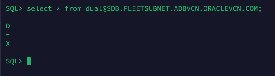

Testing:
Confirm the functionality of the newly created Database Link with this simple test:
select * from dual@<Database_Link>;

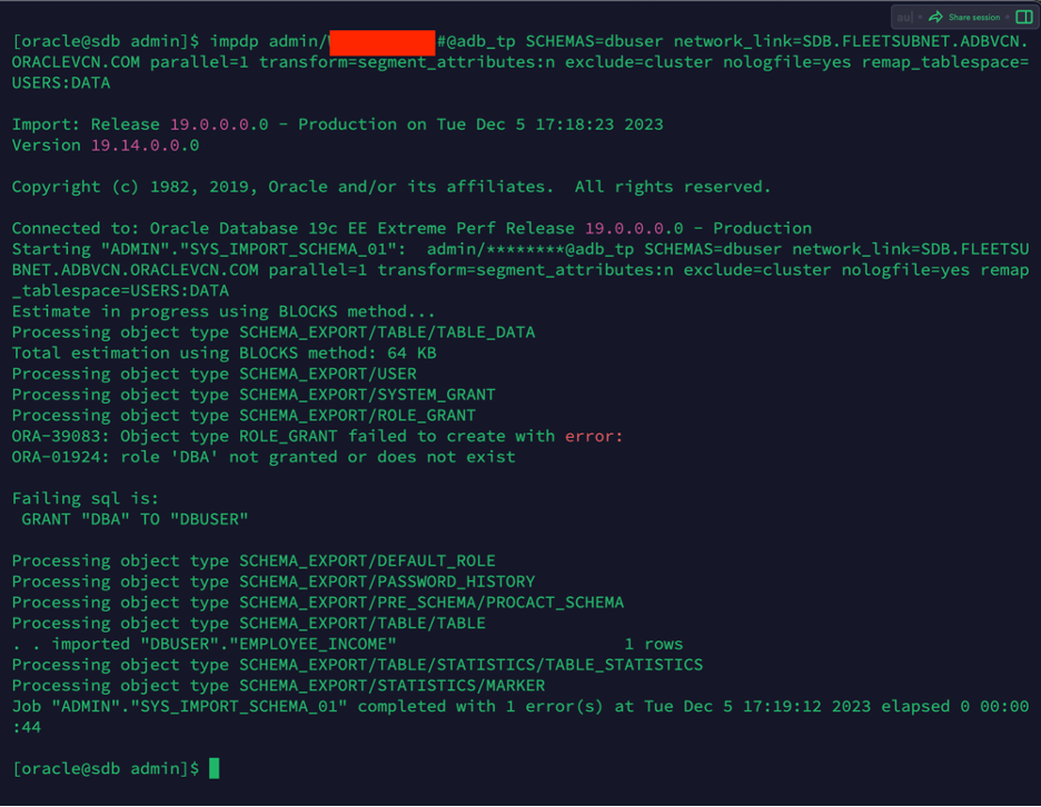

Determine which schemas you’d like to migrate. Once decided, initiate the Import Data Pump from your source Oracle Database with the following command:
impdp admin/<ADB_Password>@adb2_high SCHEMAS=<schemas> network_link=<Database_Link> parallel=1 transform=segment_attributes:n exclude=cluster nologfile=yes remap_tablespace=USERS:DATA
Note: Post-migration, you may occasionally encounter ‘Role grant failed’ errors. This is because ADB-D restricts access to SYS, SYSTEM, or DBA. For in-depth information and best practices to avoid such pitfalls, refer to our comprehensive guide.

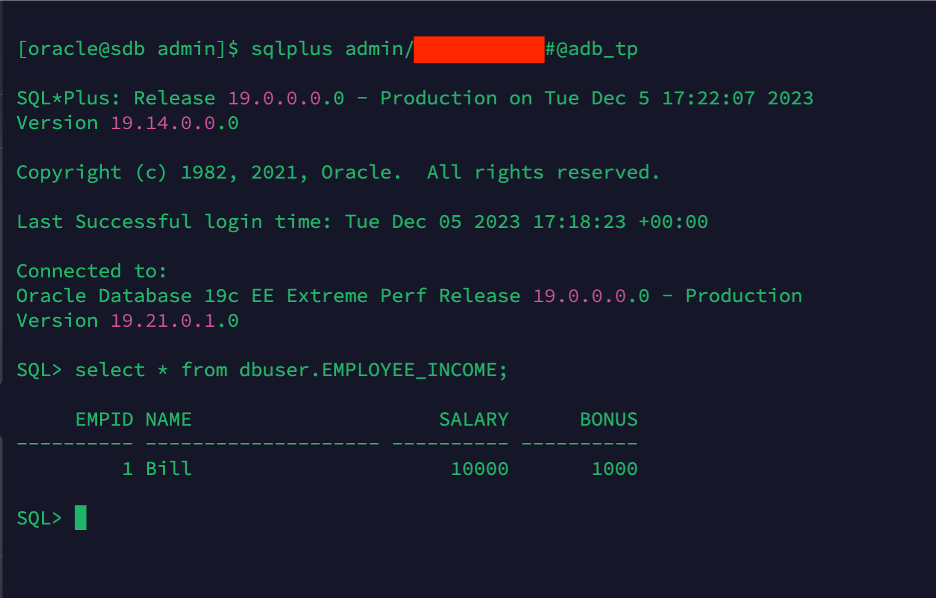

Verification:
After the migration, SQLPLUS into your ADB-D to cross-check the migrated data. Simply select values from the table in question to confirm its presence.
And Voila! It works
