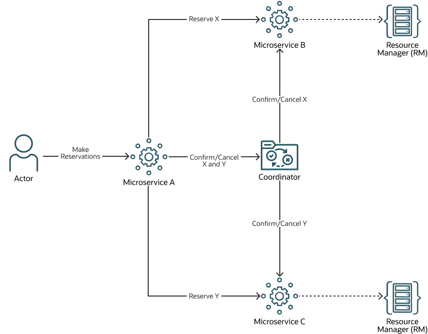

The basic flow is as follows:
  1. Transaction initiator starts the TCC transaction by making a MicroTx client library call
  2. Transaction initiator then calls participant 1
  3. Participant 1 makes the required reservation and returns the URI representing its reservation
  4. Transaction initiator then calls participant 2
  5. Participant 2 makes the required reservation and returns the URI representing its reservation
  6. Initiator calls the transaction coordinator with the list of reservations to Confirm or Cancel the reservations
  7. The transaction coordinator then calls PUT to confirm or DELETE to cancel on all the URIs (reservations) to complete the transaction
Try-Confirm/Cancel
Try Phase
During the try phase, all accepted reservations are collected in headers by the MicroTx library.  This includes reservations made indirectly by microservices called by the initiator.  By the time the initiator (in the case above, Microservice A) has completed making reservations with Microservice B and Microservice C above, the MicroTx library has collected all the reservations in headers.  At this point the initiator can decide to Confirm the reservations, Cancel the reservations, or ignore the reservations letting timeouts eventually cancel the reservations.
