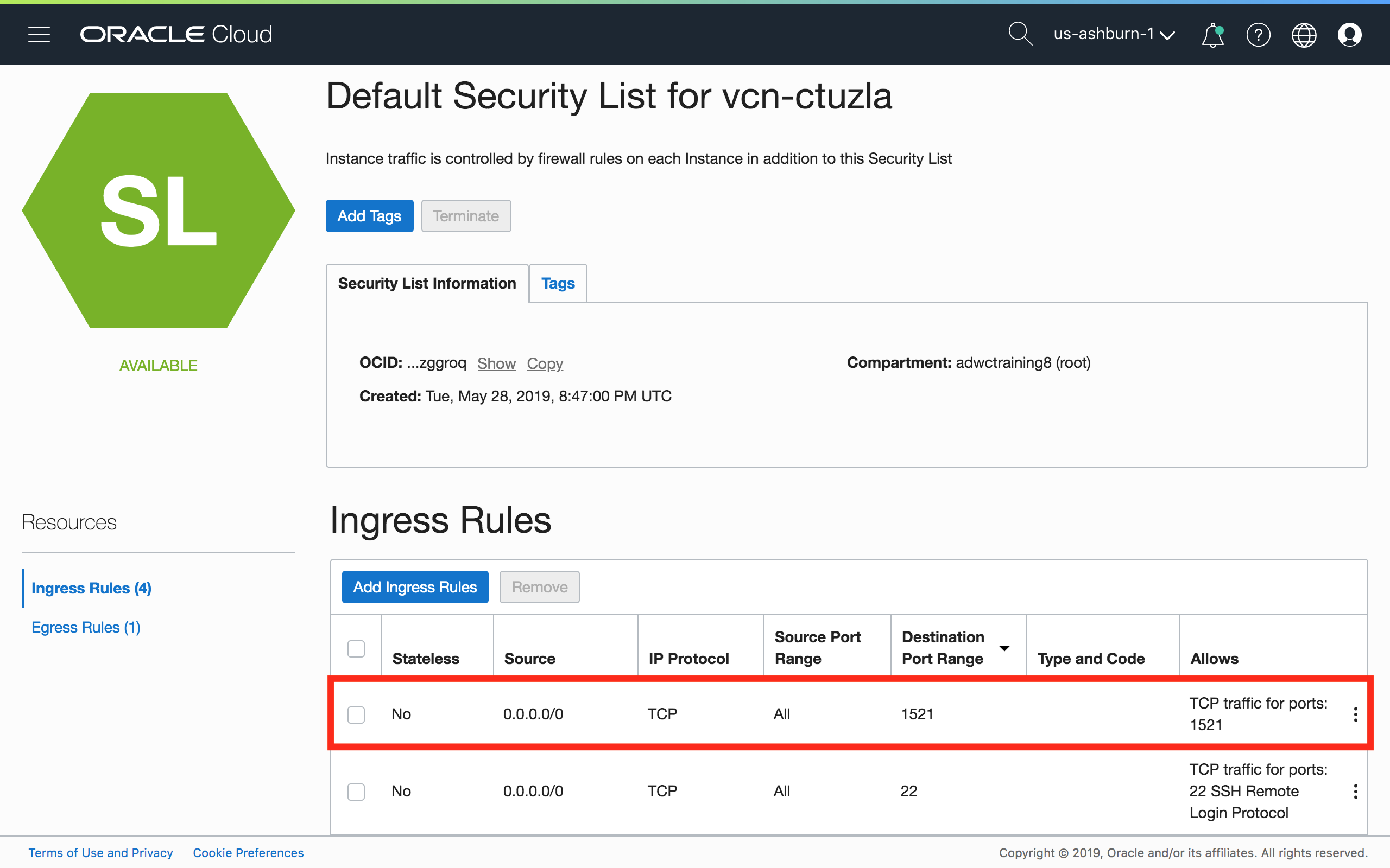

In order to connect to the DBCS instance from the client, you need to add an ingress rule for the port that you want to use (e.g. 1521) in the security list of your virtual cloud network (VCN) in OCI as shown below:
