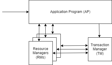

The XA standard for Distributed Transaction Processing defines the model and the protocol that occur between the Application Program (microservice), the Transaction Manager, and the Resource Managers (databases).  The basic flow is:
  1. Application Program asks Transaction Manager to start a transaction
  2. Application Program updates one or more Resource Managers
  3. Application Program asks Transaction Manager to commit the transaction
  4. Transaction Manager asks each Resource Manager to prepare, meaning be ready to commit when asked
  5. If all Resource Managers successfully prepare, then the Transaction Manager tells all Resource Managers to commit
  6. If a failure occurs before the decision to commit by the Transaction Manager is made, all Resource Managers will be asked to rollback
While the above is greatly simplified, it shows the general flow.  From the XA Specification:
XA Model

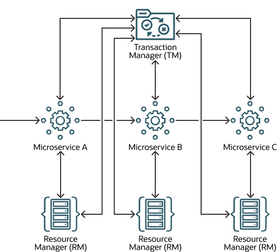

If we replace the monolithic application program with a set of microservices, we will see something like the following picture.  A client or other microservice calls A, which starts the XA transaction by calling the Transaction Manager.  A’s business logic updates its resource manager and calls B which also calls the transaction manager to enlist in the transaction.  B’s business logic does some updates to its resource manager and calls C.  Likewise, C calls the transaction manager to enlist in the transaction and its business logic updates its resource manager.  Finally, A calls the transaction manager to commit or rollback the transaction.  The transaction manager then prepares and commits A, B, and C’s resource mangers or rolls them back.
XA with microservices
Which is a little complicated and we’ll explain how this can be simplified using Oracle Transaction Manager for Microservices (MicroTx) in my next post.

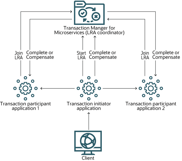

In this picture we can see Sagas look a lot like XA transactions, but with some significant differences.  First in Sagas, there isn’t any notion of a resource manager.  Another difference is that all the participants use local transactions during the Saga execution instead of a distributed transaction.  However, the most significant difference is that the microservice must provide application logic to complete or compensate its part of the Saga.  Compensating the microservice’s part of the Saga can become quite complicated as the microservice’s state may have changed due to other Sagas by the time it comes to compensate.  How and what completing or compensating means and performed is completely up to the application.  This in contrast to XA transactions where the infrastructure takes care of committing or rolling back the state of the involved resource managers.
The basic flow for Saga is:
  1. Initiator calls the transaction coordinator to begin a Saga
  2. Initiator calls one or more participant microservices
  3. The participant microservices enlist in the saga by calling the transaction coordinator to provide their complete and compensate URIs.
  4. The initiator then calls the transaction coordinator to complete or compensate the saga
  5. The transaction coordinator calls each participant’s complete or compensate URI
LRA transaction flow

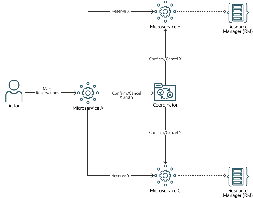

Try-Confirm/Cancel
The Try-Confirm/Cancel transaction model relies on a specific application pattern where microservices provide reservations of resources that will later either be confirmed or canceled.  Confirming a reservation means that the resource is now owned by the caller, whereas canceling the reservation means the resource is put back into inventory.  It is a two-phase transaction model that doesn’t require locking and the risk of deadlocks or performance issues.  However, it is only suitable for application that use a reservation of resources model.
The basic transaction flow for Try-Confirm/Cancel is as follows:
  1. Initiator calls the transaction coordinator to begin the Try-Confirm/Cancel transaction
  2. Initiator calls one or more participants to make reservations
  3. Participants make the reservation and return a URI representing the reservation
  4. Initiator calls the transaction coordinator to either confirm or cancel the transaction
  5. The transaction coordinator then confirms or cancels all of the reservations using PUT or DELETE
TCC transaction flow
