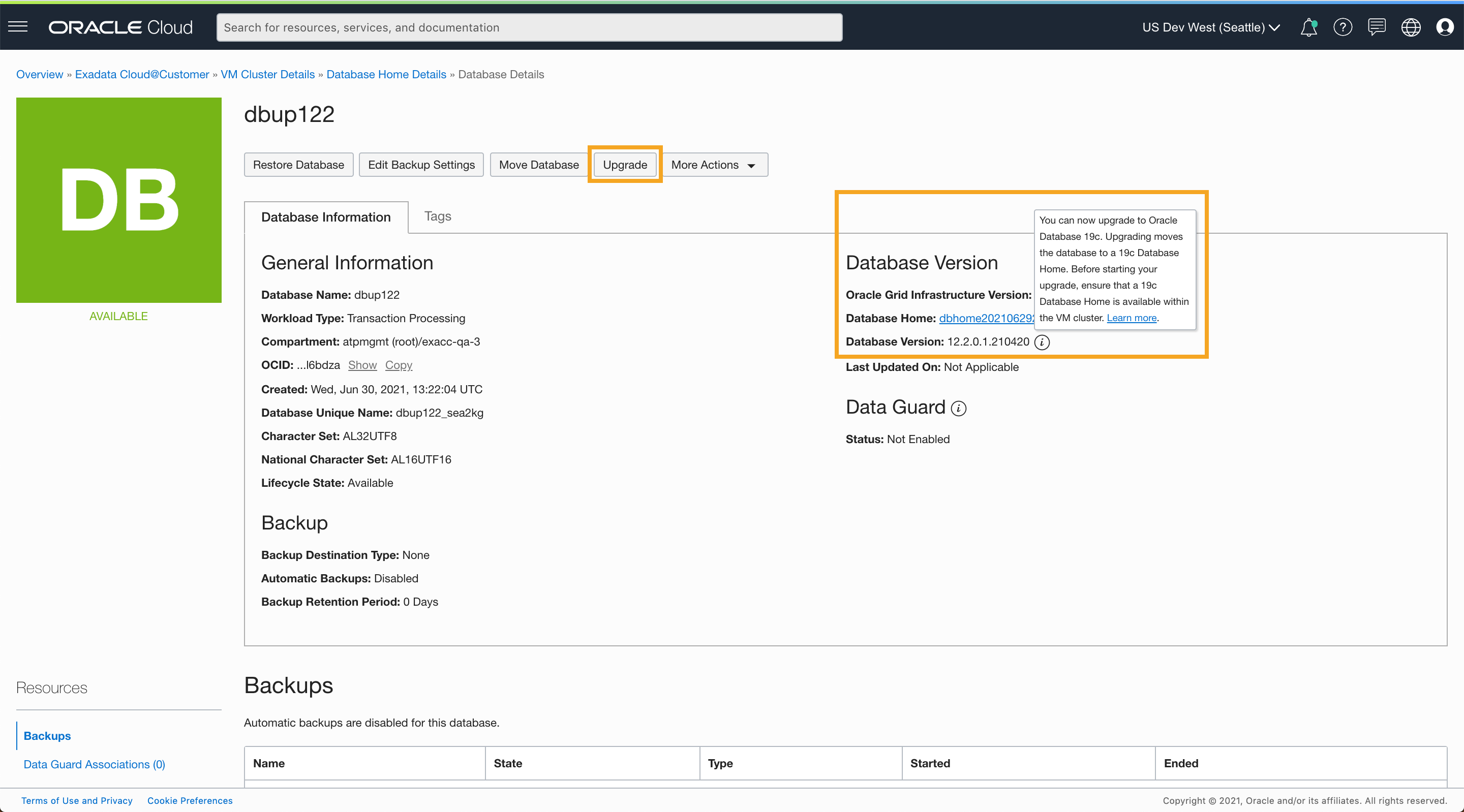

From the database details page, you can initiate an upgrade to the 19c version. If your database version is older than 19c, the upgrade eligibility is part of the toot tip next to the database version and recommends an upgrade. For database versions nearing the end of support like 11.2 and 18c, an additional banner at the top of the database details page reminds you to upgrade to 19c before the support for your version runs out.

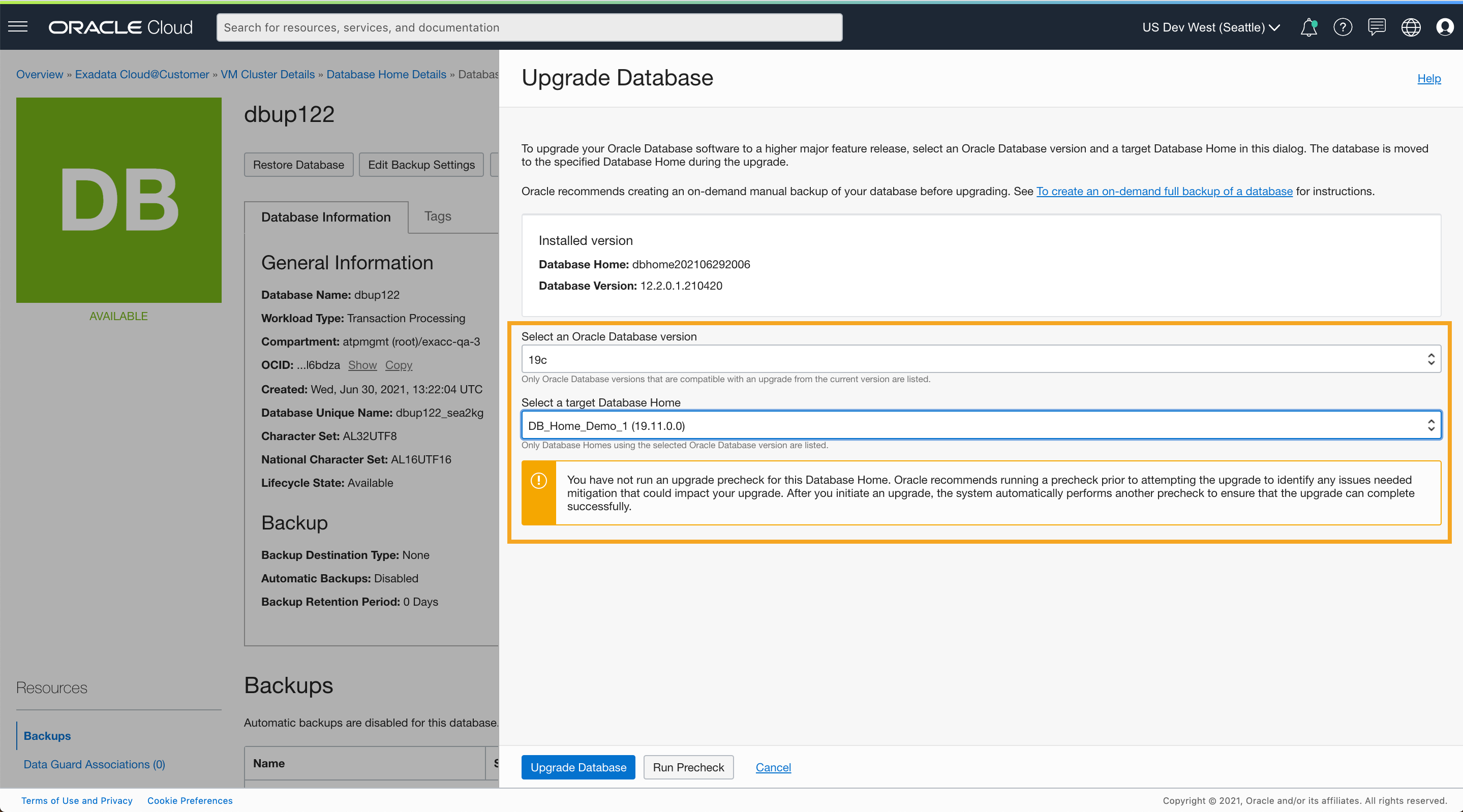

As part of the upgrade flow, you can select a target database home running 19c database version. If a database upgrade precheck was never done for this target database home, you will get a warning message to run a precheck as part of the upgrade workflow. If you have already run a precheck using this target home, the workflow will show the successful precheck timestamp as you prepare to upgrade. If your prior precheck failed, you get a warning message to address issues identified by the precheck and run precheck again before upgrading your database.
Running a successful precheck before a database upgrade to 19c is not mandatory but is highly recommended. Running a precheck does not incur any downtime and does not affect the availability of the running database workloads.

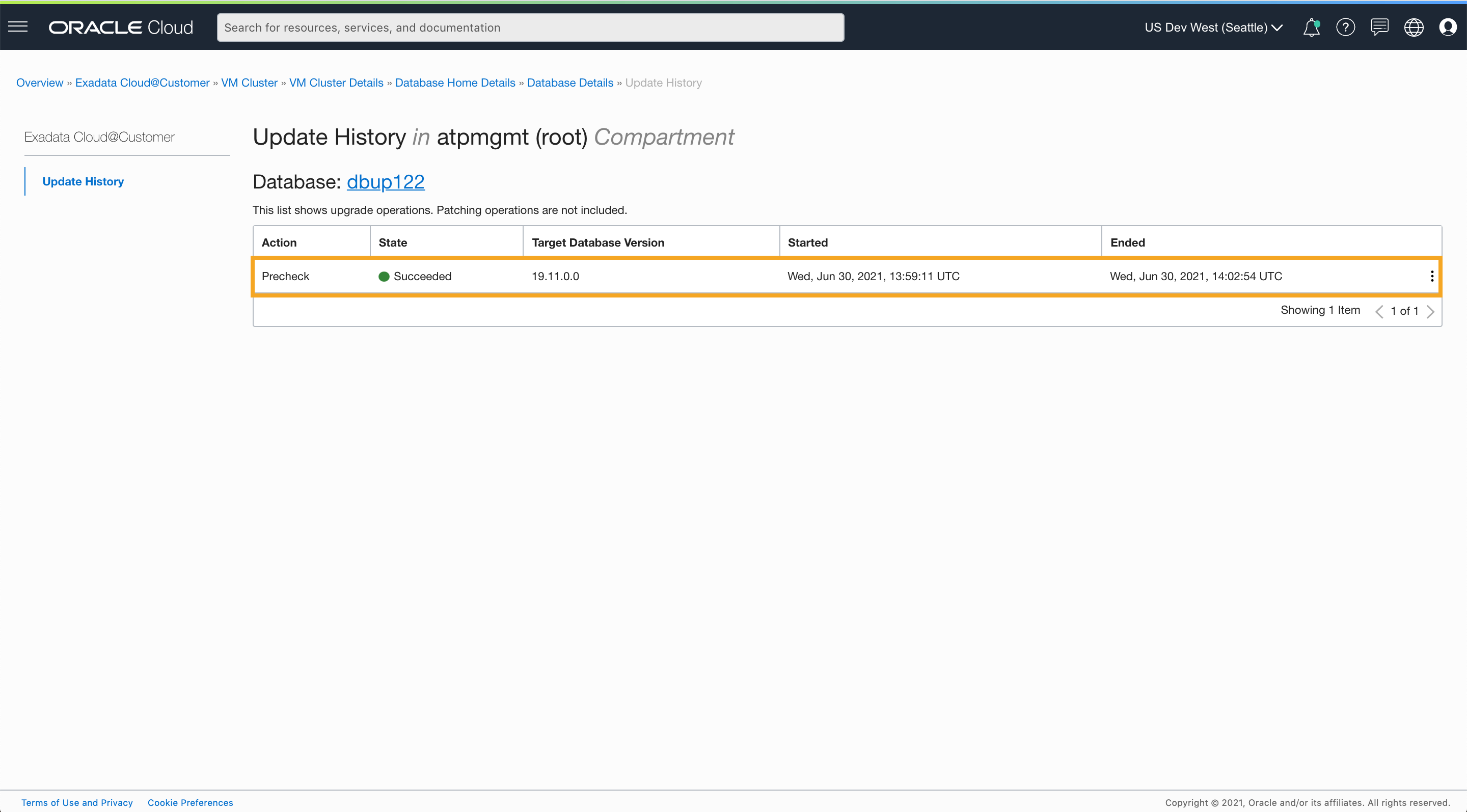

You can view the results of the precheck through the update history of your database. A successful precheck helps ensure the target home is compatible and ready for the database to upgrade and move. In case of a failure, you can take corrective action to resolve the issues found during precheck before proceeding with an upgrade.

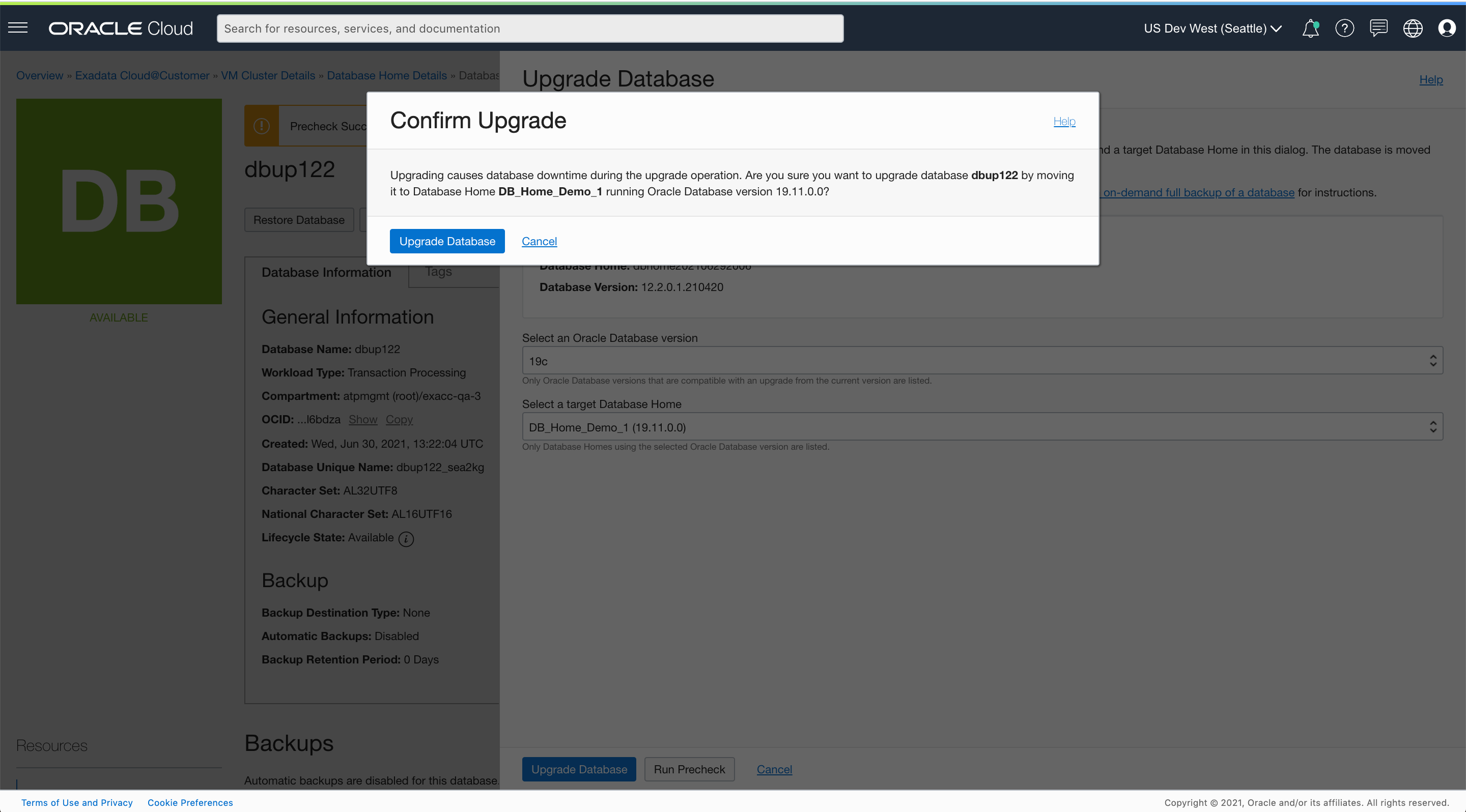

Once the precheck is successful (recommended but not required), you can upgrade the database using the selected 19c target database home. The upgrade will incur a database downtime, and you need to acknowledge this impact before proceeding with the upgrade.

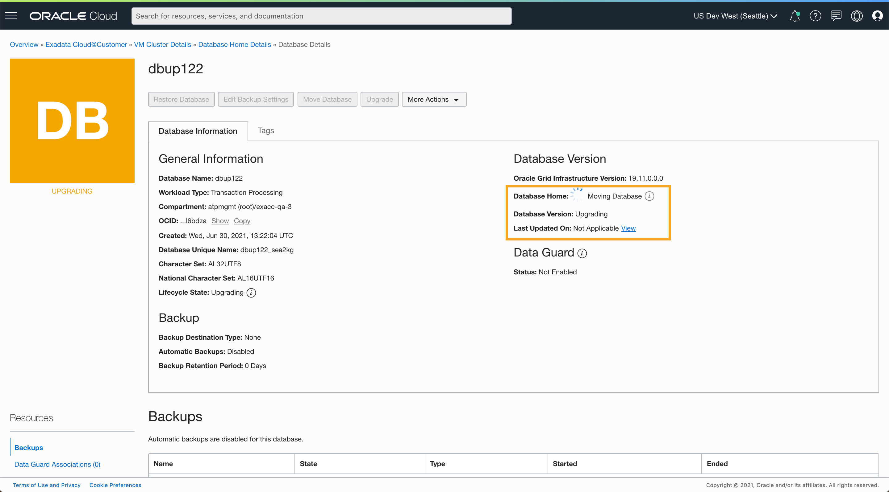

All database lifecycle actions are unavailable while upgrading. The database home field shows the database moving to a different home with the target home name and version displayed in the status tooltip while the upgrade is in progress.
Note: The upgrade flow always runs an implicit precheck to ensure compatibility and sets up a guaranteed restore point before running the Oracle Database Upgrade Assistant (DBUA) to upgrade. These details are visible through the work request for the upgrade flow.
