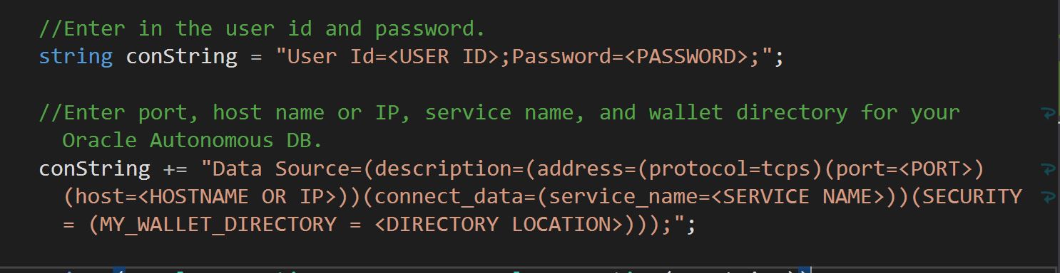

- In the autonomous-managed-odp.aspx.cs file, modify the User Id and Password credentials in the connection string specific to your ADB instance. We will first test connectivity locally before deploying the web app to Azure.
- On the next connection string line, modify the following settings for your ADB instance:
- Port (e.g. 1521)
- Host name or IP (e.g. hostname.oraclecloud.com)
- Service name (e.g. servicename.adb.oracle.com)
- Wallet directory (e.g. d:\wallets)
You will find these entries in the tnsnames.ora file from the downloaded ADB client credentials zip file.
The wallet directory must be set to the local machine directory where your ADB wallet file will reside. For this tutorial, we will copy the file to the web project’s root directory. You can thus set “MY_WALLET_DIRECTORY = .” (i.e. the website’s current working directory), which will be where the wallet is located when running this website both on-premises and on Azure.

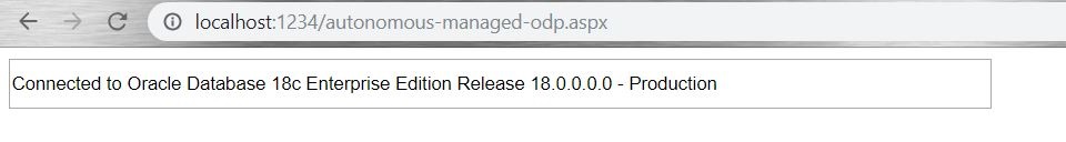

- Run your web application. You should see something similar to the following:
Congratulations! You are connected to Oracle Autonomous Database.

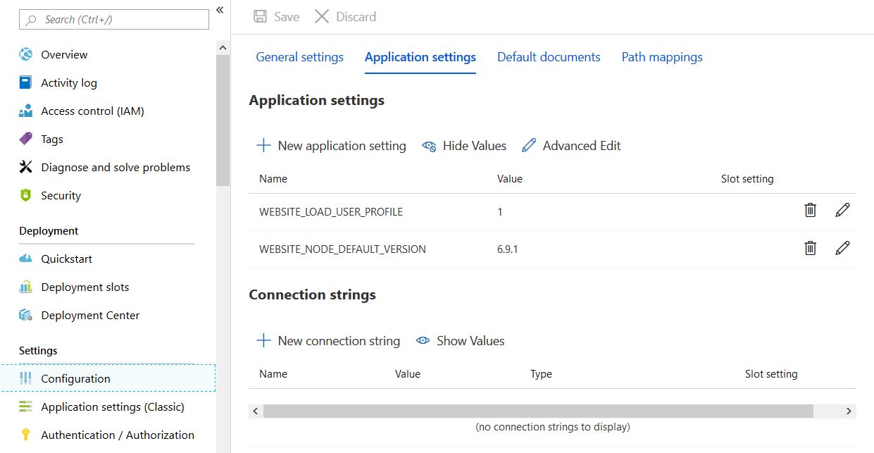

- Under Settings, click on the Configuration link, then click the Application settings tab. Add a new application setting, WEBSITE_LOAD_USER_PROFILE, and set it to 1. This step enables you to use the Oracle wallet on Azure. When completed, your setting will look like the following:
- Click on the Default documents tab to add autonomous-managed-odp.aspx as the default page to load for your website. Be sure to also delete hostingstart.html from the list to prevent Azure from loading this document by default.
- Save these settings before you leave the configuration page so that they take effect for your Azure website.

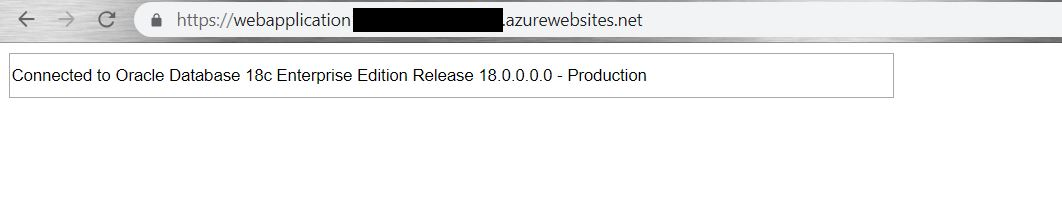

- Setup is now complete. Refresh the browser tab connected to your web app to verify your Azure Web App is now connected to ADB.
