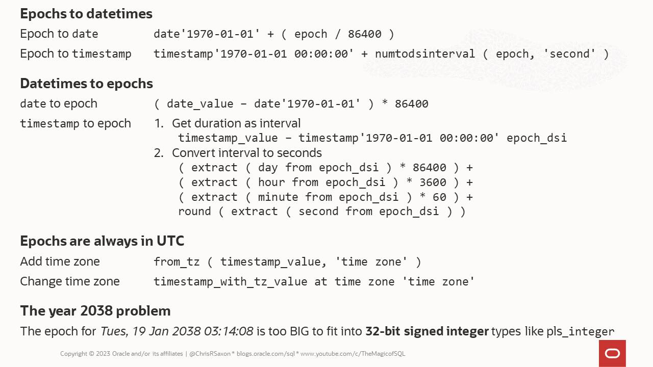

Epoch to datetimes cheat sheet
Here’s a cheat sheet summarizing the logic in this post
