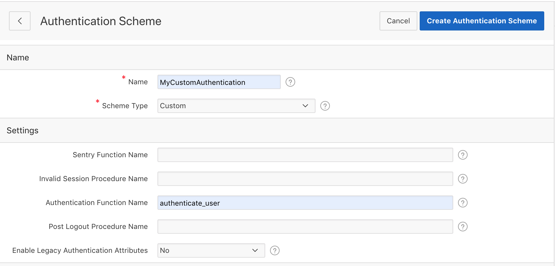

APEX provides you with a number of built-in Authentication Scheme types, including Application Express Accounts, Database Accounts, LDAP Directory, Social Sign-in, and others. However, as we’ve discussed, there are times when you’re going to want to roll your own. In this case you’ll want to use the Custom Authentication Scheme type.
Creating a simple custom theme based on our AUTHENTICATE_USER function and the underlying tables is actually pretty easy. Simply navigate to the shared components of your application, click on the Authentication Schemes link under Security and click Create >. At this point a wizard will walk you through the required steps.
Your first choice will be whether you copy an existing scheme, or create a new one based on one from the gallery. In our case we’re using the gallery, so clicking Next > will take us to a list of available schemes.
At this point you give your new Authentication Scheme a name (something like MyCustomAuthentication) and choose the scheme type (custom). The moment that you choose Custom as the type, you’re presented with a number of fields to fill in. Don’t get freaked out… You really only have to fill in one – the Authentication Function Name. In that field simply type authenticate_user and click Create Authentication Scheme.
NOTE: APEX assumes that the function you indicate for your Authentication Function takes in two parameters (P_USERNAME and P_PASSWORD) and returns a boolean that indicates whether the user has been successfully authenticated. That’s why you only need to provide the function name.
After creating the new Authentication Scheme, APEX automatically sets it as the default for the application. At this point you are no longer logging in to your application using your APEX user, but instead using the entries in your USERS table. Seeing as we only created one user (admin/admin) you should only be able to log in using that.

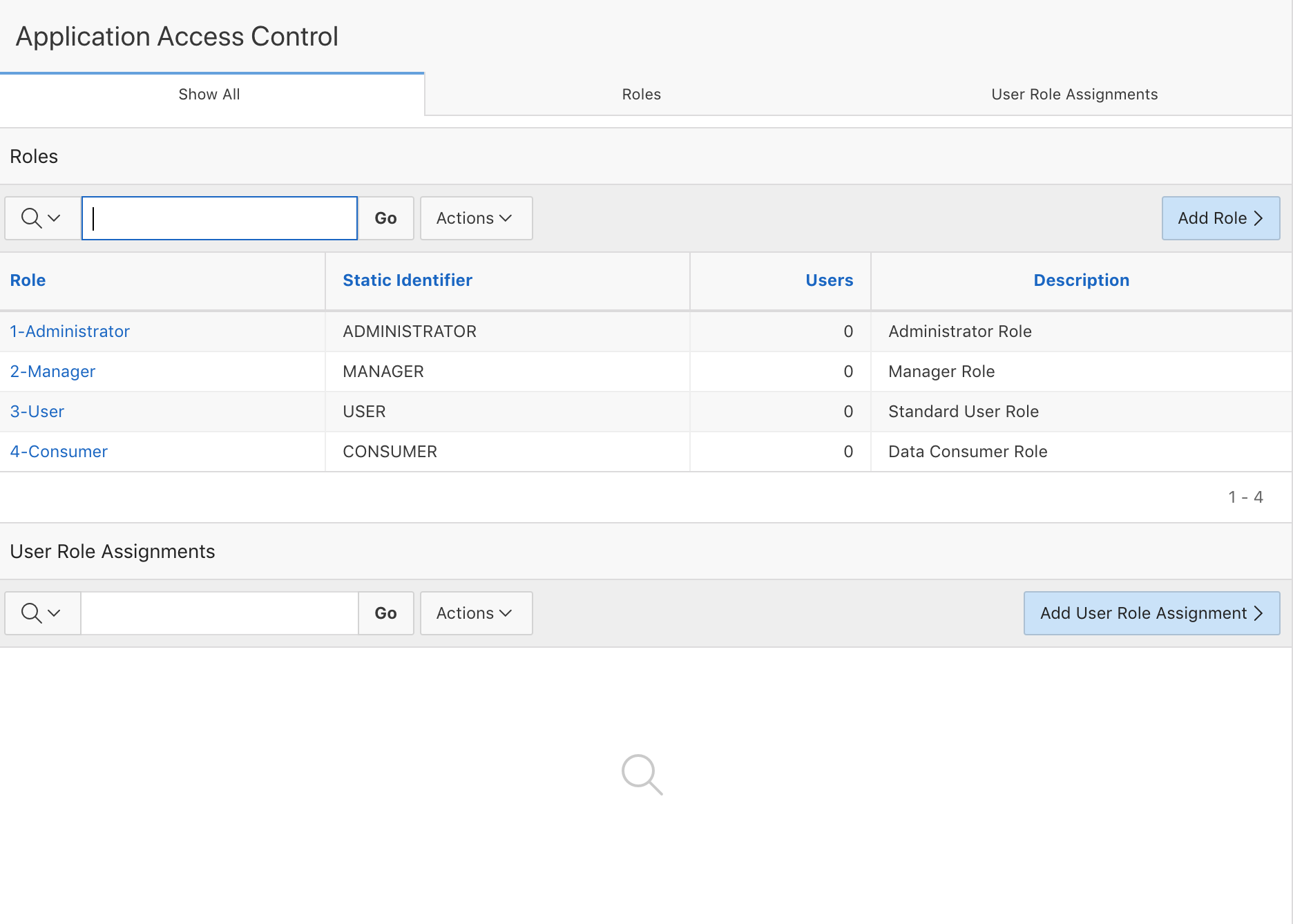

Application Access Control Roles
The first thing you’ll need to do is understand what authorization levels will need to be implemented in your application because this will define not only the roles you create in the Application Access Control shared component, but will also guide what Authorization Schemes you define and are able to apply to the various APEX components.
Most applications will have a static set of authorization levels. Although the example in this blog post is extremely simplified, as a basis this solution should work well for those circumstances.
* If you are in a situation where you are required to use a third party system to dictate authorization levels, or you for some reason need to implement dynamic levels, then your job becomes much more complicated and is far outside of the scope of this post.
For our example we’re going to use 4 different authorization tiers.
  • 1-Administrator
  • 2-Manager
  • 3-User
  • 4-Consumer
Although not much more complex than what APEX gives you by default, it gives us enough levels to see how we can create both Exclusive and Cascading authorization schemes.
To create these 4 roles in our sample application, we navigate to Shared Components > Application Access Control. From  there use the Add Role > button to add the for roles above. You’ll end up with something like this:
At this point we’re not going to enter any User Role Assignments as we want to make sure we do that through the app we’re building and that we only deal with users that actually exist in our USERS table. We’ll get to that a little later.

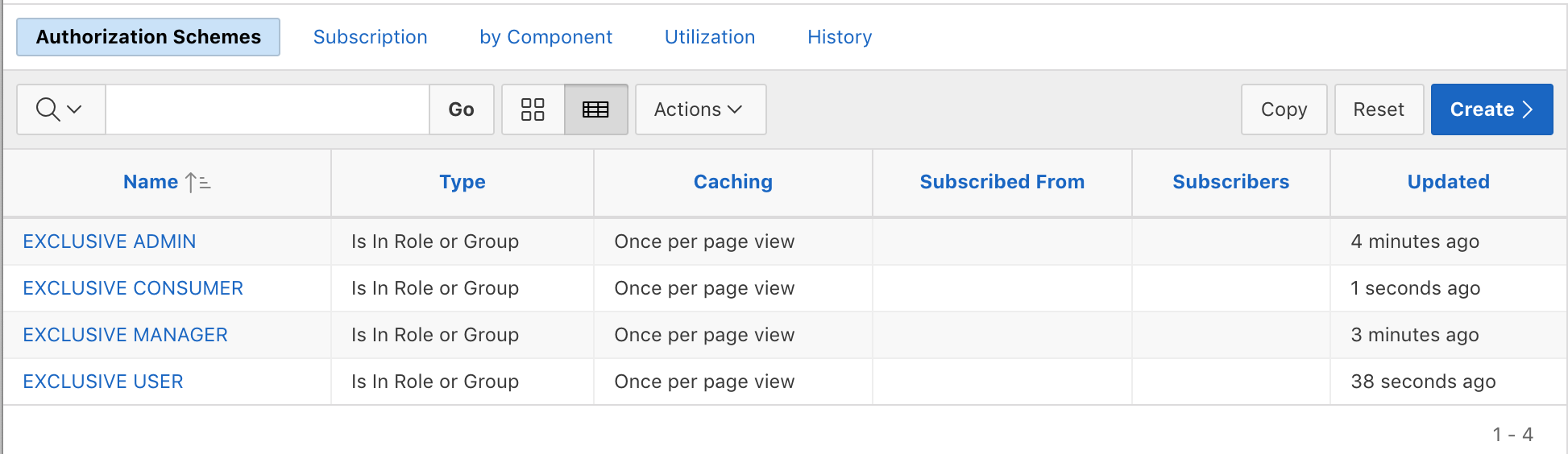

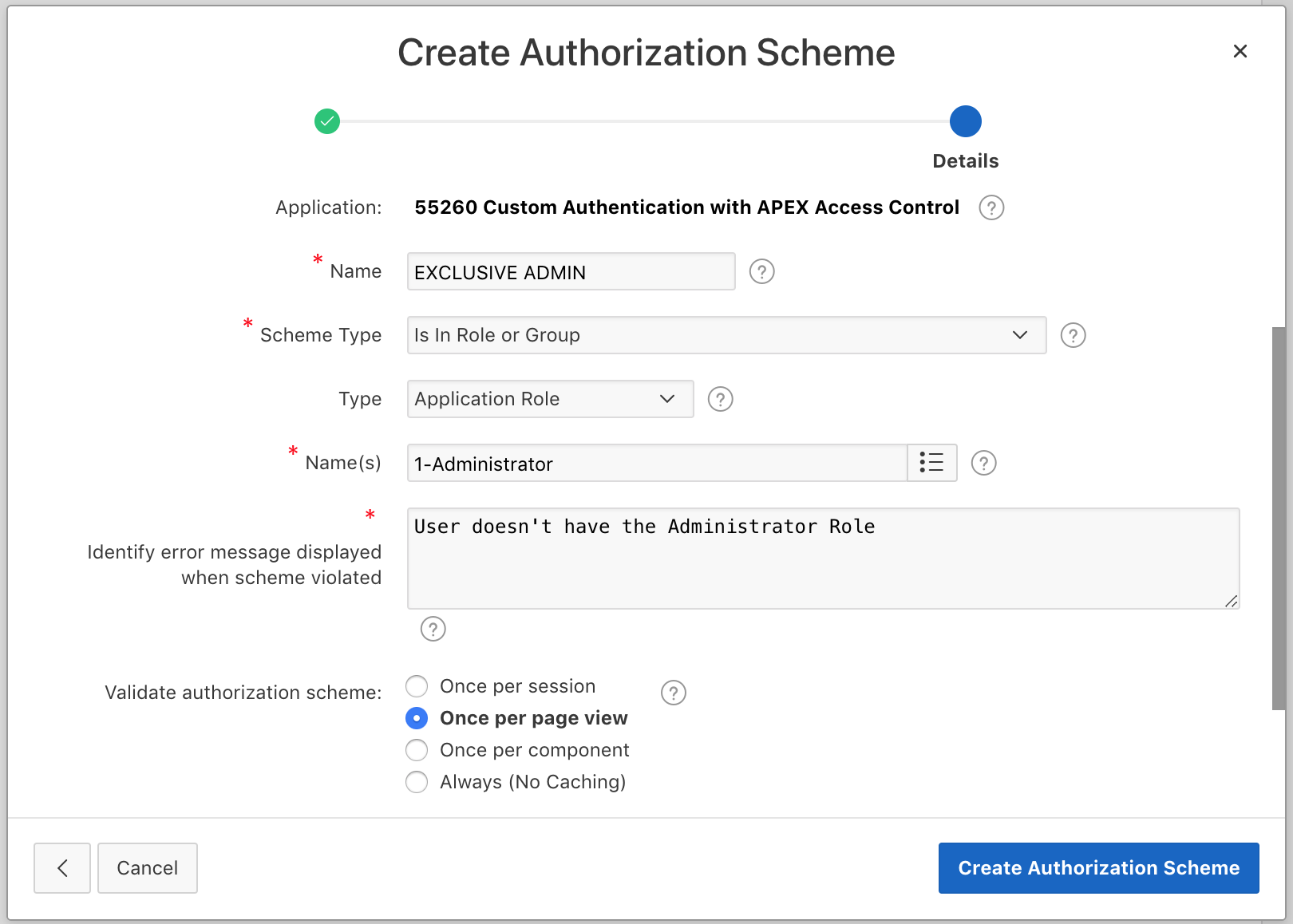

First let’s attack the Exclusive Set. If you navigate to your application’s shared components and then to Authorization Schemes, you may see that one called “Administration Rights” already exists. This is a default Authorization scheme that is created for the app that always returns TRUE. For our purposes, you can ignore it. But if it bothers you, you can delete it. We won’t be needing it.
To create the Exclusive Authorization Schemes that we need we can click on the Create > button and follow the wizard. We’ll be creating all of these From Scratch so simply take the defaults on the first page of the wizard and move on.
On the next page, enter the details of the Authorization scheme as shown in the following screenshot.
Going over the individual fields:
  • Name – Unique name for the Authorization Scheme. This should be descriptive enough that when you go to apply it to an APEX item, you know what you’re getting.
  • Scheme Type – Although there are lots of types here, we’re going to stick with Is in Role or Group.
  • Type – This further classifies the Scheme Type and here we’ll choose to use the Application Role types that we have already defined.
  • Name(s) – This allows you to select one or more Application Role to check for this Authorization scheme. For the purposes of this Exclusive scheme, we’re only going to choose 1 role.
  • Error Message – What error message do you want to display if the scheme is violated. For example, someone tries to perform an action that is tied to a role that they’re not a part of.
  • Validate – This dictates how often to validate the Authorization Scheme. I the real world the choice here depends on how restrictive you want your Authorization to be, how much logic may be built into the scheme itself, and how frequently the result may change. For our purposes we’re choosing once per page view because we’ll want to see any changes we apply without having to log out and back in.
If we continue to create 3 more Exclusive Authorization Schemes (one each for the Application Roles we have left) following the guidelines above, you end up with a list that looks like this:

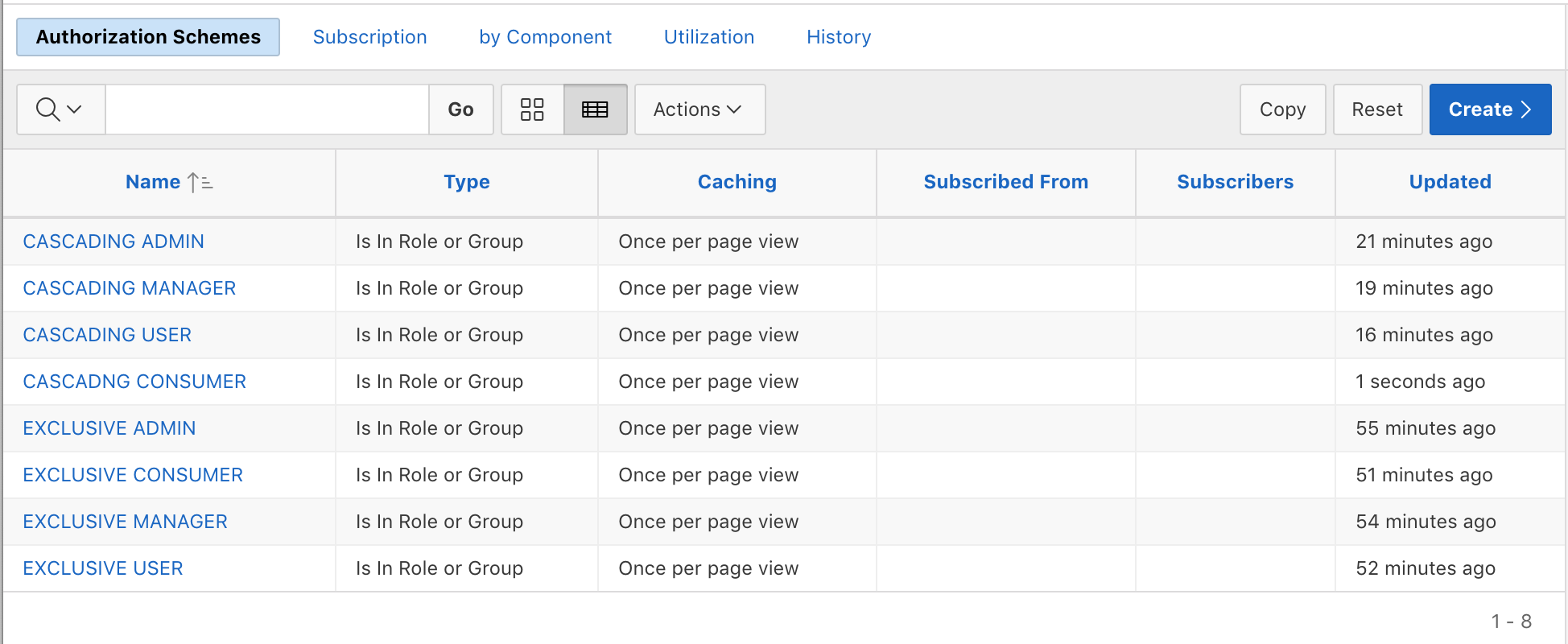

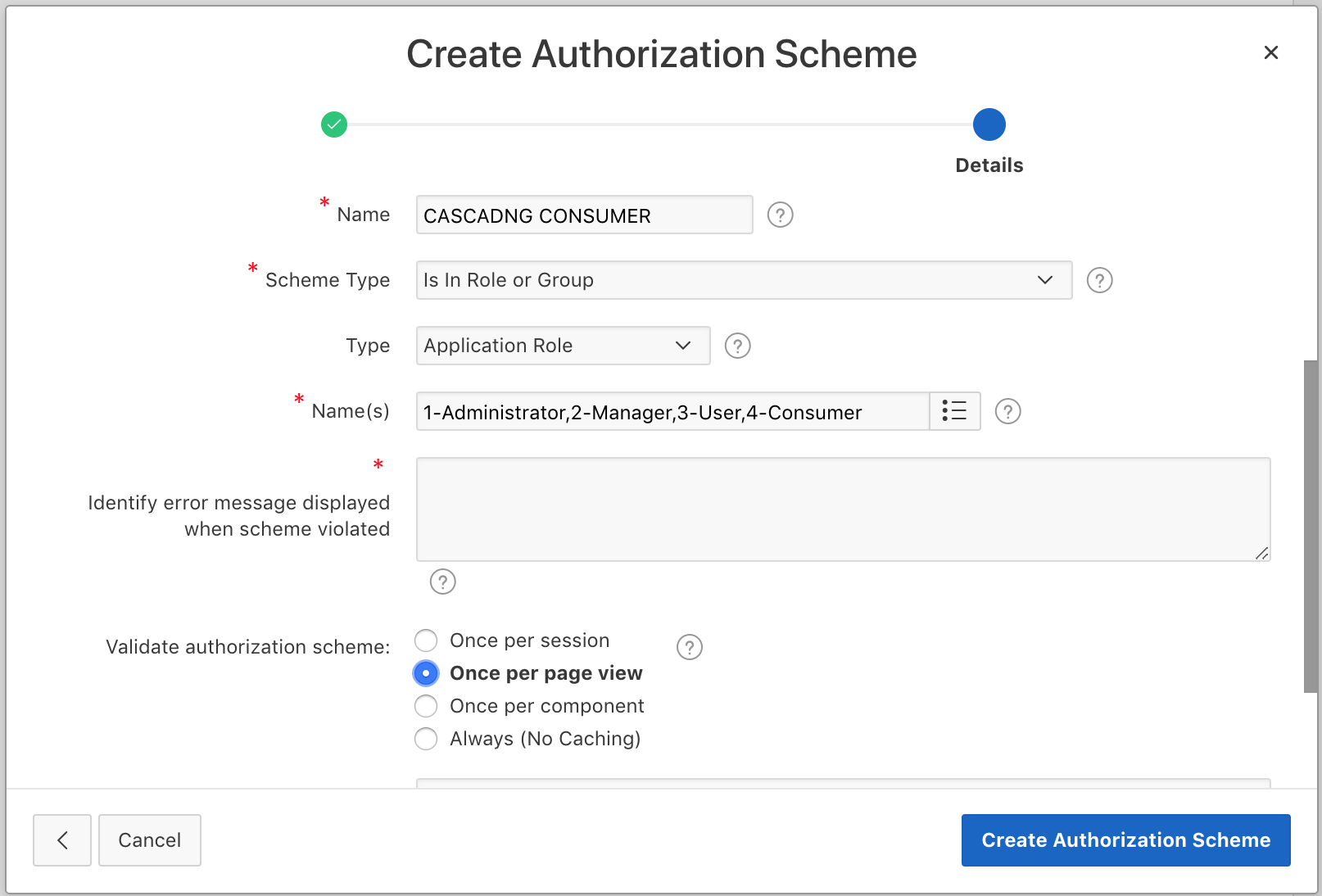

Now that we have our Exclusive Authentication Schemes let’s see how to create a set of Cascading Schemes. We use the same wizard and most of the same attributes, but one major thing will change; The list of names for the Application Roles we assign to each scheme.  Here’s the first one for Cascading Consumer scheme:
Notice in the Name(s) field we have a comma separated list of roles. The list of roles indicates that anyone who is assigned one of the listed roles may see the protected component. As you work your way up the ladder, the CASCADING USER Authorization Scheme would exclude the Consumer role, the CASCADING MANAGER would exclude the Consumer and User roles, etc. finally ending up with the CASCADING ADMIN Authorization Scheme that only references the Administrator role.
In the end you should have 8 Authorization schemes; 4 Exclusive and 4 Cascading.

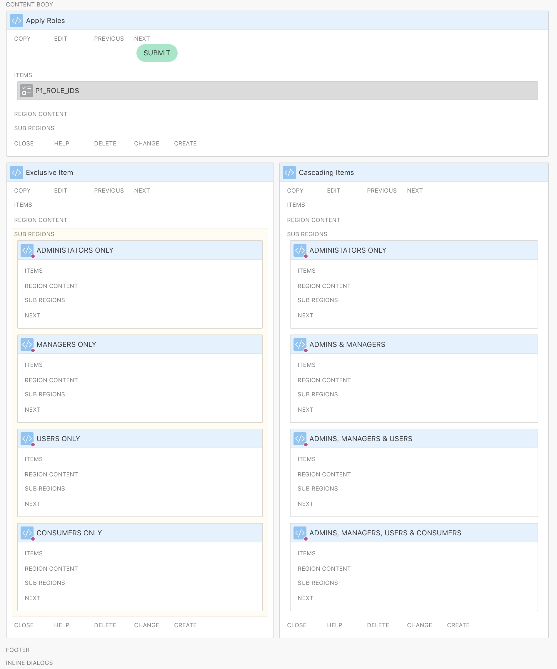

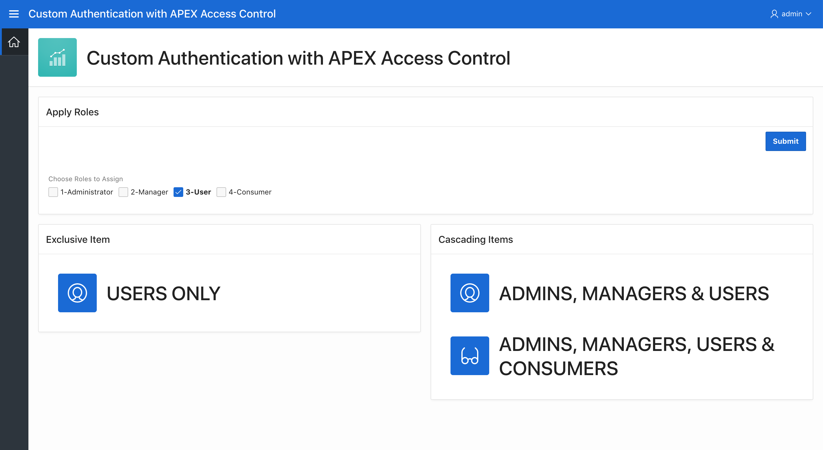

Now that we have all the back end components we need, we can create a UI that allows us to test it all out. For the purposes of demonstration I’m going to do everything on one page.
Applying Roles to our Admin User

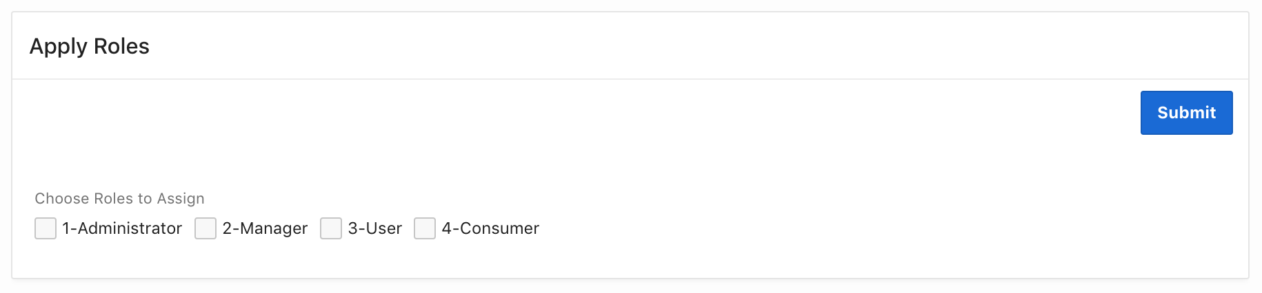

The first thing we’ll do is create an extremely simple form on the page to allow us to apply and remove roles from the admin user. To do this create a Static Content region named Apply Roles and in it, place a Check Box item called P1_ROLE_IDS. In the attributes of the check box, set the List of Values to the ACCESS_ROLES LOV we created earlier. We also need a button to save our changes, so add a button to the region and call it SUBMIT.
You should end up with a form that looks something like this:
Now we need to add in the logic to read and display the currently assigned roles, and save any changes we may apply.

To save any changes we need to create a process in the Processing execution point  and link it to the SUBMIT button.  Create a process called Assign Roles to User, and use the following PL/SQL code for its action. Don’t forget to set the Success Message and the When Button Pressed attribute the SUBMIT.
declare
    l_roles   wwv_flow_t_number := apex_string.split_numbers(:P1_ROLE_IDS, ':');
BEGIN
    APEX_ACL.REPLACE_USER_ROLES (
        p_application_id => :APP_ID,
        p_user_name => 'ADMIN',
        p_role_ids => l_roles );
END;

The last step is to create a set of components to which we can assign our Authorization schemes and see how they work. For this application I created two empty Static Content regions named Exclusive Items and Cascading Items and placed them side by side in the page. I then created 4 more Static content regions in each side, set their template to Hero and chose an icon for each. I gave each of them name that would relate to the Authorization Scheme that I then assigned to them. See the image below.
For each of the Hero regions on the left side, in the Security attributes section I assigned the EXCLUSIVE Authorization scheme that matched the name of the region (EXCLUSIVE ADMIN for ADMINISTRATORS ONLY, EXCLUSIVE MANAGER for MANAGERS ONLY and so on). Once they are applied, the region will only be rendered if you have assigned the related role to the admin user using the form.
Similarly, on the right side, I assigned the matching CASCADING role to each of the Hero regions. Once applied you will see that if you apply any role to the admin user, the regions for that role and any cascaded role will be rendered. An example below shows the User role being applied. Notice that in the EXCLUSIVE section, you only see the USER protected region, but on the CASCADING side, you see both USER and CONSUMER due to the cascading nature of the USER Authorization Scheme.
