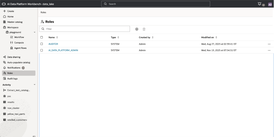

A useful governance model should map to the real surfaces where collaboration happens. Oracle AI Data Platform Workbench does that by applying role-based access control across both collaborative assets and data assets. Administrators can create and manage roles, assign them to users and groups, and separate day-to-day operational access from oversight responsibilities. Out-of-the-box, the platform includes system roles such as AI_DATA_PLATFORM_ADMIN for administrative control and AUDITOR for full audit visibility.
Roles in AI Data Platform

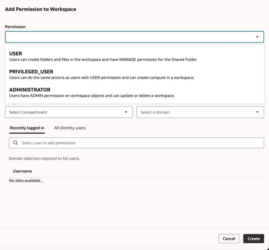

For example, workspaces support distinct levels such as USER, PRIVILEGED_USER, and ADMINISTRATOR. Folders and notebooks expose finer controls such as read, use, manage, and admin. Compute clusters similarly distinguish between reading metadata, using the cluster, and administering it. On the data side, permissions become even more granular. Catalogs, schemas, and tables can be governed independently, with controls for reading, writing, creating derived objects, altering structures, and managing permissions.
Granting permissions to workspace

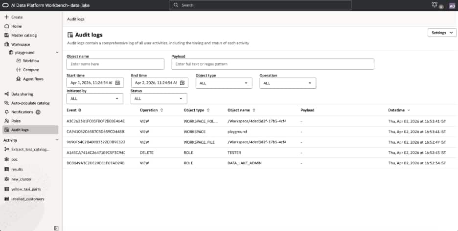

Preventive controls answer one question: who is allowed to do this? Audit trails answer a different one: what actually happened? Oracle AI Data Platform Workbench includes audit logs that capture activity across major platform object types, including external catalogs, roles, standard catalogs and their child objects, workspaces, files and folders.
This audit record is useful because it goes beyond a generic event stream. Operational entries can include the object name, object type, operation, request details, timestamp, initiating user, source of the action, and final status. For platform operators, this creates a reliable record of how changes were made and whether they succeeded. For compliance and internal governance teams, it creates accountability and traceability across a shared platform.
Audit logs
Search and filtering are just as important as raw capture. In real enterprise environments, nobody wants to inspect a flat log dump when they are investigating a failed change, validating an access review, or responding to an internal audit request. Being able to narrow results by object, payload, or time period is what makes auditability operationally useful rather than merely available.
