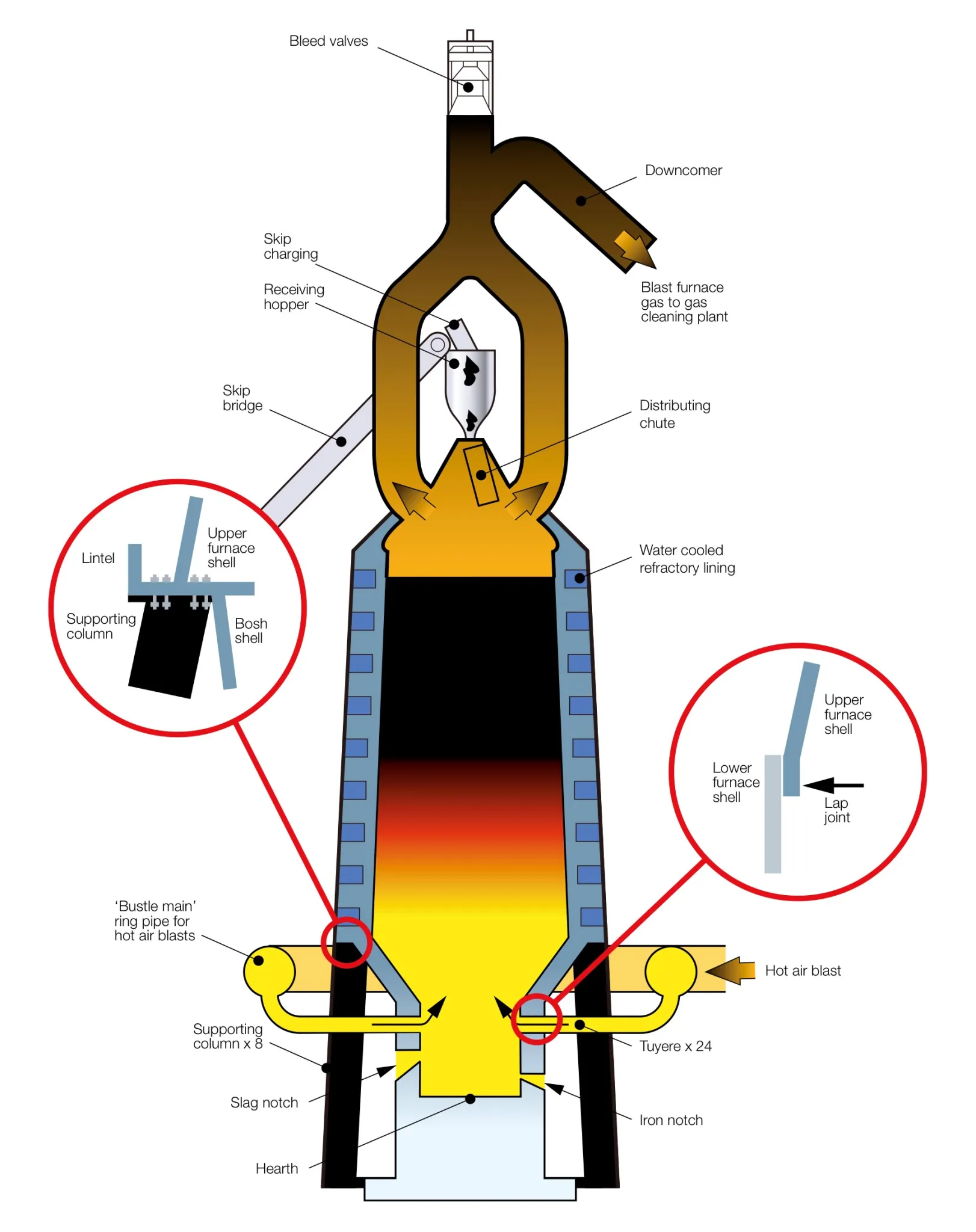

A blast furnace heats raw iron ore to produce molten pig iron, and this furnace heating is the first major step in the steel-making process that is illustrated in Fig. 1 below.
Alternative Text
Figure 1. Schematic shows a skip-cart loading a charge of raw iron ore and coke (purified coal) into the top of a blast furnace that is heated from below via a hot air blast of temperture T~2000° F. This hot air blast heats the furnace and smelts the molten pig iron that flows out via the iron notch, with waste furnace gasses exiting above where bleeder valves protect the furnace from sudden pressure surges.

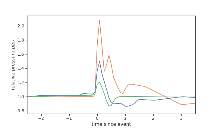

The blast furnace at one particular steel-making Oracle cloud customer was also prone to problematic `bleeder’ events where the furnace gas pressure can surge without warning by 20-100% (see Fig. 2 below), which triggers a bleeder valve to vent excess furnace gas. Though rare, these bleeder events are undesired because they interrupt production and can have environmental impact.

Figure 2. Furnace pressure versus time for small (green curve), medium (blue), and large (orange) bleeder events.

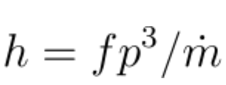

In this circumstance, the better remedy is to instead use ML to optimize furnace operations, namely, to train an ML model to recommend to the furnace operator those furnace settings that would preserve furnace production while steering clear of those conditions that are more likely to lead to a mishap. The recommended solution trains an ML model to instead forecast a derived quantity called furnace-health furnace health where p  is the furnace pressure, mass production rate is the furnace’s mass-production-rate, and the so-called mishap-factor f is almost always unity except during rare moments that are detailed below. The goal of this optimization strategy is to always seek those furnace settings that minimize h  in the near future, which implies that production mass production rate is sustained in way that prevents p  from ramping up rapidly.
