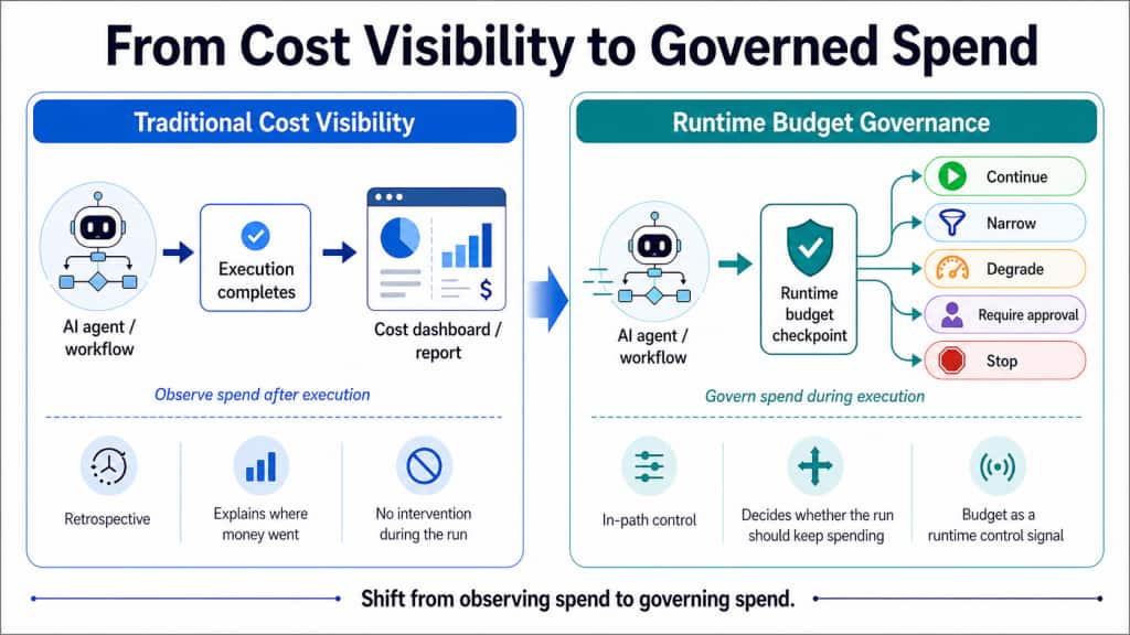

From Cost Visibility to Governed Spend. Traditional controls explain where money went after execution. Runtime budget governance decides whether the current execution path should keep spending more while the run is still in motion.
Figure 1: From Cost Visibility to Governed Spend. Traditional controls explain where money went after execution. Runtime budget governance decides whether the current execution path should keep spending more while the run is still in motion.
OCI’s opportunity is not just to help customers see where agentic spend went, but to help them govern where it is allowed to go.

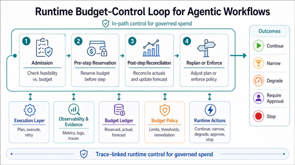

Figure 2 turns this pattern into a runtime budget-control loop. The important point is that budget governance is not a detached alert; it is a closed loop that connects execution state, observability signals, budget ledger updates, policy evaluation, and deterministic runtime action.
Runtime Budget-Control Loop for Agentic Workflows. Admission, reservation, reconciliation, and enforcement decisions are linked through observability, budget state, policy evaluation, and runtime action.
Figure 2: Runtime Budget-Control Loop for Agentic Workflows. Admission, reservation, reconciliation, and enforcement decisions are linked through observability, budget state, policy evaluation, and runtime action.
This loop is what allows the runtime to move from passive budget awareness to governed spend: each expensive step can be reserved, reconciled, evaluated, and either allowed, narrowed, escalated, or stopped based on the current execution state.
