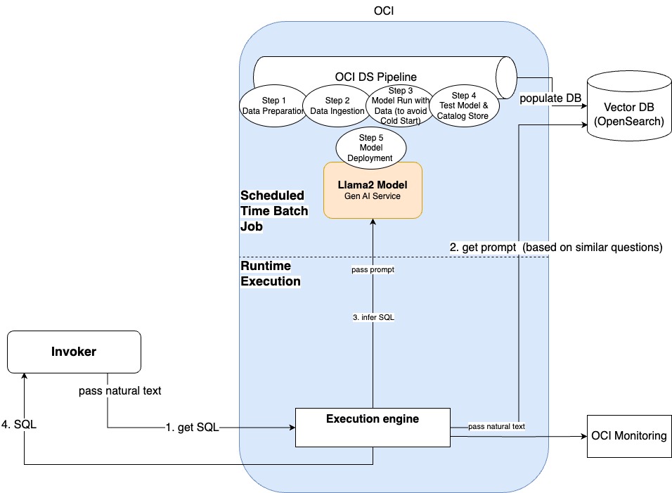

You can define this information in a vector database, such as Open Search, in an index. In the index, every document has the following attributes:
Reference_Question
Reference_SQL
Schema
Pass the natural language question by invoking an Open Search query with a similarity model to get the best document returned for the type defined in the index. This command returns the reference SQL and the schema.
Based on the question, schema, and sample SQL, the prompt is created and the model is invoked.
Let’s assume that the data is already ingested in the vector database. Now a user can ask a question: “Show me all the orders that have yet to be completed and were ordered two weeks ago.” This question gives the best similarity with a reference question. When the prompt is created, the model infers the following information:
