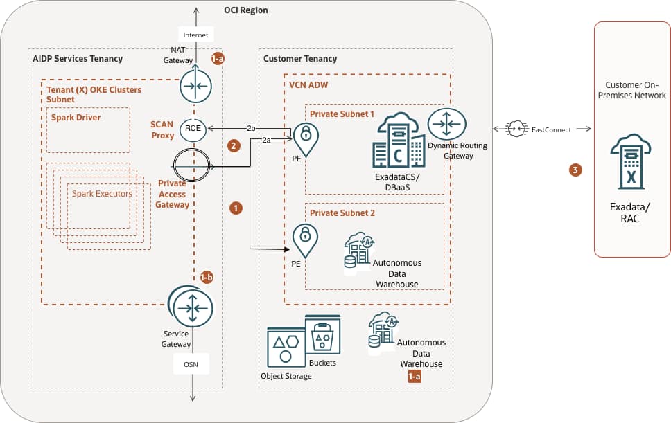

Figure 1 – Schematic Diagram of AIDP service connectivity with Oracle RDBMS use cases
We selected a few use cases below to analyze how network settings and additional configurations enable secure access through private subnets, according to Figure 1 above:

1 – Connecting to an ADB instance configured in the customer’s private subnet

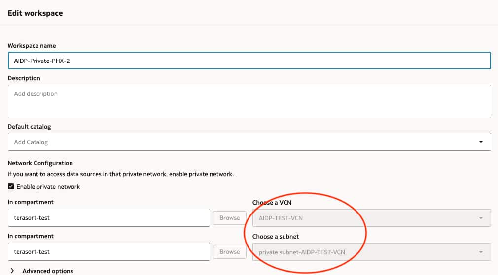

This is perhaps the most common use case. The diagram shows communication between the AIDP Compute Cluster and the ADB instance, routed through a Private Access Gateway that connects to the Customer Private Endpoint. The Private Endpoint is created when the Workspace is configured as private, and the VCN and Subnet are assigned to it. Figure 2 demonstrates the settings in the test Workspace used to verify the functionality.
Note: At present, Oracle AI Data Platform (AIDP) requires a publicly accessible Default Workspace endpoint to interoperate seamlessly with core platform services such as the Data Catalog, Object Storage, Data Lake, and persistent Volumes. This design ensures reliable service-to-service communication, streamlined authentication, and consistent access to shared metadata and storage layers, which are currently exposed via controlled public endpoints within the Oracle Services Network. While all data-plane interactions can still be secured through private networking constructs, the Workspace maintains a public interface to ensure compatibility and operational continuity across dependent services. Looking forward, Oracle is evolving toward a fully private AIDP Workbench model, in which Workspaces will be attached to customer-managed private subnets. This enhancement will eliminate the need for public exposure entirely, enabling end-to-end private execution environments that better align with stringent enterprise security requirements, while preserving seamless integration with platform services via private endpoints and native VCN routing.
Figure 2 – Defining the Workspace networking.

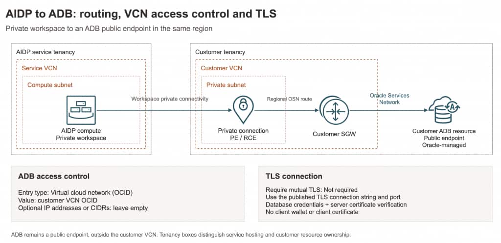

1a – Connecting with an ADB instance using ACL
AIDP compute clusters in a Private Workspace can access supported regional Oracle services through a Service Gateway in the AIDP service tenancy. An Oracle service can have a public endpoint while the connection stays on the Oracle network. A service gateway provides this access without an internet gateway or NAT gateway.
Some service policies require requests to arrive through the customer’s VCN. For this configuration, use the workspace’s My data sources require advanced DNS configuration (**) option and configure the relevant service hostname to use the workspace’s private connection. AIDP documents this option for access through an in-region service gateway in the customer VCN, cross-region data sources, and Oracle services behind private endpoints. AIDP workspace configuration. Figure 3 illustrates the ADB ACL Configuration below.
** Note: currently, a Private AIDP Workspace does not route to oraclecloud.com public domains, for instance, adb.<region>.oraclecloud.com. Access to these OCI public domains can be granted by raising a support request (SR) on support.oracle.com. A new feature has been introduced, and when enabled by the Service team, will allow you to see the advanced DNS configuration as stated above.
Figure 3 – ADB Network Access Configuration using Access Control List
A common error message occurs if the AIDP Workspace subnet is not part of the authorized IPs that can access the DB, for instance:
TNS:connect request rejected based on current filtering rules

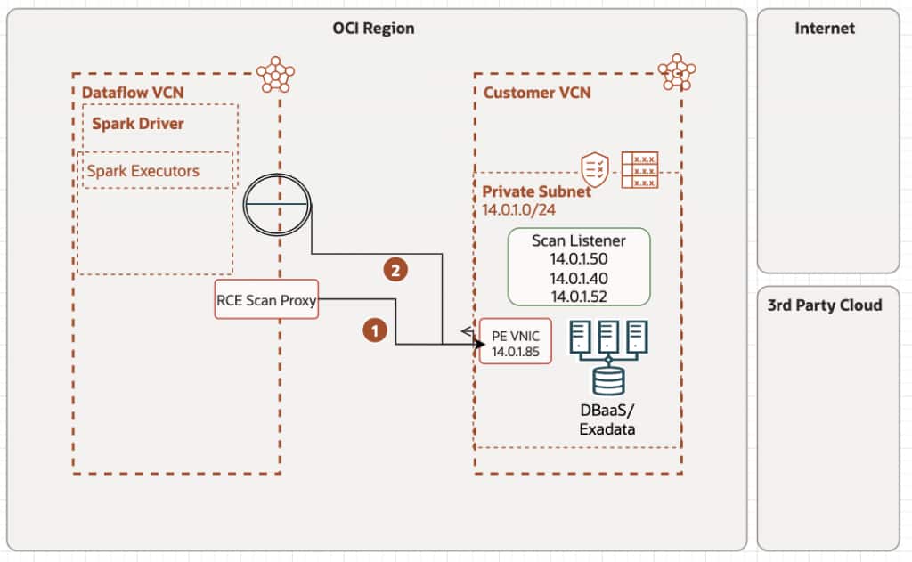

2. Connecting using Oracle DB SCAN (Exadata/DBaaS)
AIDP can connect to the DBaaS/RAC (Real Application Clusters) or Exadata machine as a client application using SCAN (Single Client Access Name). The SCAN is a virtual name similar to those used for virtual IP addresses. However, unlike a virtual IP, the SCAN virtual name is associated with the entire cluster rather than an individual node, and it supports multiple IP addresses rather than just one.
When the SCAN proxy feature is enabled, a reverse connection entry point (RCE) is established to handle IP-based redirects. As shown in Figure 4, a PE VNIC (private endpoint virtual network interface card) is created in the Customer VCN. The RCE PE VNIC is unique for each Private Workspace setup. One important consideration for the TLS connection to a database cluster is that the database SCAN listeners should redirect network traffic to an FQDN rather than the IP address directly. Only the FQDN redirects from a SCAN listener will enable TLS. Therefore, the database cluster should be configured to redirect to an FQDN when TLS is required.
The configuration steps that happen behind the scenes to create the SCAN proxy feature:

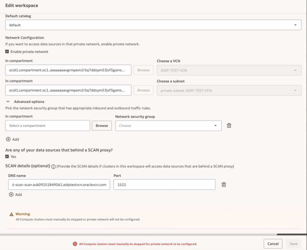

  • The user configures the SCAN proxy in the Private Workspace configuration
  • The Private Workspace updates RCE to include SCAN configuration (the SCAN listener DNS name and port), which provides a new IP (SCAN proxy IP) in the service VCN binding to the same SCAN port
  • The Private Workspace will then use the SCAN proxy IP to create a DNS mapping within the service network, using the original SCAN listener DNS name and the SCAN proxy IP

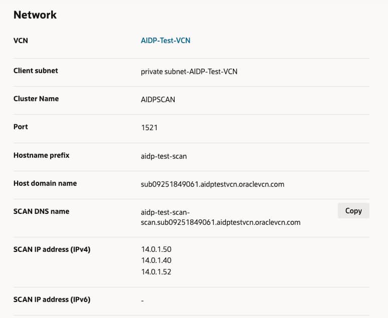

Figure 4 shows an example of a DBaaS Oracle Database system within a private subnet in the customer VCN. The flow of the picture states the sequence used to identify the connectivity:
  1. AIDP Compute cluster initiates a connection to the SCAN Proxy endpoint within the service VCN using the DNS name. AIDP Compute defines a customer DBaaS connection through the SCAN Proxy by selecting a specific port. RCE SCAN proxy forwards the request to the underlying PE VNIC listener in the customer network. It then inspects the SCAN listener response for an IP address of the underlying database cluster instance, creates a Class E NAT IP, and replaces the cluster instance IP with the NAT IP in the SCAN proxy response.
  2. The Private Access Gateway receives the redirect request from the SCAN listener, automatically translates the local listener IP address in the customer’s VCN into a mapped IP address, then returns this information to the Private Workspace components and issues a connection request to one of the local listeners.
Figure 4 – SCAN connection workflow
Figure 4a – DBaaS Network Configuration – SCAN DNS name and SCAN IPs
Figure 5 – AIDP Private Workspace SCAN Configuration

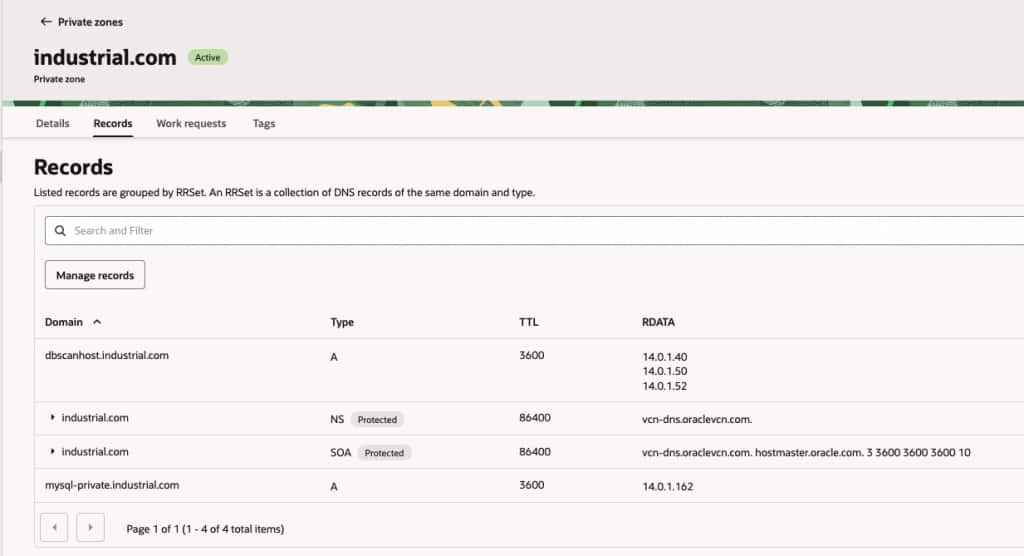

Similarly, as stated in Figure 1, path (3), we can use an OCI VCN subnet to connect to an on-prem engineered DB machine. On this path, it is necessary to create a DNS “A” record for the database system’s SCAN hosts, using their respective IP addresses.  Figure 6 below exemplifies the corporate domain (industrial.com), the SCAN FQDN dbscanhost.industrial.com has the IPs of the SCAN hosts responsible for responding to requests from the compute resources in an AIDP private Workspace attached to this subnet.
Note that connectivity between subnets must be in place before this practical implementation can work. For tips on troubleshooting connectivity, please see the section below.
Figure 6 – DNS Record of the remote SCAN

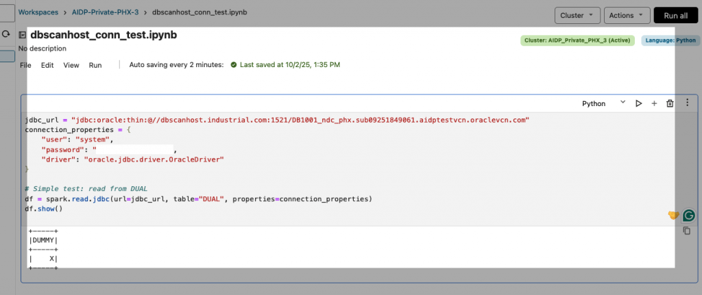

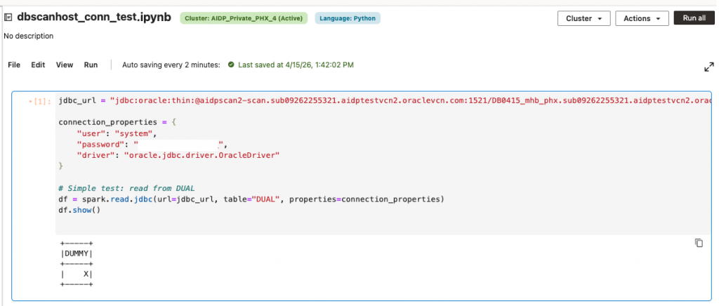

Figure 7 shows a Notebook cell that can be used to validate communication with the SCAN DBs. Note that up to this point, the communication between AIDP and the DB system is using Oracle’s thin client to validate the communication. See the sections below for more details and limitations on thick clients and Wallet use.
Figure 7 – Remote SCAN simple test script

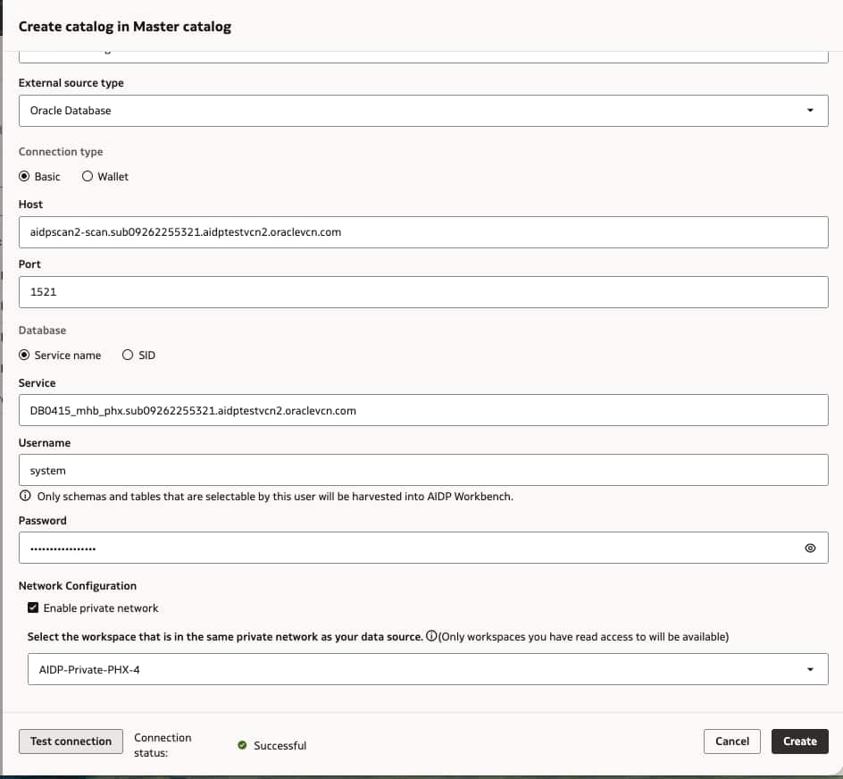

External Catalogs connectivity follows the same principles as the Notebooks above. The Compute clusters inside the private Workspace will similarly establish communication with the Oracle DBs in secure networks. Also similar is the method of communication, using a JDBC thin client to communicate. Useful to mention that the connectivity between the network segments needs to exist before the AIDP Workspace is defined to use them. As a best practice, build your network connectivity diagram and verify communication among the endpoints before launching the Workspace into a private network segment.
Figures 8 and 9 illustrate a critical connection between an External Catalog and a DBaaS instance (this applies to any RAC-based configuration running on the SCAN protocol). AIDP_Private_PHX_4 is an AIDP Workspace attached to a private subnet where the DBaaS database resides. The Host Scan idpscan2-scan.sub09262255321.aidptestvcn2.oraclevcn.com and port, and the DB Service name can be used to validate that connectivity.
Figure 8 & 9 – Asserting External Catalog and Notebook are able to connect to an external DBaaS
Note: Within a Workspace, only Administrator roles can maintain External Catalogs.

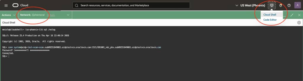

Connectivity tests using Cloud-shell (or an embedded VM in the subnet)
A practical way to validate connectivity to a private Oracle Database from an AIDP private workspace is to use OCI Cloud Shell (highlighted in Figure 10) to attach to the same ephemeral subnet (also highlighted) used by the workspace. By launching Cloud Shell with private network access (or via a delegated subnet configuration), you can effectively place a test environment inside the same VCN context as the AIDP notebook runtime. From there, tools like sql-cl, or simple TCP checks (e.g., nc host port) can confirm whether the database listener is reachable over the private endpoint. This approach helps isolate network issues such as missing security list rules, NSG misconfigurations, or routing problems without modifying the notebook itself. It is particularly useful because AIDP private workspaces often rely on ephemeral subnets and managed networking, making direct troubleshooting difficult; Cloud Shell provides a controlled, reproducible way to verify that the private Oracle Database is accessible under the same network conditions. Figure 10 depicts a process for establishing connectivity to an Oracle DBaaS instance within a private network.
Figures 10 – Using Cloud-shell and SQL-CL to validate the subnet connectivity to the Database
