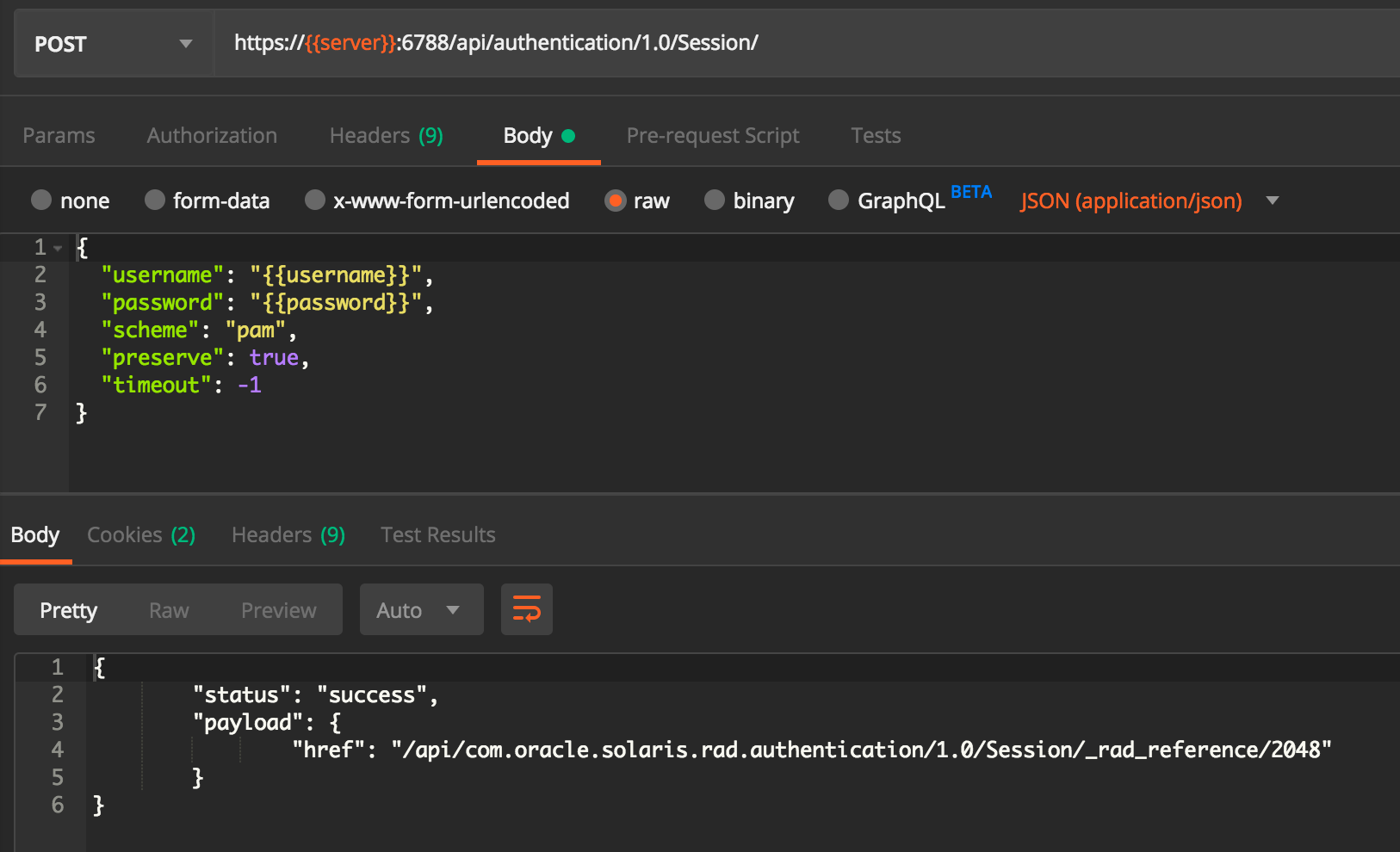

Authenticating
Of course we first need authenticate like before but because I’m using Postman I thought I’d show how I’m doing this:
Note I’m using centrally set variables {{server}}, {{username}}, and {{password}} in the URL and the JSON payload, in part to obscure them but most importantly if I want to connect to a different server or connect under a different user ID I can change it once and all my URLs and payloads are updated where appropriate. Equally if you use a Postman test run you can load these in to fit your test.

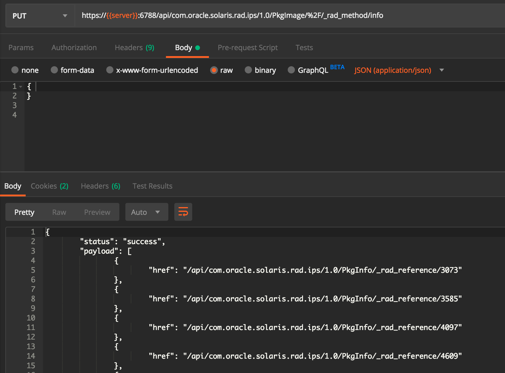

The first real step now is to connect and ask for the list of installed packages. We do this by using the method info to the PkgImage interface of the IPS RAD module. To use this we use _rad_method to indicate we want to use a method. This is a PUT call so we also need to supply a JSON payload but initially will just send an empty { }. And thus the result looks like this:
As you can see the URI /api/com.oracle.solaris.rad.ips/1.0/PkgImage/%2F/_rad_method/info — where %2F stands for / — will give you something that looks like this:
        "status": "success",
        "payload": [
                        "href": "/api/com.oracle.solaris.rad.ips/1.0/PkgInfo/_rad_reference/3073"
                        "href": "/api/com.oracle.solaris.rad.ips/1.0/PkgInfo/_rad_reference/3585"
                        "href": "/api/com.oracle.solaris.rad.ips/1.0/PkgInfo/_rad_reference/4097"
                        "href": "/api/com.oracle.solaris.rad.ips/1.0/PkgInfo/_rad_reference/4609"
                        "href": "/api/com.oracle.solaris.rad.ips/1.0/PkgInfo/_rad_reference/5121"
                        "href": "/api/com.oracle.solaris.rad.ips/1.0/PkgInfo/_rad_reference/320513"
So you see this is a very long list of references each connected to a PkgInfo object. So the next step is to have a look at what these objects look like.

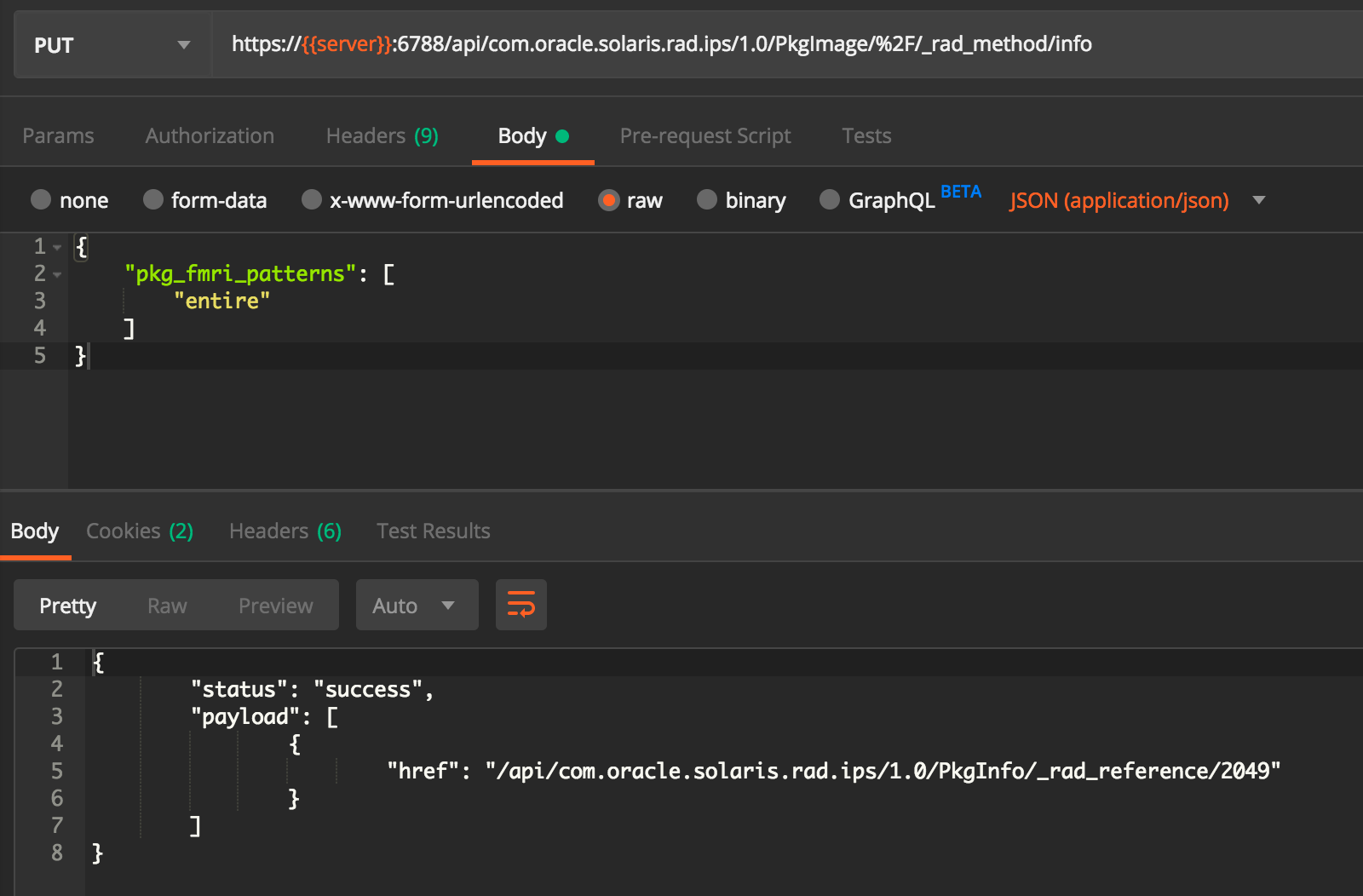

Now if you want to search for a specific package or packages and get its/their info you need to change the JSON payload to reflect which package(s) you’re looking for, in this case I’m looking for the entire package:
	"pkg_fmri_patterns": [
        "entire"
And this gives us a much smaller response:
        "payload": [
                        "href": "/api/com.oracle.solaris.rad.ips/1.0/PkgInfo/_rad_reference/2049"
Here’s the screenshot from Postman:
We can now use this reference to get further details like we did in the example above.

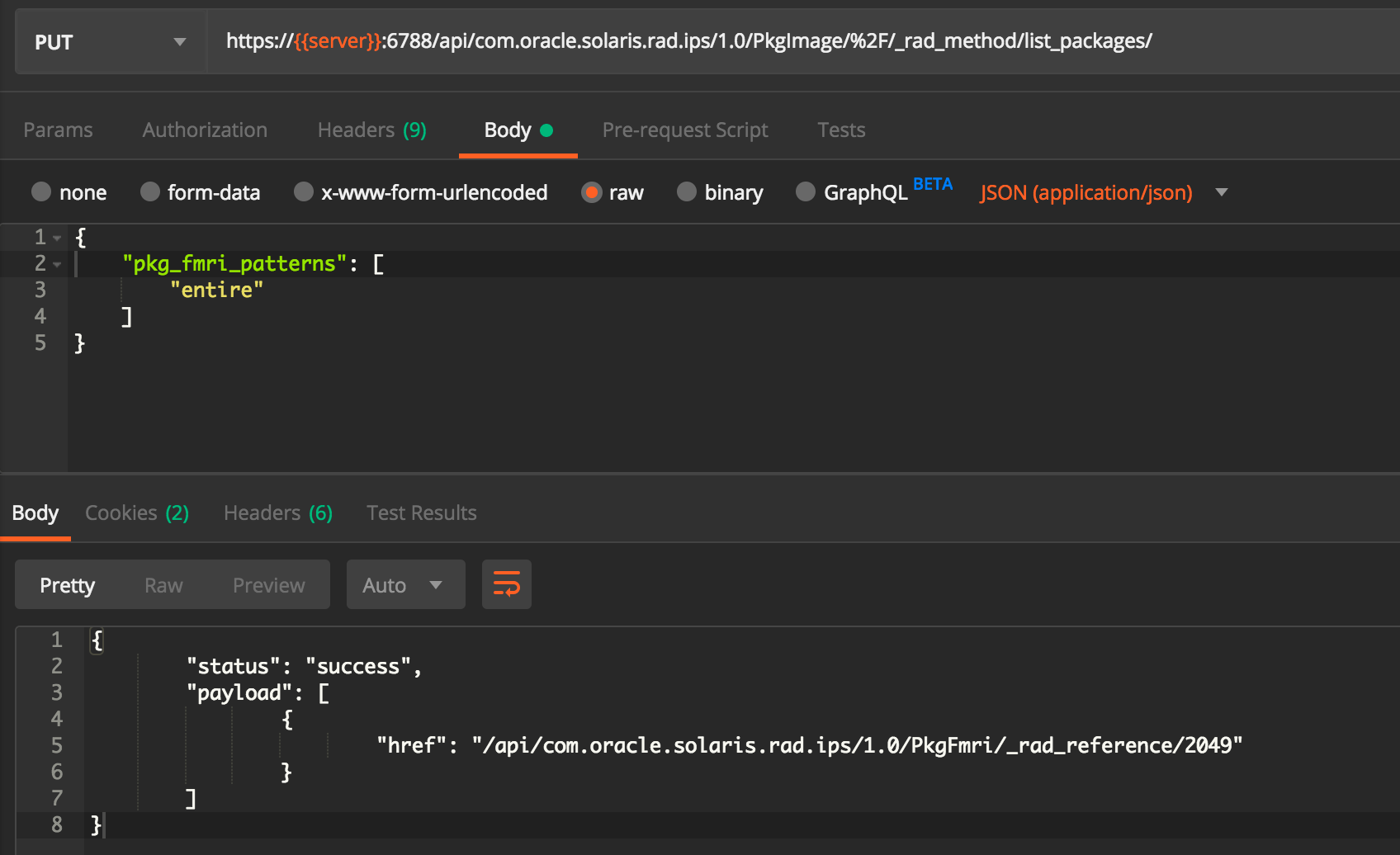

Another way to search for a specific package using the PkgImage interface and getting a PkgFmri reference directly is to use the list_packages method on the / image path. This results in the following URI:
/api/com.oracle.solaris.rad.ips/1.0/PkgImage/%2F/_rad_method/list_packages/
Where we use a similar JSON payload as before:
        "entire"
With a PUT call resulting in:
        "payload": [
                        "href": "/api/com.oracle.solaris.rad.ips/1.0/PkgFmri/_rad_reference/2049"
Again seen in Postman:

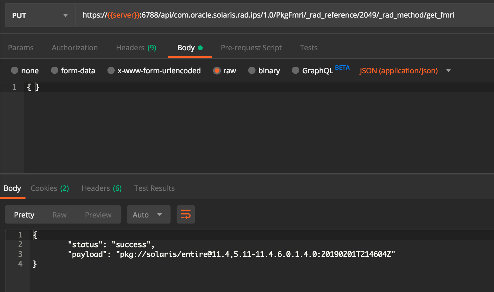

On the PkgFmri interface we also have individual methods to get specific piece of information, so for example if we use this URI:
/api/com.oracle.solaris.rad.ips/1.0/PkgFmri/_rad_reference/2049/_rad_method/get_fmri
With a PUT and an empty JSON payload ({ }) the response is:
        "payload": "pkg://solaris/entire@11.4,5.11-11.4.6.0.1.4.0:20190201T214604Z"
You can see that we’re running 11.4 SRU 6 in on this system.
