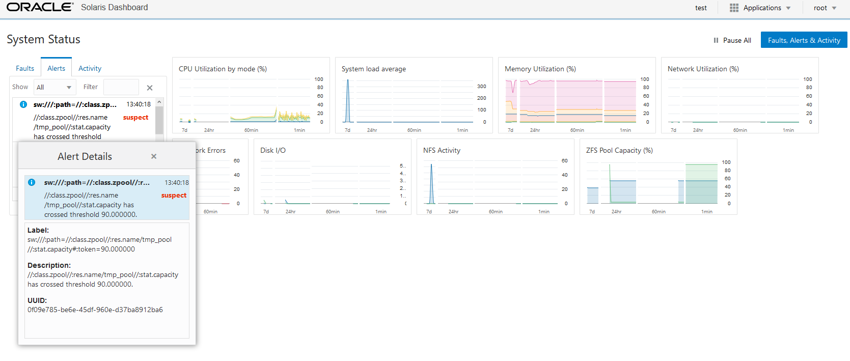

StatsStore monitors the stat //:stat.capacity for all the zpool resources that map to SSID //:class.zpool//:*  and generates a FMA alert if the zpool capacity crosses over 90% of its allocated capacity.  Here I created a zpool ‘tmp_pool’ and filled it up to 95% capacity. The alert that is generated  looks like this:
SUNW-MSG-ID: SUNOS-8000-N9, TYPE: Alert, VER: 1, SEVERITY: Minor
EVENT-TIME: Wed Apr  1 01:10:18 PDT 2020
PLATFORM: VirtualBox, CSN: 0, HOSTNAME: test
SOURCE: software-diagnosis, REV: 0.2
EVENT-ID: 0f09e785-be6e-45df-960e-d37ba8912ba6
DESC: //:class.zpool//:res.name/tmp_pool//:stat.capacity has crossed threshold 90.000000.
AUTO-RESPONSE: Current value is 95.000000.
IMPACT: Impact may depend on workload or other conditions, please review based on your policies.
REC-ACTION: Please address open issues. Please refer to the associated reference document at http://support.oracle.com/msg/SUNOS-8000-N9 for the latest service procedures and policies regarding this diagnosis.
FRU-LOCATION:
You will also see this in the WebUI in the “Faults, Alerts & Activity” tab as shown below.

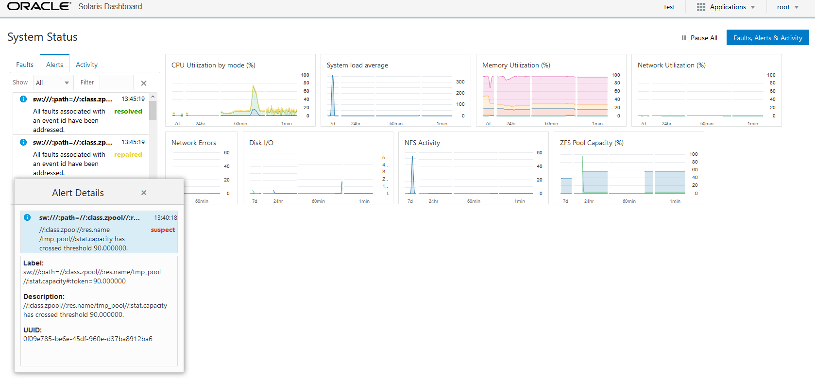

If I remove some data from tmp_pool so that utilization falls below the threshold of 90%, you will see that FMA alert being reset as below.
