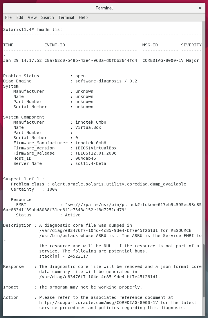

It’s pretty easy to see that the same concept for modelling System panic as FMA events could be applied to user level process core dumps. So that’s what we’ve done. coreadm(8) has been extended so that by default a diagnostic core file is created for every Solaris binary that crashes. This is smaller than a regular core dump. We then have a service (svc:/system/coremon:default) which runs a daemon (coremond) that will monitor for these being created, and summarize them,. By default the summary file is kept, though you can use coreadm to remove them. coremond then turns these in to FMA alerts. These are considered more informational than full on defects, but are still present in the FMA logs. You can run fmadm(8) like in the screen shot below to see any alerts. This was one I got when debugging a problem with a core file.

So if you look in the message above you’ll see the description that says:
Description : A diagnostic core file was dumped in
/var/diag/e83476f7-104d-4c85-9de4-bf7e45f261d1 for RESOURCE
/usr/bin/pstack whose ASRU is . The ASRU is the Service FMRI for
the resource and will be NULL if the resource is not part of a
service. The following are potential bugs.
stack[0] - 24522117
The stack[0] shows which thread within the process caused in the core dump, and obviously the bugid following it is one you can search for in MOS to find any solution records. Alternatively you can see if you’ve already got the fix in your Oracle Solaris package repository, by using the pkg search option to search for bugid.
