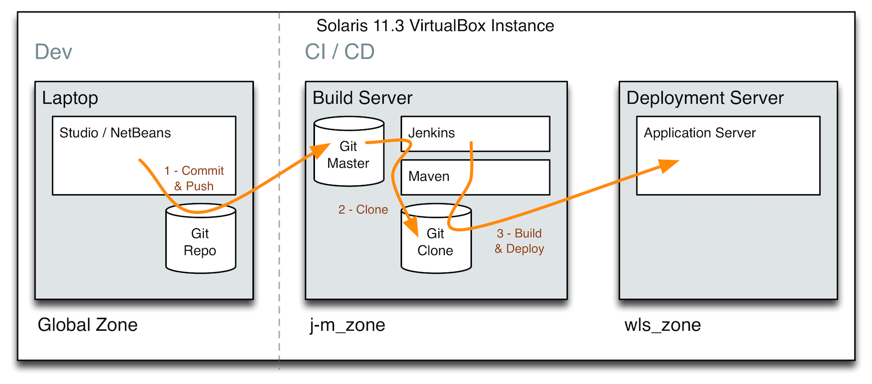

The DevOps toolchain we want to create essentially looks like this:
Note: The whole setup here is inside a single VirtualBox instance with Solaris Zones inside it because in the Hands on Lab every participant get a separate laptop and this way we can simulate the full set up within a single system.
The general flow goes from left to right with the following main steps:
  • A developer writes their code, probably on their laptop or workstation in their favorite development tool, in this case we are using NetBeans but they can essentially use any tool they like. The language in this case is Java because we're going to be using WebLogic as the application server but the same flow holds for other languages too.
  • Once the developer is ready to test their code, they commit their changes to their source code management system, which in our case is Git. In Git you first commit to the local copy of your code repository and then you push your changes to the main repo (which often is called "Origin"). This main repository is where other developers also will be pushing their changes and is often located on a central server (or even on a public location like GitHub).
  • Once the new version is in the central repository it will signal this to a build manager, in our case we've chosen to use Jenkins as the build manager as it's extremely popular and has many extra modules for all kinds of use cases. In this case Jenkins is installed on the same "server" (personified by a Solaris Zone) as the main Git repository but this is by no means necessary, we're running in the same environment to save space. Jenkins has jobs defined by the developer where they can configure what needs to happen once the code is changed.
  • According to the job configuration Jenkins will then build and run the first tests on the application, but first it creates a clone of the Git repository into a work environment so it can run a completely fresh build.
  • Now the code is built and tested, on our case we're using Maven as the Java build tool, it will put the resulting code in the same work environment. For the initial testing of the resulting code we can use a tool like JUnit, this is done with test code that has come from the developer inside the same repository. In simple example we don't use any test code.
  • Once the build is successful Jenkins tells Maven to connect to the application server on the deployment server and push the new version to it so you can do further testing. The use of deployment server may be confusing, at this stage it's more a test server simulating being a deployment server.
At this point the new version of the application is up and running, which means it can for example be connected to other systems in a larger test of all the different application pieces, or just used for individual function testing.
The intent of this whole chain is to allow a developer to push their code into the repository and that after that everything automatically happens and they don't have to do anything by hand or submit tickets to have someone else clear space on a system set it up and install all the bits necessary. This is all predefined and rolled out automatically, saving a lot of time and engineering cycles both on the developer side as well as on the operations side.
The other benefit is that the developers can very easily try out different versions quickly after each other this way quickly iterating to a better solution than if things need to
The reality of course is slightly more complex than this simple case. This workflow would be used maybe for initial testing and once it has successfully run this new version can be promoted to a different repository where it will be built (possibly by a different Jenkins server) and then deployed to for example systems for stress testing, or pre-production systems for testing in a production like setting. And then finally once it's deemed ready it can be promoted and deployed to the production systems. And all of this can be made easier with this type of automation.
