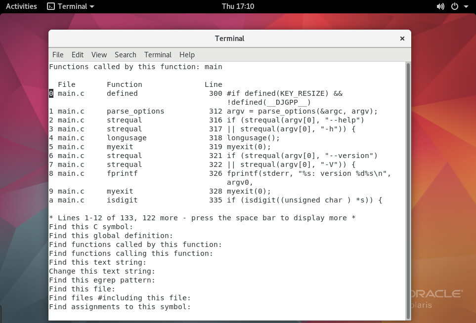

So lets run it on cscope and see what it looks like
$ cd cscope-15.9/src $ cscope -R
So there you have it, cscope, cscoping cscope source
