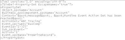

We can use the EAI XML Write to File business service and its WritePropSet method to send the input property set to a file. This is what the file looks like when your business service is called from an action set:
click to enlarge
The action set passes the following information:

The developer can now write appropriate code to peruse this information in the business service. Usually you would be most interested in the Context property which normally contains something like the following:
"Param1", "Value1", "Param2", "Value2"
This is how it is used for standard business services like Workflow Process Manager. Note that the syntax contains strings in double quotes and they are separated by a comma and a space. Of course, for your custom written business service, you could use any other syntax but this may not be "close to the standard" and could cause problems in larger projects where other developers would not be aware of a different context string syntax.
