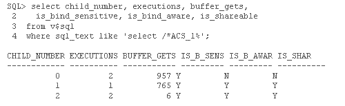

Recall that in that example, we had to execute the query twice, with different bind values, before we switched to bind-aware cursor sharing.  So we had to run the query a total of at least four times in order to populate the cursor cache with the two plans we want to use, depending on bind value.  This is what the cursor cache looked like after 5 executions:

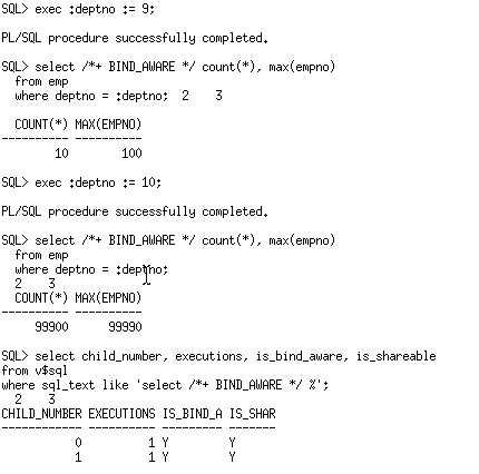

Now let's look at the behavior with the BIND_AWARE hint:

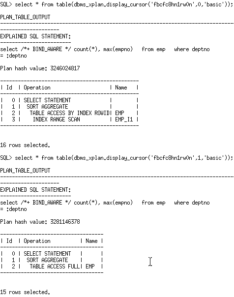

After two executions with two different bind values, there are two bind-aware child cursors.  And as expected, the very selective bind value (9) used an index scan, while the not-so-selective bind value (10) used a full table scan:
Now that the cursor cache is populated with these two bind-aware child cursors, they will behave just as if they were created due to adaptive cursor sharing. For instance, if I run the query again with another very selective bind value, the first child cursor will be used.
