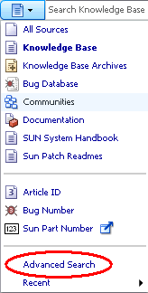

TIP 3: Use Advanced Searches to narrow the scope By default, My Oracle Support performs a simple search. You can perform an advanced search by choosing Advanced Search from the Sources dropdown menu to the left of the Search Knowledge Base box at the top right of the screen:

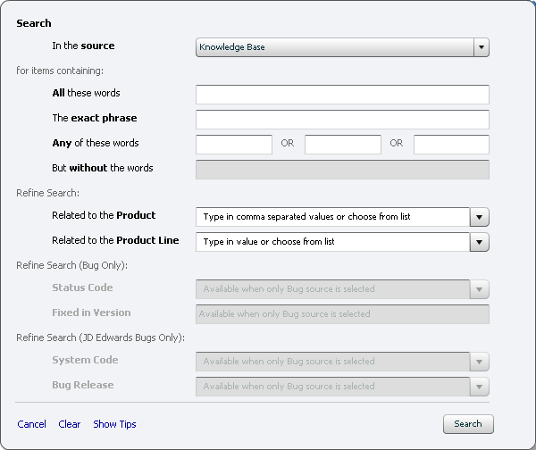

Or you can simply click on the Advanced link at the end of the same line, to open an Advanced Search popup window:
TIP 4: Use special Advanced Search options As an alternative to using the Advanced Search window shown above, you can enter advanced options with your search terms:

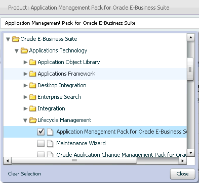

TIP 6: Use PowerView The final power user tip is to use PowerView, which allows you to limit your search to a product of your choice. Note that this option is only available with the main (Flash-based) site, not the HTML-based one. To use this option, you first need to create a new PowerView:
In the following example, Application Management Pack for Oracle E-Business Suite is being specified as the product of interest:
You can then switch PowerView on, and the status will change accordingly:
Search criteria will apply now to this product only. In this example, you could enter “3.1” as a search string to find documents about that version of the Application Management Pack. You can find out more in the PowerView section of My Oracle Support Help – General (Doc ID 733242.5). Related Articles
