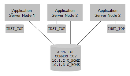

Our documentation about sharing filesystems between multiple Oracle E-Business Suite Release 12 application servers recommends that you install the Instance Top (INST_TOP) on a local filesystem. This has prompted an interesting discussion about whether this is really mandatory, or whether it’s technically feasible to put the Instance Top on, say, a dedicated fibre-attached SAN.
Our guidance on the INST_TOP being installed on a local file system is based on three major considerations:
- Separation of duties and security implications
- Impact of SAN performance on Apache
- Additional troubleshooting complexity
1. Separation of Duties & Security Implications
Our recommended configuration allows for different file system privileges and ownership between the Instance Top (INST_TOP) and the Code Top (ORACLE_HOMEs & APPL_TOP). This allows for the segregation of duties between administrators for the respective servers. Patching can be done on the Code Top by central system administrators who own the central shared portion of the file system. Instance Tops can be owned by instance sysadmins, who usually already own the CPU box with local storage.
