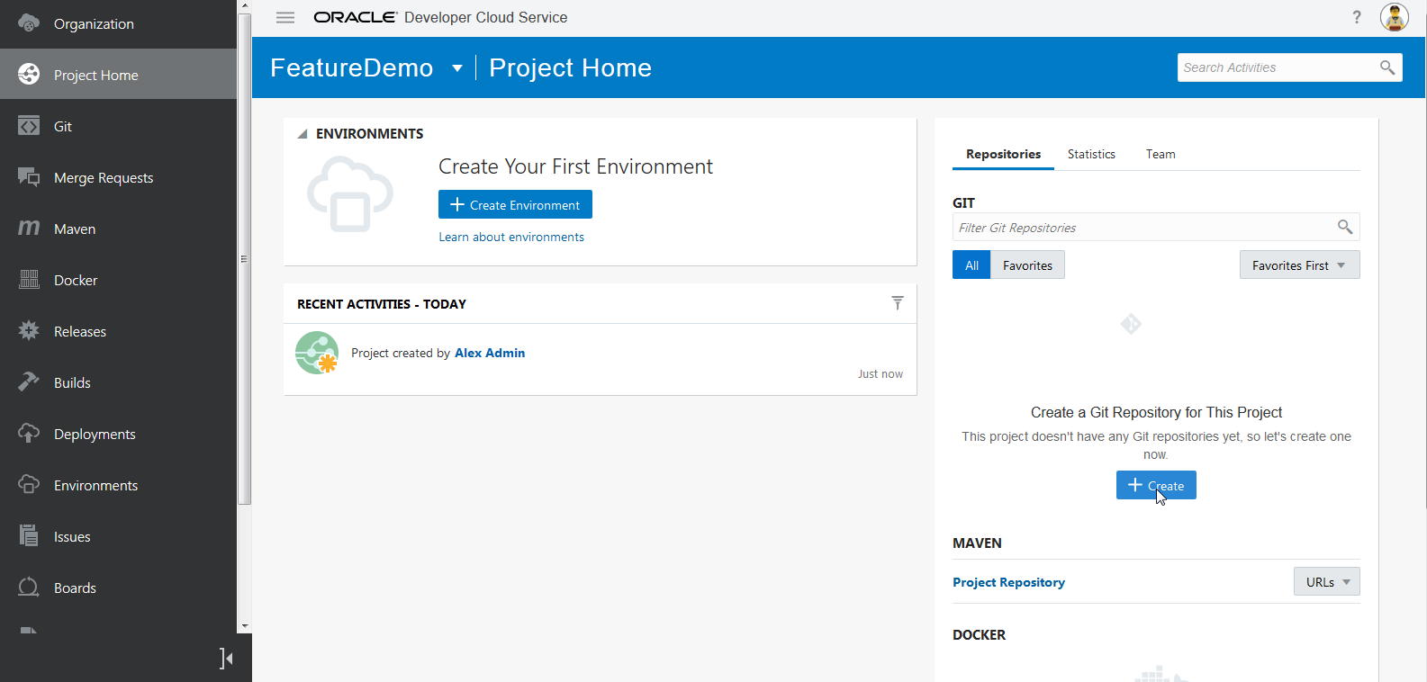

To start, create a Git repository in your Developer Cloud project and then create a .ci-build folder in that repository. This is where the YAML build configuration file will reside. For this blog, I named the Git repository NodeJSDocker, but you can name it whatever you want.
In the Project Home page, under the Repositories tab, click the +Create button to create a new repository.
Enter the repository Name and a Description, leave the default values for everything else, and click the Create button.

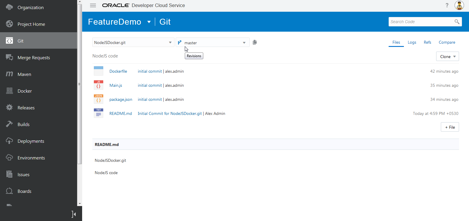

In the NodeJSDocker Git repository root, use the +File button and create three new files: Main.js, package.json, and Dockerfile.  Take a look at my NodeJS Microservice for Docker blog for the code snippets that are required for these files.
Your Git repository should look like this.

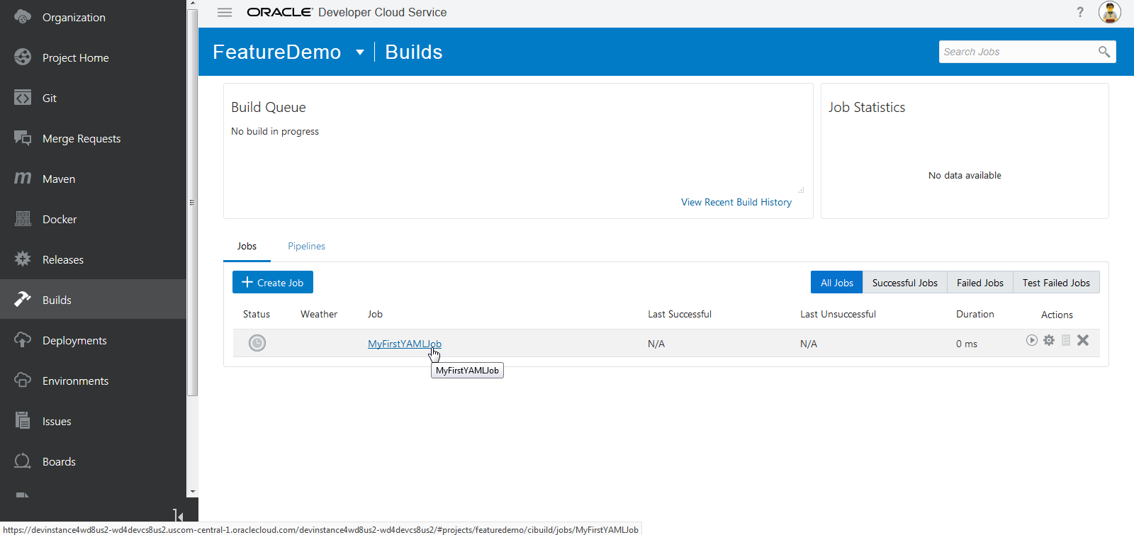

Right after you commit the YAML file in the .ci-build folder of the repository, a job named MyFirstYAMLJob will be created in the Builds tab. Notice that the name of the job that is created matches the name of the job you defined in the my_first_yaml_build.yml file.

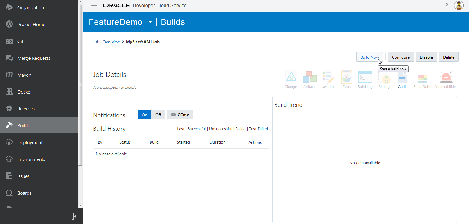

Click the MyFirstYAMLJob link and then, on the Builds page, click the Configure button. The Git tab will open, showing the my_first_yaml_build.yml file in the .ci-build folder of the NodeJSDocker.git repository. Click the Edit File button and edit the YAML file.

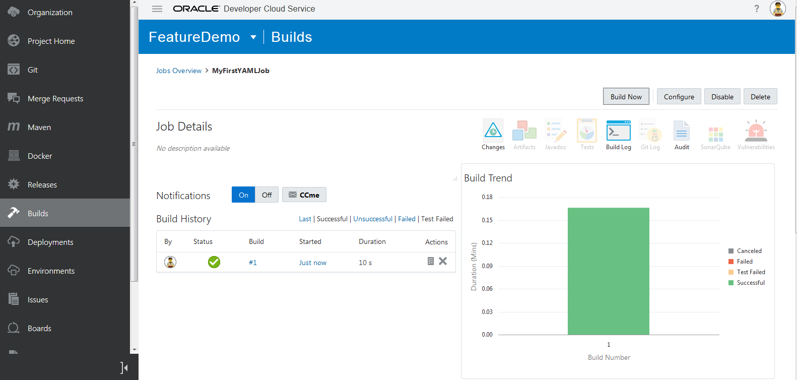

After you finish editing and commit the changes, return to the Builds tab and click the Build Job link. Then click the Build Now button.
When the build job executes, it builds the Docker image and then pushes it to DockerHub.
