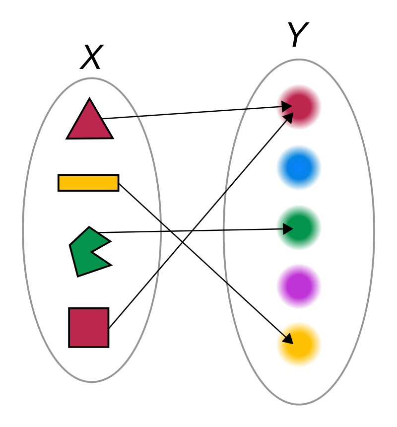

Functional Programming paradigm can be equated to the mathematical equivalent of y = fn(x).
Mathematical definition:
A function is a process or a relation that associates each element x of a set X, the domain of the function, to a single element y of another set Y (possibly the same set), the co-domain of the function.
Function

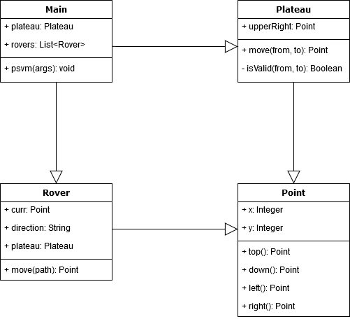

Design
You have a Rover, a Plateau (terrain) and a Main object that will call invoke and instruct the Rover.
The Main initializes the Plateau, and Rover objects.

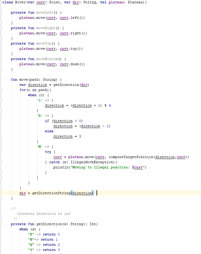

Code - OOP
Below is my implementation of the Rover class in OOP. I iterate over the instructions and using 'when' (switch in java) handle each of the instructions.
Available on GitHub

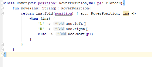

Code - FP
Below is the functional version of the same code.Code available on Github
Explanation
You can see how concise this code looks compared to the OOP approach used to solve the same problem here
I have used fold to reduce the the sequence of instructions to a single final position, which is the destination expected.
Fold takes an accumulator and element of list/map, combines/reduces and returns this value as accumulator to next element and so on, till the last element is completed.
Fold is similar to Reduce except that it takes and initial value, whereas Reduce copies the first element to the accumulator. Also Fold can be used when the accumulator is of a different type than the list or map.

  • Split the string(ins) into a Character Sequence.
  • Pass the initial position of Rover to Fold
  • For each char instruction('L', 'R' or 'M'), turn left, right or move the rover respectively.
