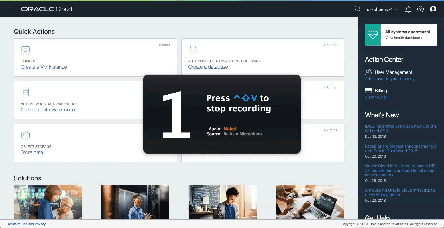

Before getting started you'll need to configure your Oracle Cloud tenancy.  If you're in the Limited Availability trial, make sure your tenancy is subscribed to the Phoenix region because that's currently the only region where Oracle Functions is available.  To check and/or subscribe to this region, see the following GIF:
Before moving on, if you haven't yet installed the OCI CLI, do so now.  And if you haven't, what are you waiting for?  It's really helpful for doing pretty much anything with your tenancy without having to log in to the console.
