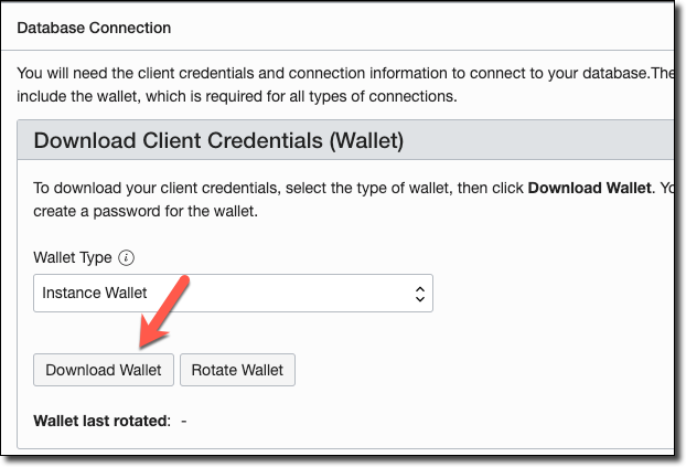

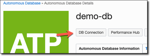

So let's get started walking through the process. The first step is to download your ATP wallet. You can do this via the console dashboard:
Or you can use the OCI CLI to download the wallet:

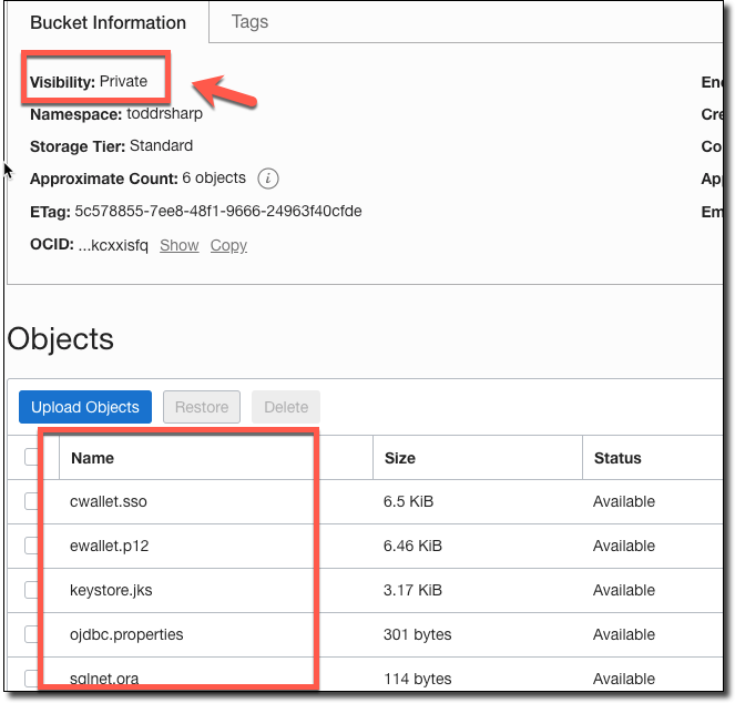

Now that you've got a local copy of your wallet, create a private bucket in Object Storage, unzip the wallet and upload each file from the wallet into the private bucket.
Note: Did I mention that the bucket should be private?

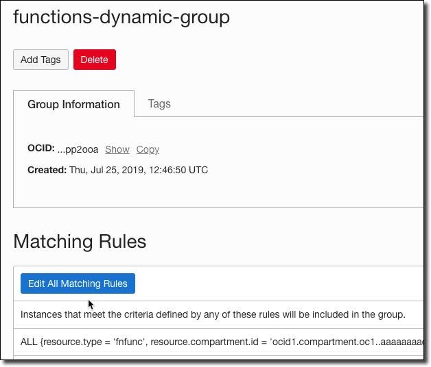

We're going to take advantage of Resource Principals for our function so that we do not have to include any OCI credentials in order to use the OCI SDK. To do this, you'll need a Dynamic Group. I like to create one for the compartment that I use for all of my functions.

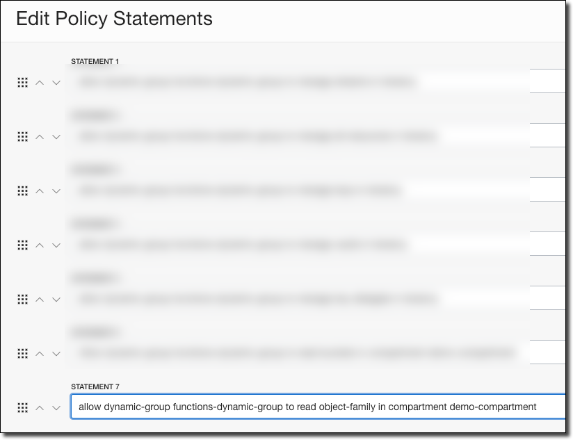

Next, assign a policy to the dynamic group so that it is able to read the bucket where your wallet files are stored.
