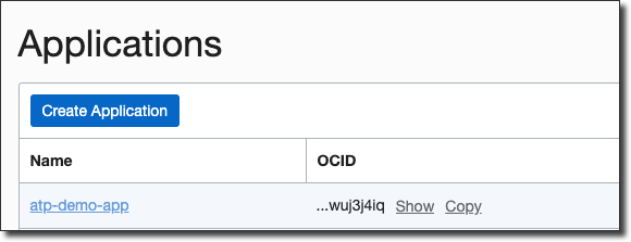

When using Fn to create a Java function, you can typically rely on the boilerplate Docker image. But in our case, we'll need to add some external dependencies to the container so we'll need to do things a bit differently. Let's get started by creating an application.  Applications are simply groups of functions that allow you to utilize shared configurations and compartmentalize your functions under a common group.  To create an application, run the following command with the Fn CLI:
You can confirm that the application was created via the console UI:

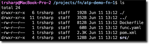

Next, let's create the function itself. To do this, we'll take advantage of a feature in Fn that allows you to create your function from an "init-image". This allows us to modify the Dockerfile a bit to make sure that our ATP wallet contents end up inside of the Docker image that we produce for our function. Cloneout the JDK init image into a local directory and then run the following commands to get our function created:
Take a look inside the directory that was created with this function and you'll see that some files have been generated for us:

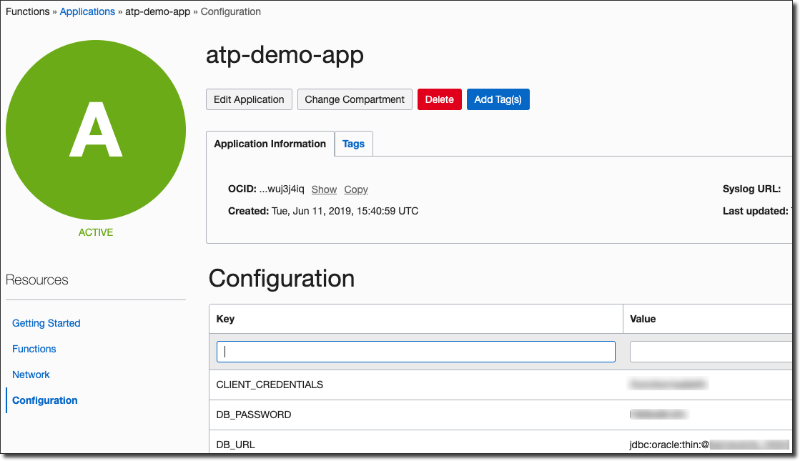

Next, create some config variables for your application that will contain the necessary credentials for the database connection:
Note: You should always encrypt any configuration variables that contain sensitive information. Check my guide to using Key Management in OCI to learn how!
Verify the configuration was set via the console UI:

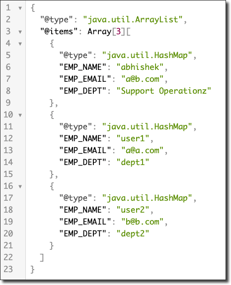

We can now query the database like so:
And now when we invoke the function, we'll see a nice JSON array of employees:

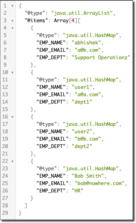

Of course, we can also take advantage of passing data into the function. Take another function in this application that defines an Employee POJO like so:
We can persist new employees by slightly modifying the previous function:
To invoke the insert function we pass a JSON object with the keys corresponding to the Employee POJO:
To confirm the insert, re-invoke the original function and notice the new employee:
