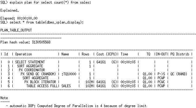

With no DBRM plan and parallel_degree_limit set to CPU I get a DOP of 4 because of the parallel degree limit in my system.

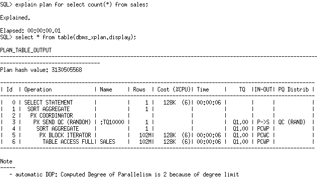

With a plan that limits the DOP to 2 for OTHER_GROUPS which my username is mapped to I get a DOP of 2 because of the plan limit.
BEGIN
dbms_resource_manager.create_pending_area;
DBMS_RESOURCE_MANAGER.create_plan('plan1','plan1');
dbms_resource_manager.create_plan_directive(plan=>'plan1',
group_or_subplan=>'OTHER_GROUPS',comment=>'test',parallel_degree_limit_p1=>2);
DBMS_RESOURCE_MANAGER.VALIDATE_PENDING_AREA();
dbms_resource_manager.submit_pending_area;
END;
alter system set resource_manager_plan='plan1';

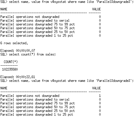

When you run this statement with the plan enabled and look at v$sysstat you will see that "Parallel operations not downgraded" is incremented.

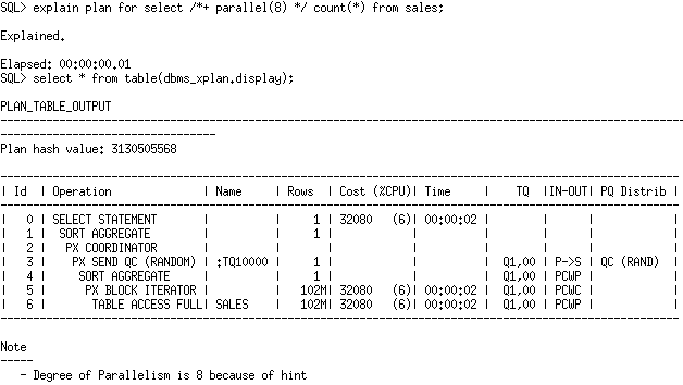

Even if you have Auto DOP enabled in your system or session you can still have statements using manual DOP by using hints. Manual DOP is not integrated with DBRM, so the requested DOP will not be same as the actual DOP if the DOP limit in your plan is less than the DOP in the hint. These statements will show as downgrades in v$sysstat.
Here's the same query with a hint that specifies a specific (manual) DOP.

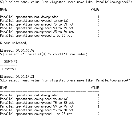

If you run this query you will see that the appropriate downgrade statistic is incremented.
Since the requested DOP was 8 and the actual DOP was 2 I got a 75% downgrade as indicated by the statistics.
